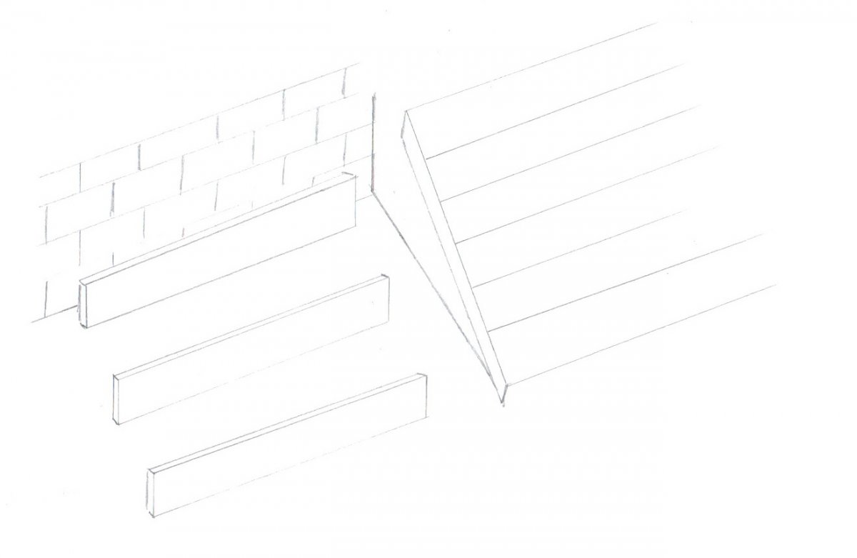

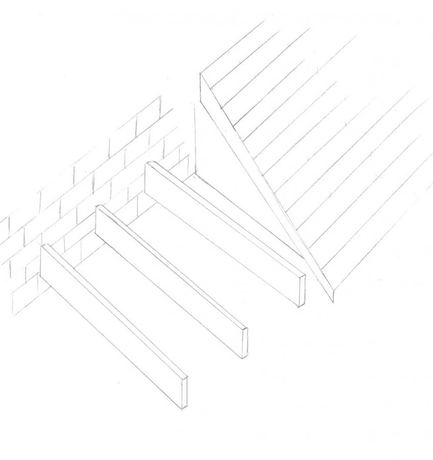

Please see the pictures attached, they are not to scale as i've drafted them on paper and pencil but they give a good idea of what i'm saying...
The first image is how I hoped the joists would run but they don't, they run horizontal across the extension like the 2nd picture. I have issues there regards ventilation should I need to do a cold roof but we'll come to that later if needed.
