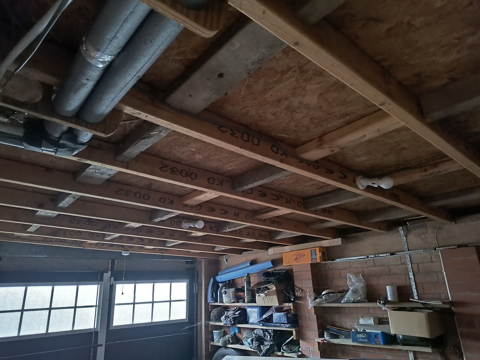

My garage has 9mm OSB at 450 centres. Bit springy on the odd occasion my 17 stone walks on it but that's all.

Why, how often are you going for walkabouts on the roof and CDBE joists could be spanning further or just under sized

I am saying that CDBE could be experiencing bounce because the joists are under sized for the span they are being used for or the span is to long for the size of joists, which basically is the same thing.
