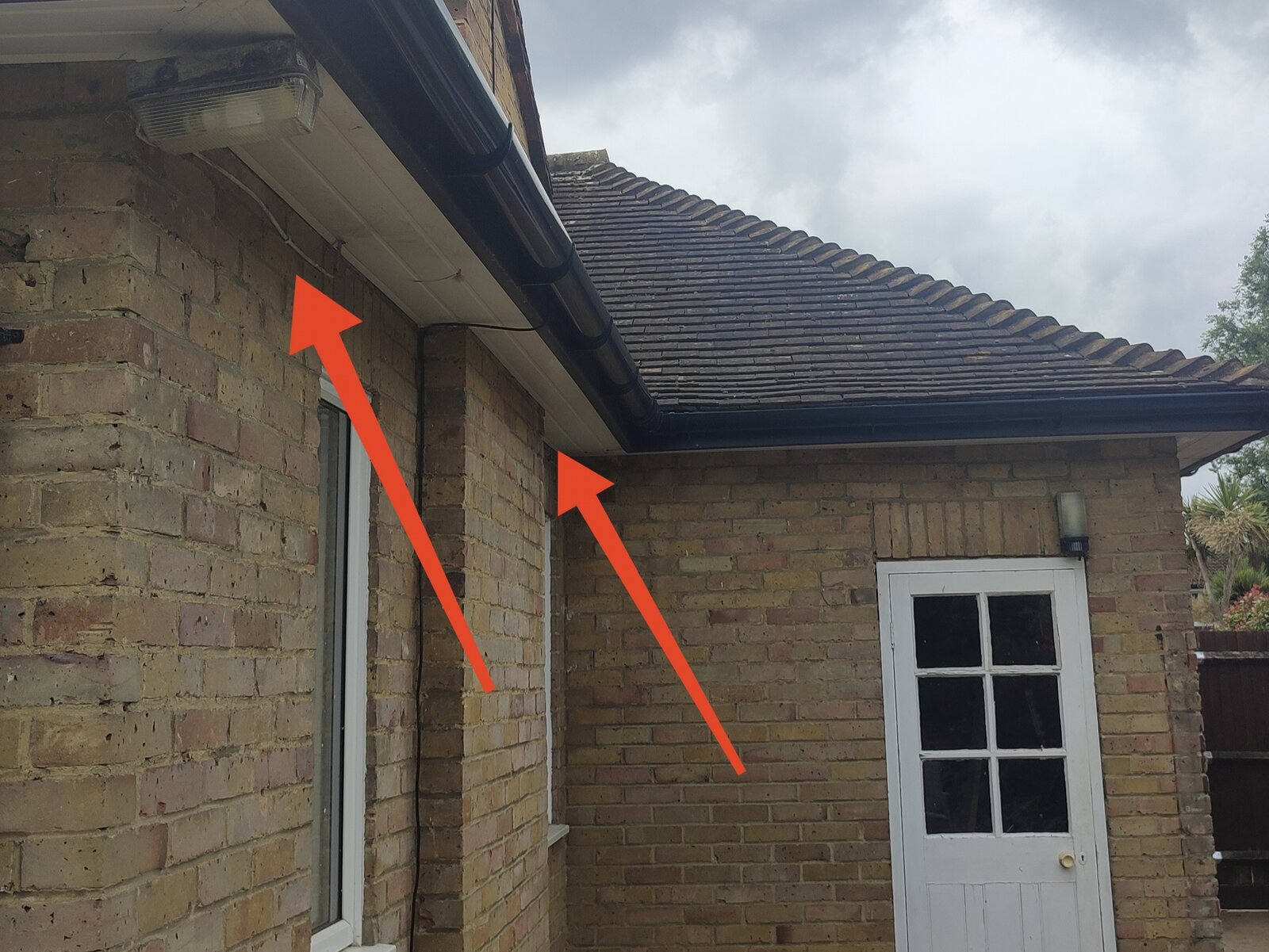

Hi Guys,
My flat roof on the extension will be starting under the soffit/fascia of the existing roof. Need to go as high as possible because of the ceiling height in the extension.
What is the best way to do this? Should I remove the gutter completely? Or just do it under the soffit?
Any advice is greatly appreciated
Under? Are you lowering the floor too? Or are your upstairs existing ceilings really high? Seems like a really bad detail. Ordinarily the wall plates would be at the same height, i.e. the flattie would hit the pitched, several courses of tiles up the roof.
You will need to remove the lower roof tiles, membrane, battens, soffit, gutter etc. Then as you build up the flat roof, fix OSB in place of the fascia and possibly a lay board up the rake of the roof also.

Thank you, I was going to lower the floor.
Do you, by chance, have a detail for the flat roof to pitched room transition?
