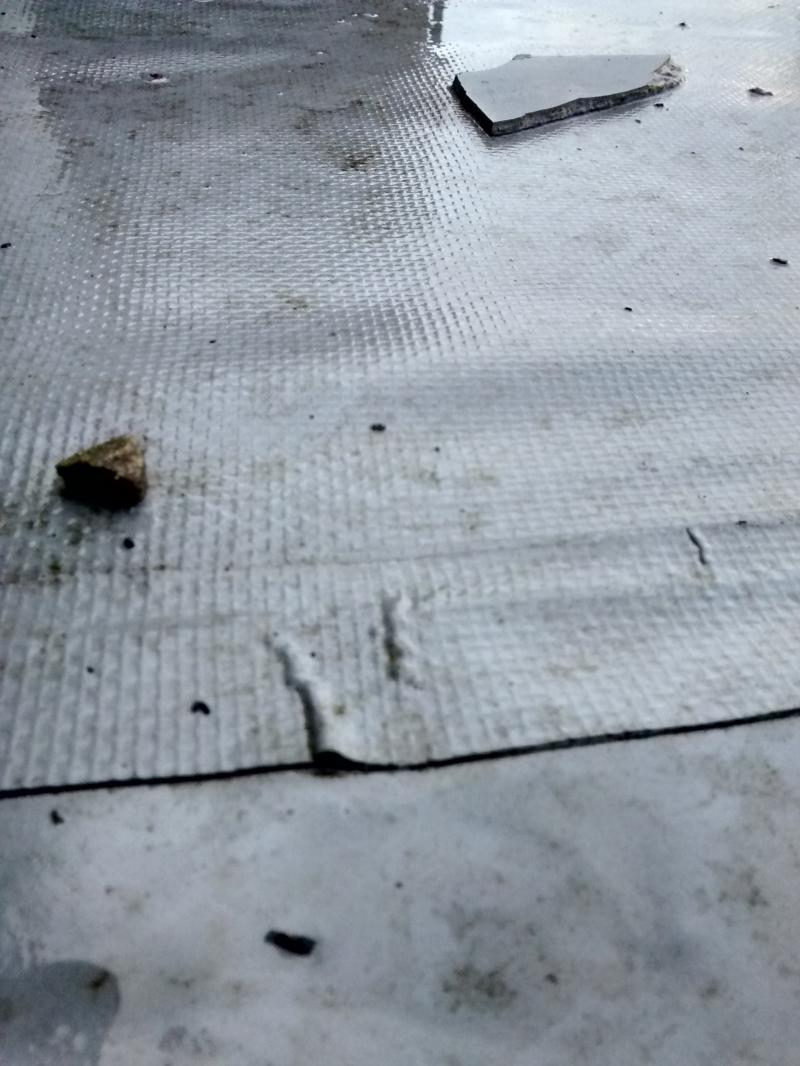

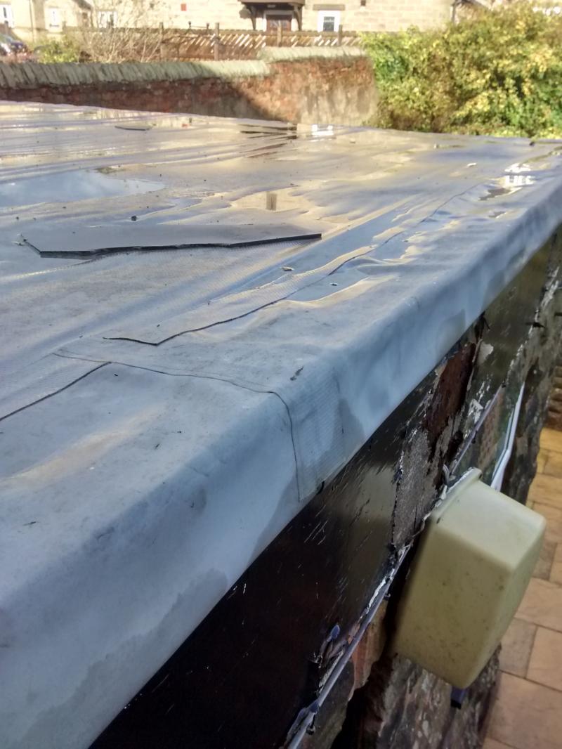

Hi. I was hoping someone maybe able to advise.
I have included two images of a flat roof membrane that I may need to undertake a repair upon. The job is the replacement of the fascia boards around a stone built extension. However, I have concerns that the flat roof membrane may be damaged during the process of removing the fascia boards.
I am unsure what type of membrane the flat roof is covered with. I believe it to be a single ply membrane, but of which manufacturer I am unsure.
I was wondering, if it is possible to undertake repairs to this type of membrane, particularly splicing in new edge trims should the original edge details become damaged.
If it is possible to undertake repairs and identification of the membrane already in use is impossible, can you advise on a compatible membrane that may be used to create new edge details?
Any advise or links to other individuals who can advise would be greatly appreciated.
Yeah, Aero version
Thanks for the replies. So, is this single ply still available to purchase. And if so, where from and how do you make repairs or splice into it. eg form new edge trims.
If not available, is there any products which are compatible
Thanks again
You could try edpm self adhesive tape the other stuff as far as I know is only available commercially.
