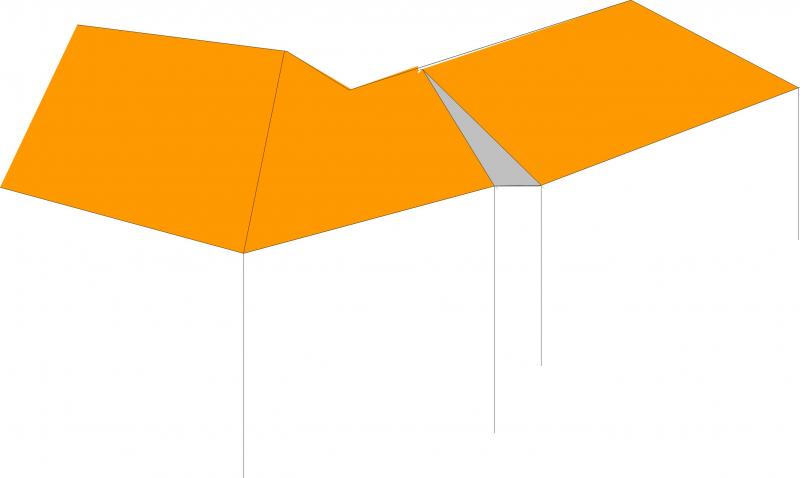

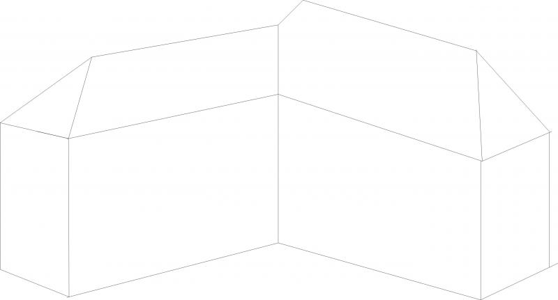

I have done a couple of quick drawing of my propsed plan
The apex height of the new roof would be ~ 1.70 m and the angle of the roof about 38 deg. Does that sound OK.
As you can see from the drawings I would not be able to run into the height of the main house roof ridge, due to the center line of the new extension being too far off the end of the ridge of the main house which runs north to south on the main plan drawing.
The other two drawings show isometric elevations. On one side a vale would be needed, on the other due to the old and new roof being at different angles I assume lead flasshing on the vetical face
