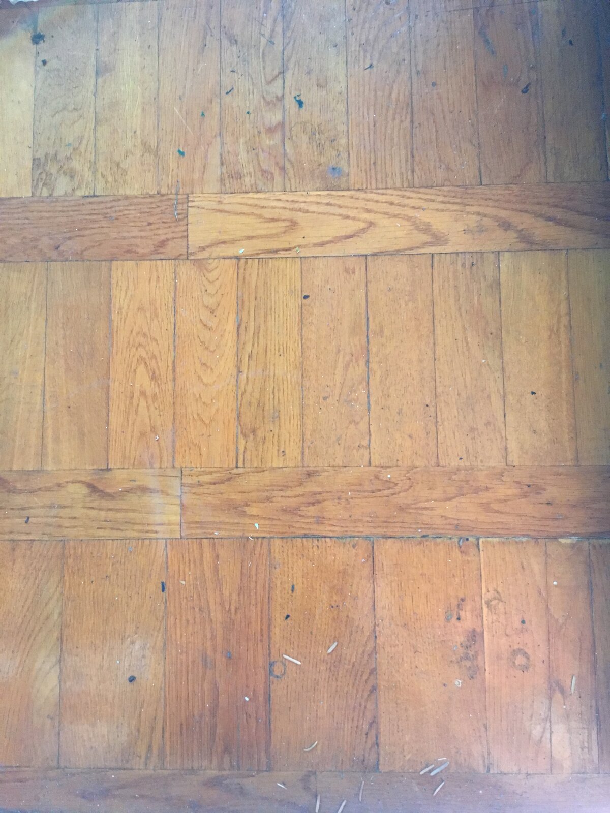

I'd like to repurpose an old kitchen top as a table top. It was made by my girlfriend’s carpenter grandfather so has sentimental value.
Unfortunately, it's bowed (convex) a little, which I'd like to have made flat. It seems to be constructed from a pine plank base and bonded with (I suspect) a thickish oak veneer of about 5mm thickness, in a parquet fashion. See photo.
Could anyone give me some advice/options on how this could be achieved? I would presume that machines that thin/level wood would be non starters here because of the mixed grain directions? So hand planning would be the only way to go? Or perhaps not?
I’m not sure my current work area nor my experience/tool availability will be up for the task either. So if anyone could give me a ballpark figure a carpenter would expect for this task, I’d appreciate it. The table top itself is about 250mm x 700mm.
Any advice much appreciated.

How thick is the parquet and how high is the crowning? True parquet is normally fairly thick (15 to 30mm) and can be machined flat successfully. If on the other had the timber is marquetry thickness (5mm or less) then that option is out.
If it is of machinable thickness then I'd possibly follow TigerCubRider's suggestion of building a router sled and using that (note that the larger the diameter of cutter the better - a 1/2in router with a 50mm diameter cutter is the way I'd go), following up with a random orbit sander - attempting this freehand with a power planer is not going to work (not to mention risking damage) and attacking it with a 4in belt sander will almost certainly result in badly dubbed over edges.
Even for an experienced woodworker this is probably not a task for hand planing due to the changing directions of grain.
There is one alternative, though, if the top layer is thick enough - take the item to a larger joinery shop where they have a wide belt sander and get them to face off the top for you. This a fairly straight forward task with the right gear, which can remove as little as 0.1mm per pass, although it may cost you £30 or so to get the job done as they will need to set the piece up on a base.

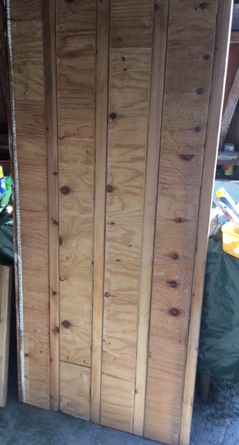

Thanks again for all the advice everyone. Going by what @JobAndKnock says, the parquet is only marquetry thickness as it is 5mm. The planking it's attached to seems an unusual choice to me, but there you go.
Given this I would presume that attempting to bend the board back into shape is the best way to go. It's been suggested that routing out some thin grooves length ways underneath might make this easier. Would anyone here confirm if that's the case? Due to the planking I'm considering if this useful as the rough rounded edge planking is effectively doing this already? See the attached photos.
After that, sticking (or screwing?) some supporting material to the underside would then bend things back to a flatter shape, which would then allow the top to be sanded down true. What type of material would people suggest for bonding to the underneath?

Something sturdy to attach to the underside. Think Angle iron! If you're making it into a table top you could possibly incorporate the design of the legs to to include the steel box section/ angle iron that would easily pull it straight
+1 for angle iron, provided you can get a good enough screw bite in the pine.
When you lay the top flat how high is the convex in comparison to the edges?
I'm thinking, if the top of the convex is 5mm higher and the parquet is only 4 -5mm thick you are going to be sailing close to the wind with planing/sanding the bump out.
What about dampening the whole top then laying on a flat surface weighted down with heavy books/blocks? After it has dried out, (hopefully flat enough for you), you can then flip it over and fit cross bearers to the underside to help try to stabilise it.
