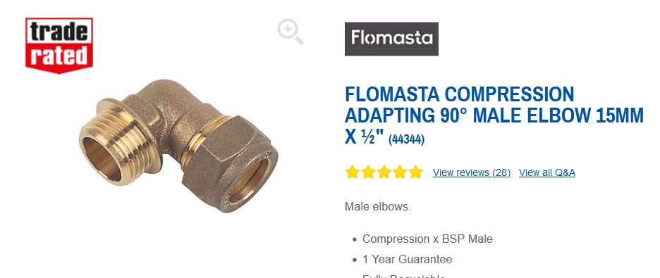

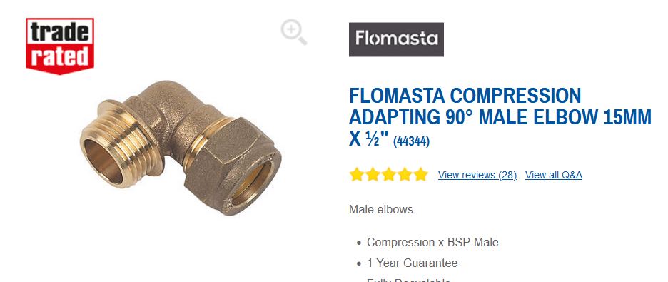

I have a flexible hose that is fitted under a sink that doesn't comfortably reach the brass fitting it connects to. Is there an elbow connector that I can fit to extend the current pipe/connector slightly to allow for a more comfortable connection? Obviously, I could get a longer flexible hose but adding an elbow to the main pipe would actually be easier. Need male to female elbow of the correct size for standard tap flexi hose. What type is that?
Yes, I think that would probably work. I assume for the right side end I can take the screw on part off and attach the flexi hose?
The left side end would attach to where the flexi hose is attached now.
Is the fitting size correct for a standard flexi hose for household taps?

Ok, thanks - so, do I need both parts? I can see how the adaptor would allow me to fit the flexi hose but not how I would then connect to the pipe work.
Is there another/easier option for extending the flexi hose or joint to allow a more comfortable fit? The elbow was just one option really.
The connector goes into the elbow like a pipe would, using the compression fitting.
Then you screw the flexi on the connector.
https://www.screwfix.com/p/flomasta-compression-adapting-90-male-elbow-15mm-x/44344
