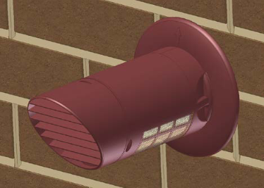

I core holed out for an extract fan in the only place I could knowing it would be tight to the inside corner of my utility room, my plan was to open the hole up on the right hand side and use a flexible duct. I had to do this as there is a cast soil stack outside, do you think I will be able to do it this way thanks for any help.
Sounds ok from the limited info - why do you ask? What are you concerned about?
Just worried if the flexible adapter will offset enough cheers .

Hi the vent is for an extractor fan that the building inspector wants fitting as this room used to be my old kitchen and is part of the old footprint of the house & I’ve put an extension on the back of the house with a new kitchen which is totally separate to this room which I’m having as a utility room.

Extractor duct is like soil pipe, so you can use elbows to work round corners.
The rigid duct is much more durable, and cleaner as it does not trap dust and fluff, and you can give it a slight slope so any condensation runs outside.
I can't visualise why your layout is a problem, can you draw a sketch?
