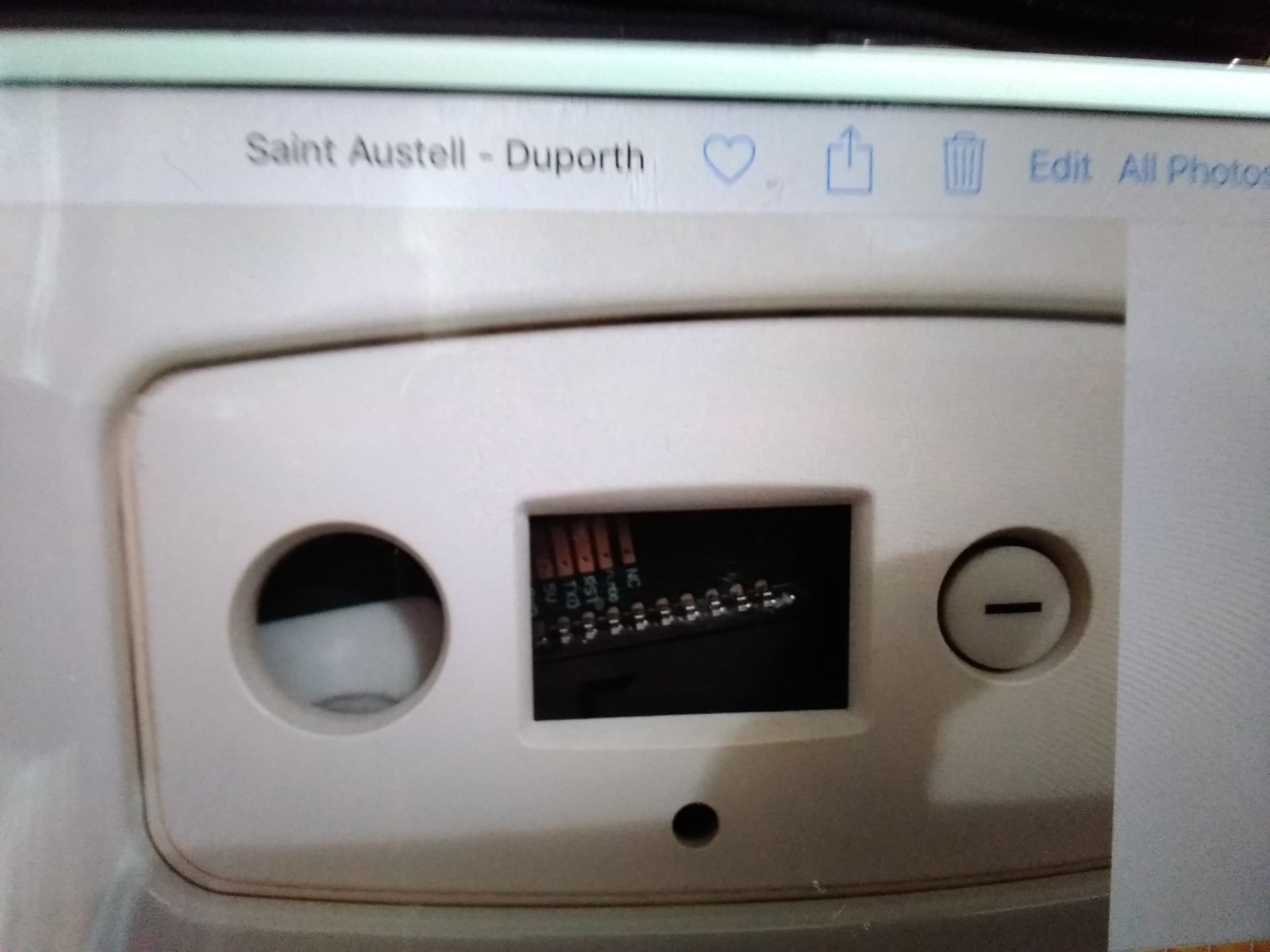

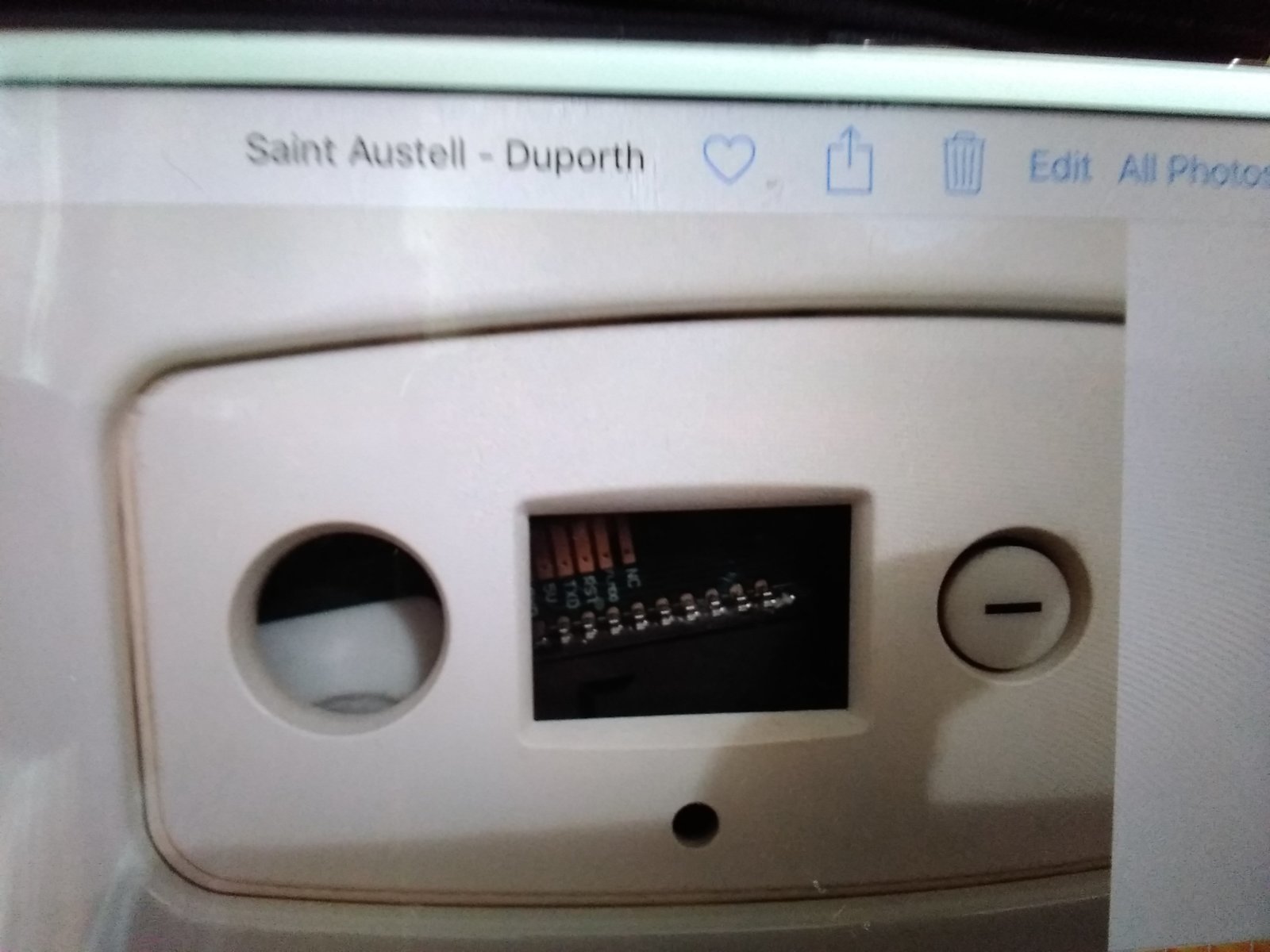

Has anyone see this before can some one tell me is this the hinges broken by heat Bryn

Tbh I think you should have started your own thread, however that looks like the display has fallen into the boiler - get it seen to ASAP.
