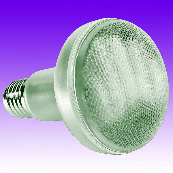

You should get some CFLs (Energy Saving Lamps). Apart from saving you money on electricity, they last for years and are tolerant of supply voltage fluctuations.
con1_uk said:
Do they sell energy saving spots? I wouldnt mind them if they did.
What sort of spots do you have?
This type
This type
