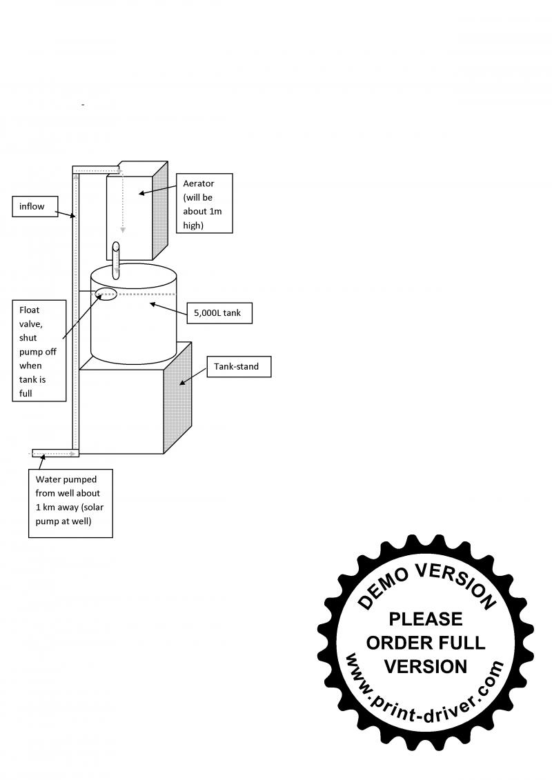

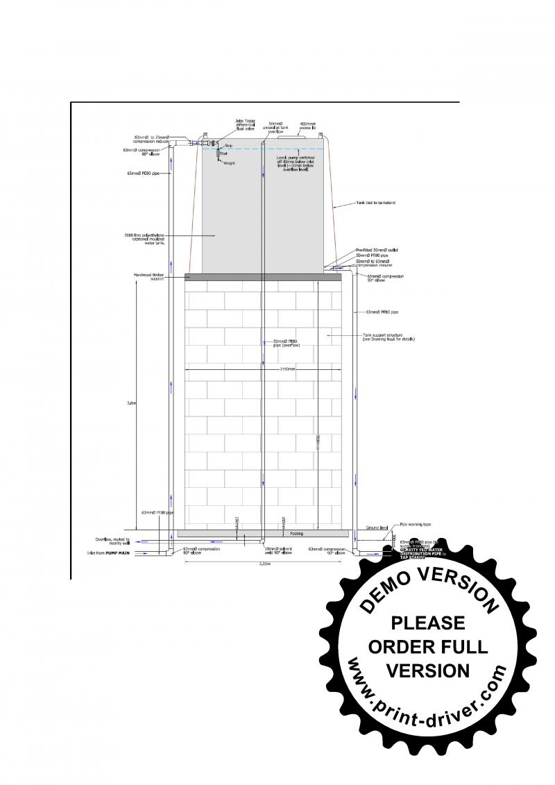

Thanks people for your thoughts. I am attaching a drawing of the existing tank set up
and a VERY rough sketch of the proposed set-up
The aerator will just be a small tank or similar, with water being sprayed into it and being splashed as much as possible (eg off washboard-type arrangements) so as to release the H2S which is entrained as a gas in the water (it is naturally occurring in this instance due to vegetation that is grown near the well).

There's still the question of stopping the pump by shutting its outlet off - certainly most electric pumps wouldn't like this, so you need a pressure sensitive device to shut it off in the delivery line.
At the tank, the float switch or whatever needs to close a valve on the incoming pipe......this would be reasonably achievable using a power source I think but bloomin' difficult without one.

Thanks Burnerman - I know nothing about pumps and I thought that floats simply cut off the outlet - or actually I did not think about it at all . I am still somewhat confused - the set-up we have in place currently (see drawings above) works. :confused:
I was hoping that I would not have to make a call between having power and wasting water!!!
The system you have so far is fine - nothing wrong with that.
One question though, at the moment when the tank is full, what happens to the excess water......does it just splash over the side to waste?
A float switch could be fitted to the side of the tank, but there's nothing to control there....even if a valve was installed in the pipe from aerator to tank, then there would just be an overflow at the top of the aerator.
So - if you want to avoid wasting water, somehow the pump has to be switched off or surplus water diverted away.
Points to ponder!
