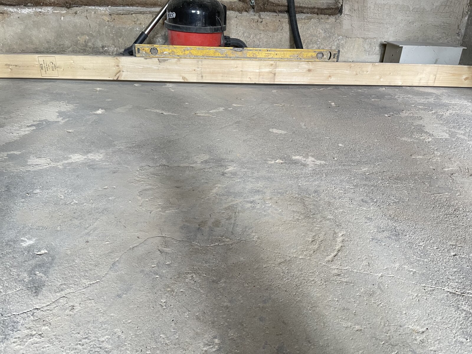

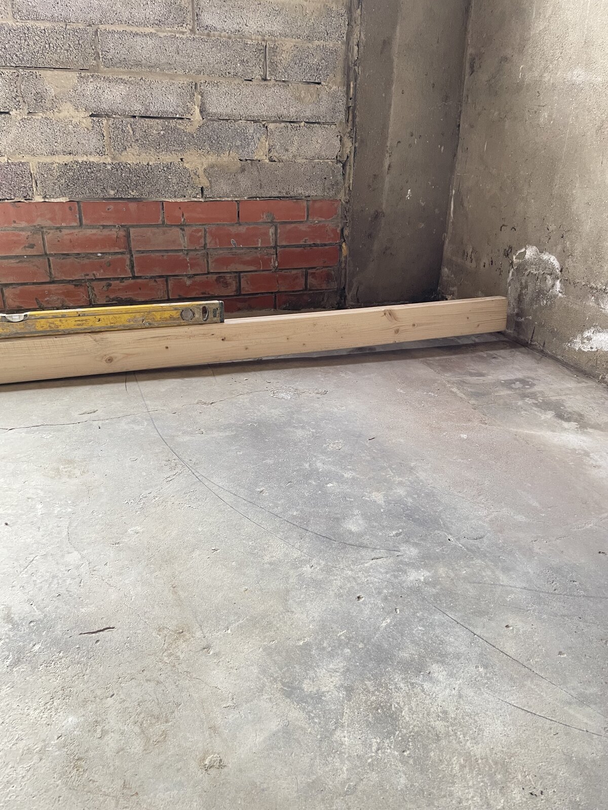

I cleaned up my garage floor and wanted to lay down 100mm PIR insulation, TG chipboard... It is a concrete base floor at the moment with dips. See picture attached.
I have read to put KILN dried sand on the areas....
Any suggestions?
You should use a liquid floor levelling screed. Sand could work but I think it would be a bit of a nightmare. Usually sand is to level beneath a concrete slab which will hold it in place... one knock from the insulation during installation and the sand won't be level anymore.

Thanks. i didnt want to use screed but i will have to then seems simpler and will make it easier in the long run

I’ve done it with sand (building sand not kiln dried) and it worked fine. Use a long straight edge to get it bang on. It’s not going to go anywhere once the floorboards are on and glued together on top of the PIR.
