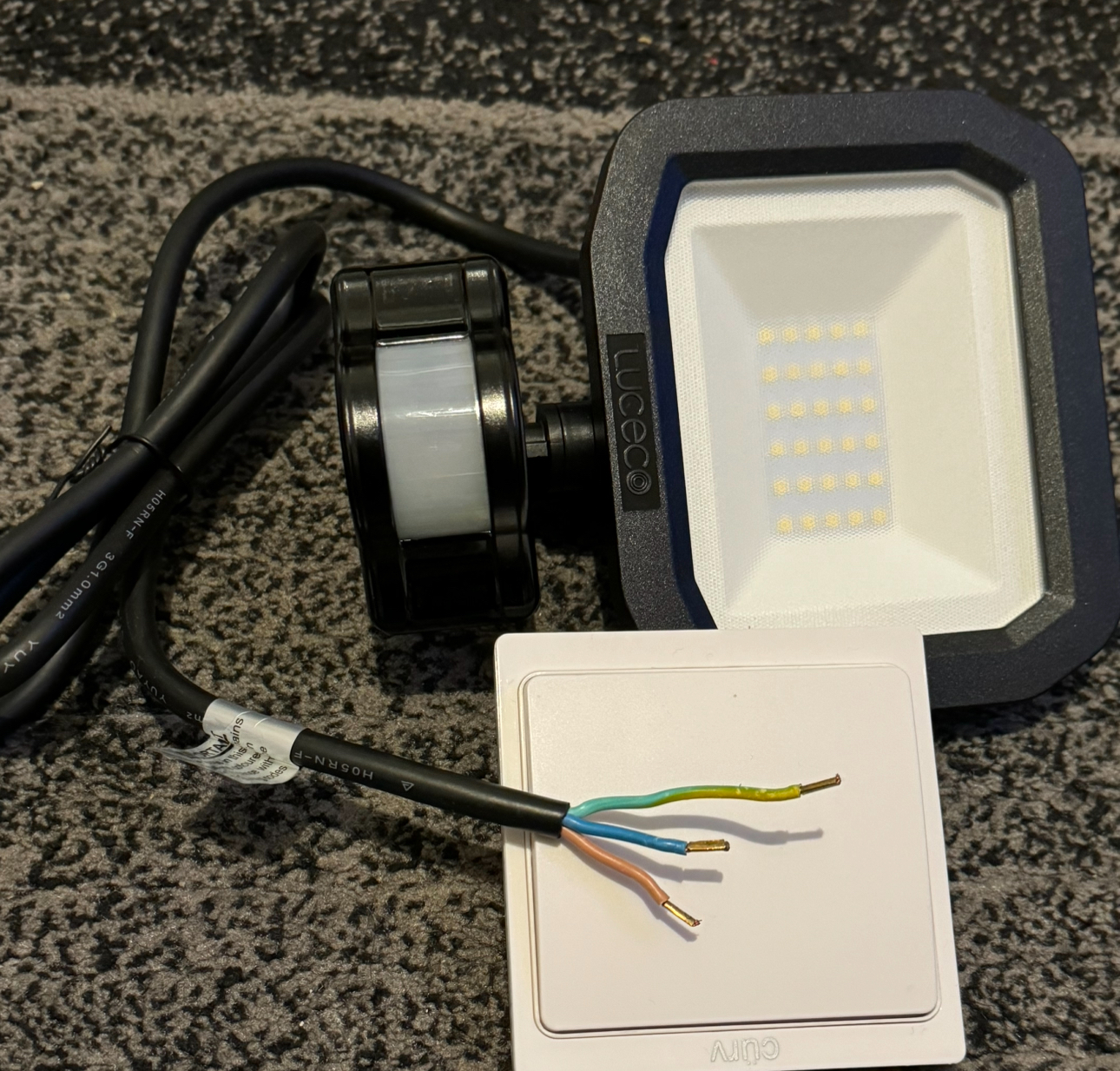

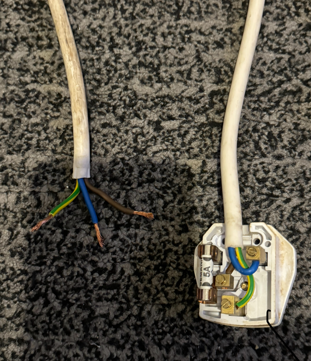

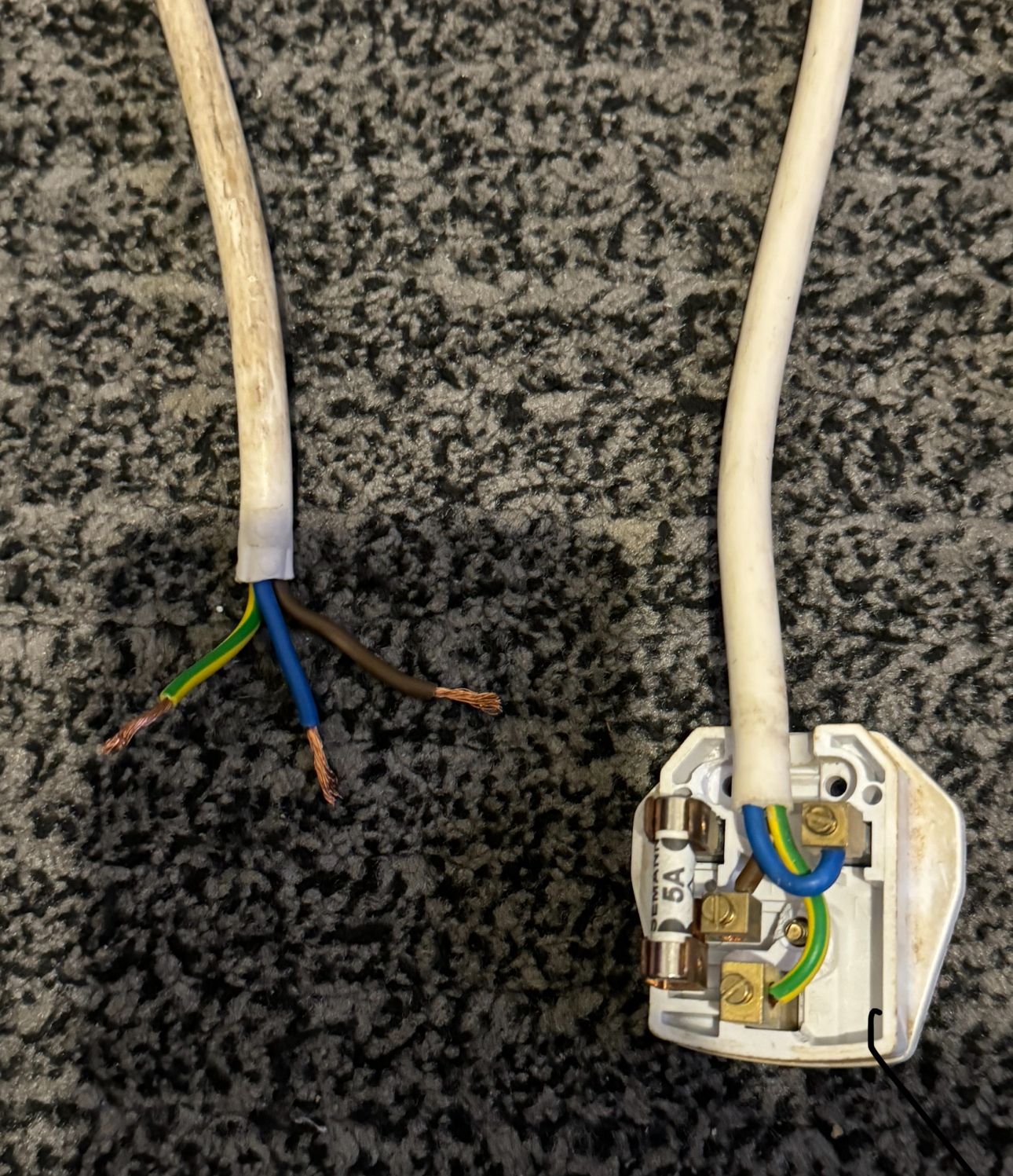

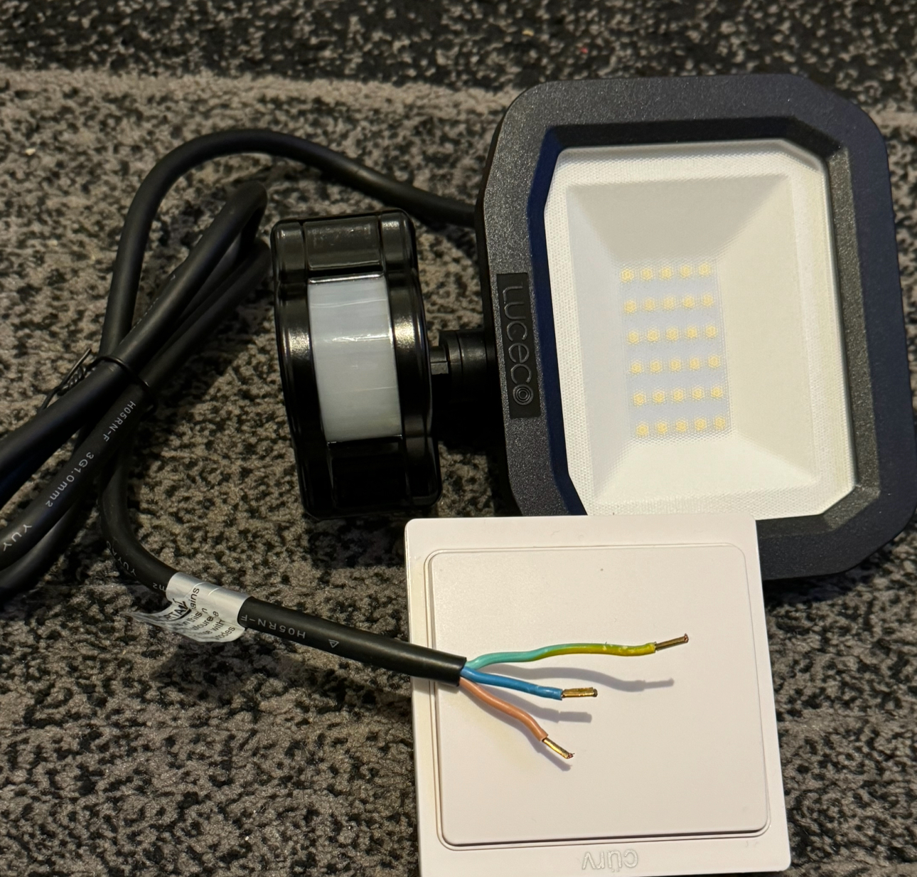

Hi all,
I was able to test the light with a plug and 5amp fuse.

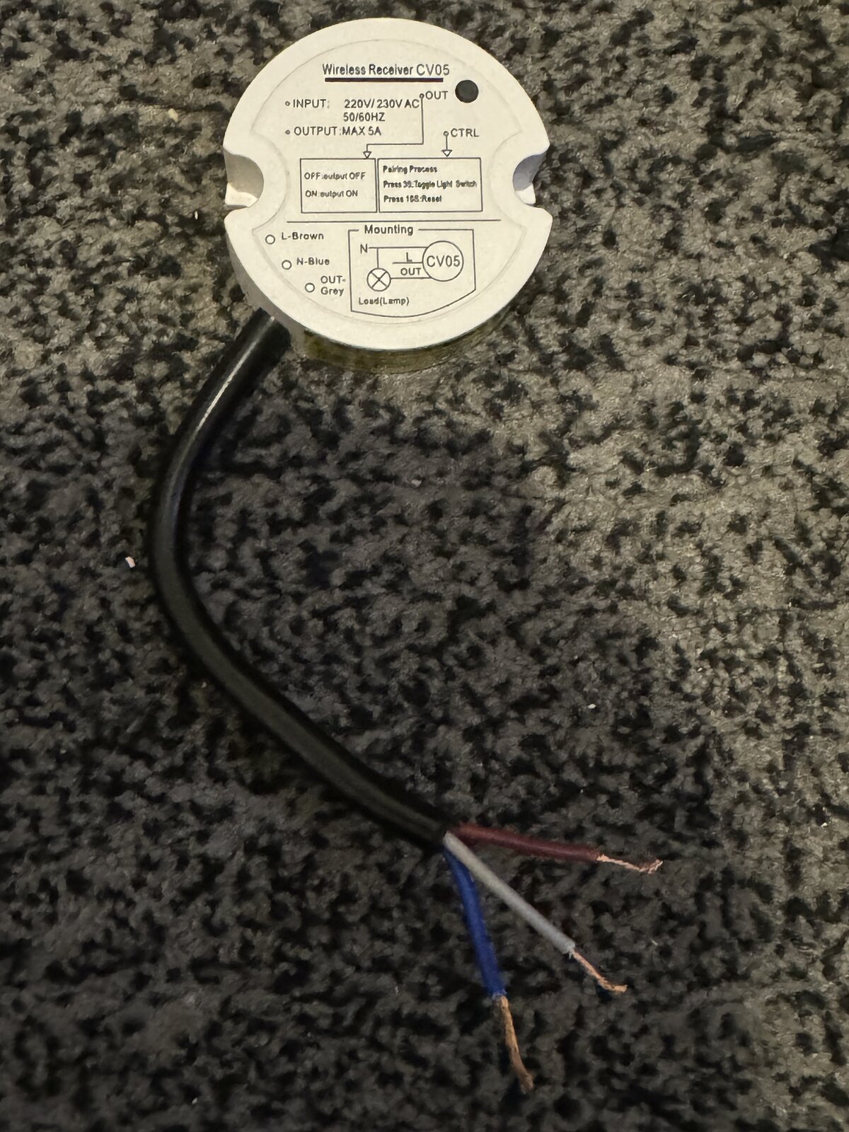

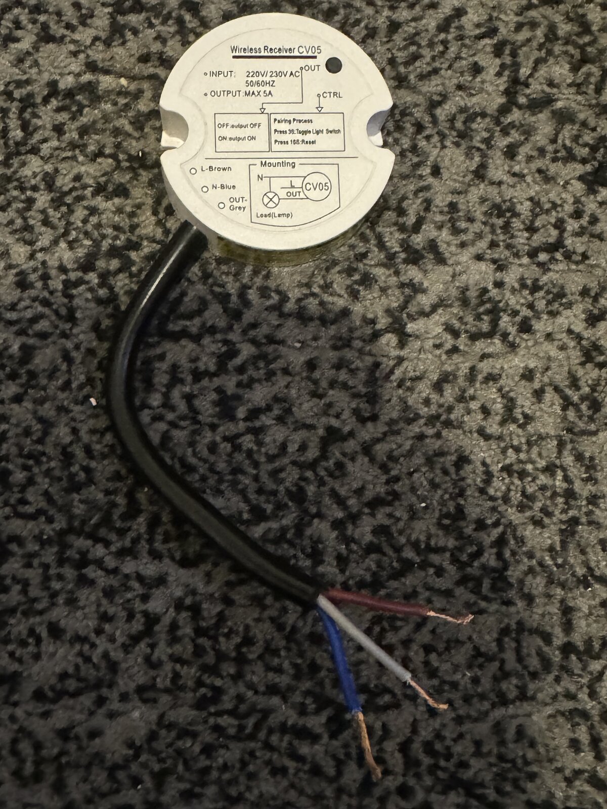

I came across a kinetic switch and receiver I bought years back that I didn’t end up using. Was wondering if could test this switch and receiver on the flood light?
If so would all the 3 neutrals go in one wago, 2 earths in one wago and the remaining 3 browns and the grey wire in the last wago?
