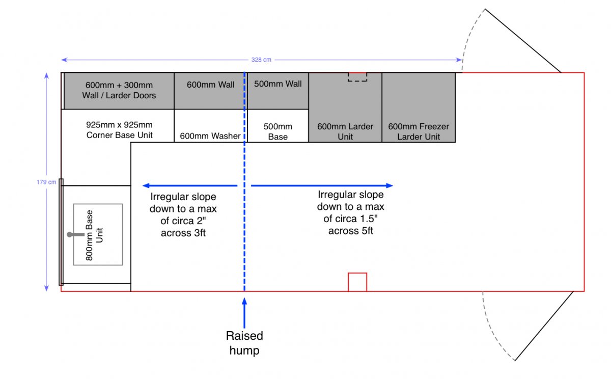

So now I called in yesterday to see the newly tiled floor - and as I expected the floor is out - but hugely out. I didn't need a laser level to see it has a hump in the middle of the room - and the floor slopes down more than 2" over 3 feet and is uneven all across. It's - well - a bloody mess.
They already bought the units to fit into the room a few months ago. They were to go all along two walls and cross every uneven part of the floor. There is a freestanding washing machine that was going to go in under the worktop - but even if I used this as the datum point I will need to make up for some considerable measurements either side over a very short distance.

Hi - yes they have adjustable legs - the usual B&Q fair. I would need to go from the washer as that has to fit under the worktop. You can clearly see / feel the hump in the floor and the slope either side of it. If it is possible to get the units in the kick plate is going to need some serious work to fit - this will no doubt be highly visible. Still - at the moment the choices are no units or units bodged in somehow.
I've included a plan of the room below. The hump in the floor is approximately where the 500mm base cabinet & washer meet - and slopes over 2" down toward the sink / window in under 3 ft. I'll try to get some more detailed measurements tomorrow.
Screed under where the units/washer/fridge will stand, so they have a level standing area. Make bespoke kick boards and forget about it. If they don't like it then they'll have to have the floor up.
I'm imagining that you mean because of the hump that the washer will stand on you will have to lift the base units that high just to get the washer underneath the worktops that the kick boards won't be tall enough either side, if that's the case and seeing as they'll need scribing into the floor anyway then just use a taller kick board and be done with it, if it looks cack then its their problem, you won't see it from your house!
OK I've had a closer look today. I might have a solution...
The main problem being there is a raised hump in the tiling - almost as if he was following some trajectory - then decided to follow another! I've enclosed an updated plan below. The fall either side of this hump is initially quite steep - and reduces across the distances shown below.
Now - I have checked the quantity of tiles - and it would appear there are around 4m² of tiles more than is required to complete the job - way more than I originally thought. So I had an idea to just remove the tiles which form the acute part of the hump - perhaps 2m² at the most. I may then have to remove some quarries below to take the floor level sufficiently down before re-tiling. Would levelling compound be suitable or should I look toward some form of screed? I don't know what thickness we would be talking though until I get the tiles up...
