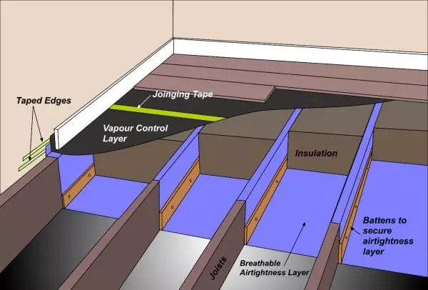

Planning to insulate suspended ground floor, inspired from threads here.
Basically add some netting, whack in loft insulation, dont encapsulate cables, job done, time for a beer.
Read this article https://www.eco-home-essentials.co.uk/underfloor-insulation.html
Says loft insulation (non hygroscopic) is bad. Needs a vcl and breathable membrane. Etc.
Obviously this complicates things and increases the cost significantly.
Thoughts? Is the article full of sh1t and an ideal?

Just noodling around having a read. This place https://www.permagard.co.uk/advice/installing-vcl-vapour-control-layer says
Do I need Vapour Control Layers for my floor?
In ground floor applications such as concrete slabs and beam and block applications, a VCL is required on the warm side of the insulation. This will also help protect the insulation from wet screed or concrete.
Suspended timber floors are slightly different. There are differing opinions around whether to introduce a VCL or not, and where to place it. If the VCL is not installed properly, it can create more issues with condensation.
In an ideal scenario, the VCL would be placed to the top side of the joists before boards are laid. The insulation would be below this, meaning that the VCL is on the warm side of the insulation. This would then stop warm, moist air from entering the structural element
So to stop warm moist house air condensing. Makes sense.
