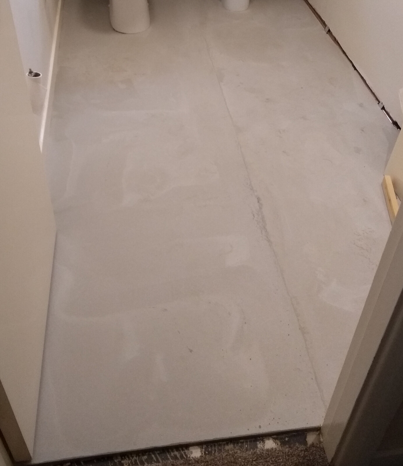

I'm refitting a bathroom for my parents. I was originally going to use Ardex NA to level the concrete floor. But when I've taken up carpet and old floor tiles and had a spirit level on it, the floor turns out to be a bit of a mess of sections/levels/slopes, and much worse than it originally looked. It looks as if the "concrete floor" is large pre-cast sections like giant paving slabs its so uneven.

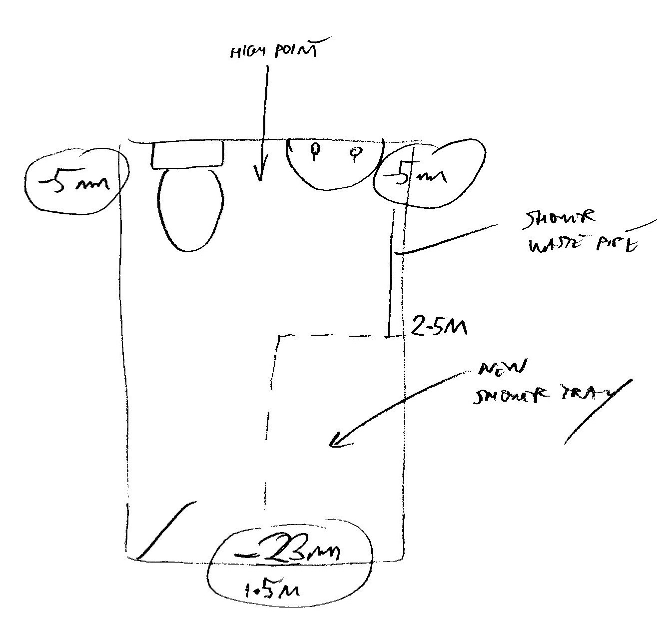

See diagram below.
As you can see, the most significant slope is a reasonably linear one down towards the door from the high point, and the drop in height is around -23mm over the length of the bathroom - which is about 2.5M, and 1.5m wide.
I'm after suggestions from those of you who might have done something like this on what combination of levelling compound type/brand and approach is best for a job like this. I've never done a level to this sort of depth before.
Obviously, I'd like to do this in one pour if possible but I'm thinking the slope direction, bed depth and constraints below are going to make that a little difficult and I can afford to take a bit of time to get it right.
So, my current thinking is to put a batton up the middle of the bathroom floor and level the shower/sink side close to its full depth in one pour as there will be no foot traffic at the deep end, the sink end ought to set fast enough sloping from the high point to -5mm deep, and I've got full reach to trowel the compound out if necessary without wading in it. When that side is set solid, do the loo side in two or three stages. Then do a final thin level across both if needed.

The new shower tray is a raised/cast one and must be on a level surface + the waste pipe has to go along the right hand wall. i.e. I have little option but to try and sort the levelling issue out so the waste pipe slopes in the right direction!

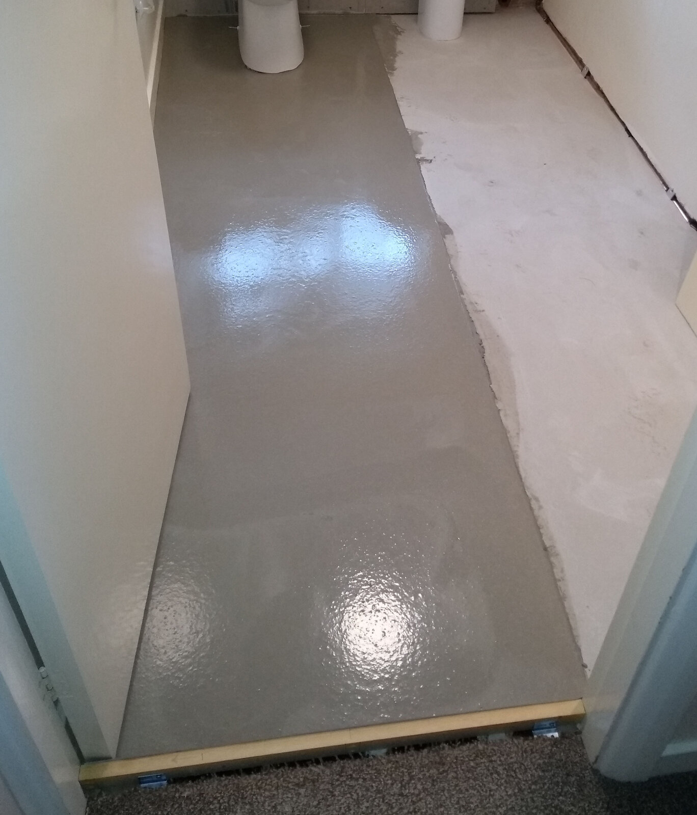

Just an update on this posting if it helps anyone else working with similar issues/contraints. I decided to go with priming using BAL Prime APD, then BAL Level Max leveller on the basis that I've been using BAL products over the years and not had any problems, and this stuff seemed to be rated by the trade in spite of it being a bit more expensive than some. I actually found it pretty good to use, and would be happy to use it again. It was set pretty well at three hours even given the depth.

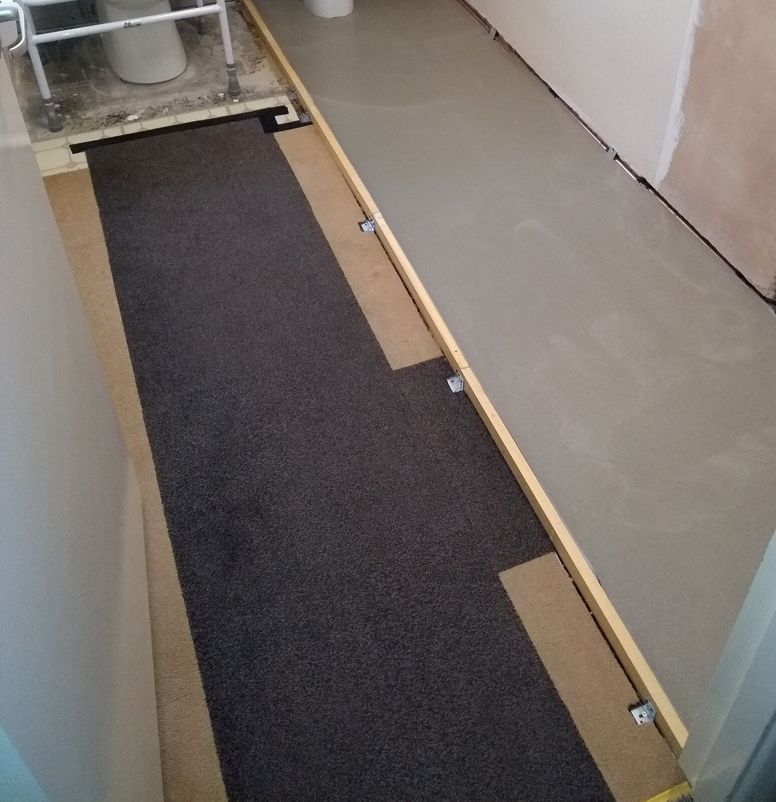

I ended up doing this in two halves which was far from ideal but it seemed the best way with me working on my own and not knowing how the leveller was going to behave and set. The result was pretty good considering, but I'm mulling over doing a very thin layer on top just to get it spot on, as I have some imperfections in it as a result of delays as I mixed up the next bag (my fault, not the product).
With the benefit of hindsight, I would do this differently. My concern that the slope was steep enough for me to end up paddling in it before I managed to trowel it out was justified when I saw how each half flowed. However, I have since found out that you can get strap on foot plates for your boots which have 25mm spikes and allow you to walk in freshly poured levelling compound without disturbing it too much. Assuming these work well, I could have done a pour across the entire floor, in two stages and saved myself some effort.
I also wouldn't attempt this on my own again. If you need more than one bag of leveller at each stage as I did, you really need someone to be mixing the next as you're pouring the first.
For the batten, I actually used short sections so I could follow the imperfections in the floor, and put duct tape on the leveller side so they would come away from the leveller easily. So didn't need to silicone the battens down.

Thanks. On the left hand side, I just spent far too long mixing the second tub (it needed two per side) and when I added that to what was already down, that had started to skin over so they didn't mix together that well. It's too tempting to try and trowel it and that didn't help. So there are a couple of patches where it hasn't levelled properly that's all, probably not helped by the fact BAL Level Max is one of those with fibre in. I may be able to skim the affected patches rather then re-level.
I've since found a really good video on YouTube on using BAL Level Max in a similar sized room where they just dump the entire bag into the water and get it mixed really quickly and that's what I should have done.
