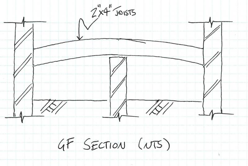

I am trying everything I can to use good timber and reduce contact with wet masonry. So I was thinking of using joist hangers, rather than re-using the brick pockets. Is there a recommended way to retrofit hangers without a wall plate?
I can chase out the mortar and put hangers in, but don't want to cause structural instability with a new hole in the mortar every 400 mm on each wall...is that likely to be a problem? I have a bay window, with walls at about 45 degrees. What should I do with joists on the angled walls?
Finally: the floor span is halved by a sleeper wall, that has unfortunately settled less than the rest of the house. The result is a cambered floor at the moment. I can knock a course off the wall, but am not sure how to level the new joists to get it right. Maybe roof tiles on a wall plate (with DPM!)?

It's a bit of a pain if you only need to replace one or two joists: getting a camber to match. I did this in our living room, and ended up cutting the joists in half, and scabbing together with coach bolts. I 'softened' the crown in the centre with a planer, then used large plywood sheets to curve over the centreline. There's a little bit of a step difference between the old and new, but not much. I used a thick plastic DPM to even out the difference. Not ideal, but it saved doing the whole floor.

I suspect that no settlement has taken place but the joist tails in the wall pockets have rotted and dropped leaving the flooring over the knee wall slightly high, hence, the camber.
Do you intend to replace all your joists?
Using a line level, why not take a level string line across the room from wall to wall, just graze the top of the knee wall and see where you are level at either wall?
If required, the top course could be removed from the knee wall and a wall plate on a DPC fixed down. The treated joists would meet on the treated wall plate.
Cap the ends of the joist tails in DPC material and set the joists in existing pockets in the brickwork. Cut new pockets if req'd (even in the bay) and roughly brick up any unused pockets.
Your FFL must flow into any adjoining room thresholds.

Unfortunately settlement did occur, as I checked the levels in the adjoining room late last year. I was thinking along the same lines wrt wall plate and pockets. Means I will have to cut each joist in half and scab together, but there we go. My colleague tells me there is known to be an underlying layer of peat in the area etc etc, and we are on softish alluvium anyway.

I don't know for certain that settlement has occurred, but the image below shows what I encountered in the living room last year, and I am 95% sure we will have the same in the adjoining dining room.
The difference in level is about 30 mm. The house was built in 1936, on alluvium, and the whole area flooded in 1945ish. The settlement could have occurred in the last 78 years. I suppose there's the alternative possibility of uplift on the dwarf wall, but this seems less likely to me.

In theory, if your joist is dropping 30mm at each end then each end wall is dropping 30mm but not the knee wall in the middle - could be but seems odd.
Just noticed the 2" x 4" joists; that section's way too light, which suggests non-original joisting but past repair work/joist replacement.
Have you actually crawled the sub-area and probed all the joist tails?
Do any window or door heads show signs of dropping to one side - are there any internal or external cracks?

The joists are indeed small, but that's the largest that will fit in the brick pockets, so I assume they are original. A few had been replaced as far as I can tell, though they rotted quickest. 2x4s just about work to serv. limit using the TRADA tables---it's only twin 1.8 m spans.
I've crawled below, but not probed all the joists. The ones in the bay window have failed (the floor is bouncy and has sunk 20 mm). Visual inspection, from a distance, shows all the joists to be damp at brick bearings.
The severe wet rot in the adjoining room started at the bay window and reduced in severity into the centre of the room. I am expecting a similar trend in the dining room. Next door replaced their joists maybe 10 years ago and tell us our joist ends were a bit dodgy (where they join at a party wall).
There are a few fine cracks in the plaster over lintels and beams. Generally from the ends towards the centre and upwards. There are some cracks dotted here and there, but nothing severe. There are quite a few upstairs in the lathe-plaster ceiling, but I thought that was common. Not surprised that some movement has occurred over 78 yrs!
I agree it seems odd, but I struggle to accept that they constructed it this way with joist camber purposely retained. And I am not so convinced by uplift. I don't think any settlement is recent, so I'm not too concerned.
