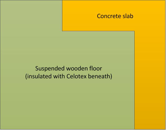

In the kitchen I have a mixture of floorboards and a concrete section (which I guess originally had the boiler, cooker and sink on) - see attached. If I put marine ply across both surfaces and tile on top of that, that should be ok? The concrete section might be a blessing as that is where most of the appliances are going including the washing machine...
Ply, securely fixed and at least 18mm, is an acceptable substrate for tiling.

Just one more quick question... I should also put a membrane down beneath the ply and above the concrete, correct?
Wouldn't hurt. Where is the top of the concrete slab in relation to the top of the joists, and how are you intending to fix the ply to it?

There are quarry tiles on top of the slab and this is roughly flush to the boards. I was going to knock off the tiles and use a self-levelling compound to make it perfectly level between the two areas and then ply on top of that.
That sounds reasonable. How big is the concrete slab?

If you look at it like an L-shape, on the long sides it is about 2/3 meters and about 0.7m deep.
If it's that large, I'd be inclined to screw and plug the plywood onto it, but I've not actually done that, so you'd be better taking advice from someone who has. Again, try searching the forum.
