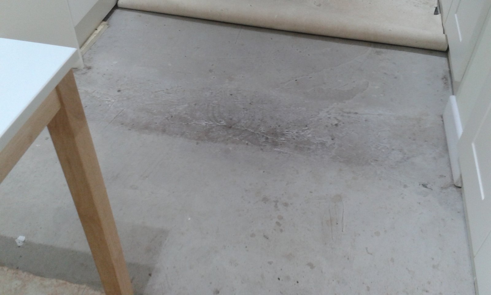

Floor tiling across kitchen concrete floor ext join. I understand there can be different floor movement as one has insulation and membrane and the other nothing. I'm having different advice. 1) Tile across join or 2) tile away from join and seal with flexible filler. So what is best. Thanks Ray

The original kitchen has concrete floor with no insulation or membrane. The kitchen extension floor is also concrete but this has membrane and insulation. Glad you asked for photo as lifted lino and where old wall was is damp or condensation? Whatcan I do there? Will try to download photo.

whats happening at the junction where the kit floor meets the dining room? damp could be coming up at all the edges of the old concete?
how much lower than the floor surface is the ground outside?
its more work but you could open up where the old wall was and show whats happening down there. maybe the damp is rising only in the old wall remaining brickwork with a shallow skim of concrete on top?
if you lay anything on damp itwill come back on you.

Thank you. External level to DPC is fine. We mounted kitchen unit legs on wood to allow for laminate so room for tiles.
It's coming from old wall. It's just a skim over the old dpc cavity (270) wall. Think I have 3 choices: 1) some kind of brush on waterproofer before tiling. 2) remove 1 brick down of old wall - piece of dpc sheet across and up sides then cover with concrete - If I went for that option how long before we can tile over it (say 3" of concrete)? Option 3 - dpc sheet then laminate. Your thoughts please.
Decoupling mat, ditra for example.
And the correct flexible adhesive.
My father in law put them down so probably didn't do such a good job. He tiled straight into the concrete.
