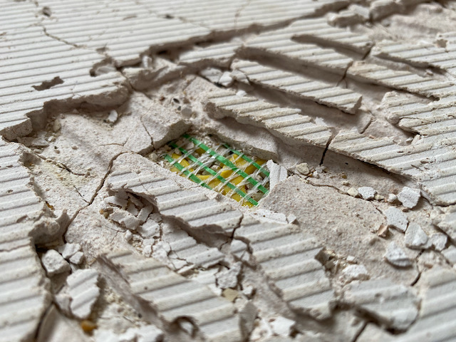

I've uploaded some photos :
- The first shows the kitchen floor where the tiler has been scraped away some of the screed to take a sample (which he is trying to get analysed, but unsuccessfully at the moment)
- the second shows the hall floor. You can see the yellow Ditra matting that was used in the hall.
- the third shows to the underside of a tile from the kitchen floor with all the adhesive still stuck to it.

Just looked at the picture again with the mat... looks like two layers of adhesive... unless it’s my eyes.
Large notched layer, then the top layer is fine notched trowel... if correct was the original adhesive not removed?
The photo with the matt is of the hall with the wooden floor. I think what you're seeing is adhesive spread on the floor, and another layer of adhesive spread on the underside of the tiles. The two layers of adhesive have bonded, but the tile has not bonded.
