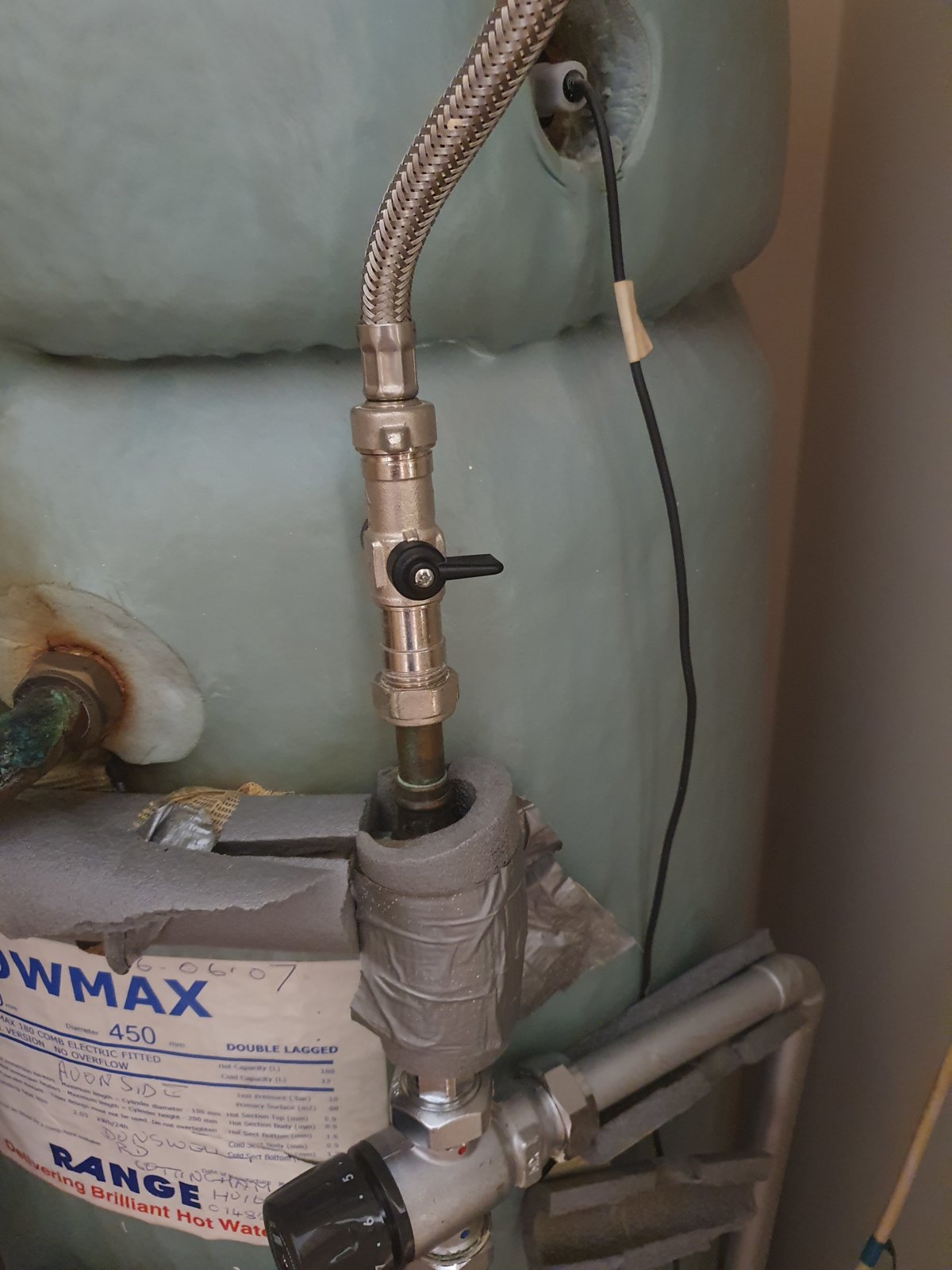

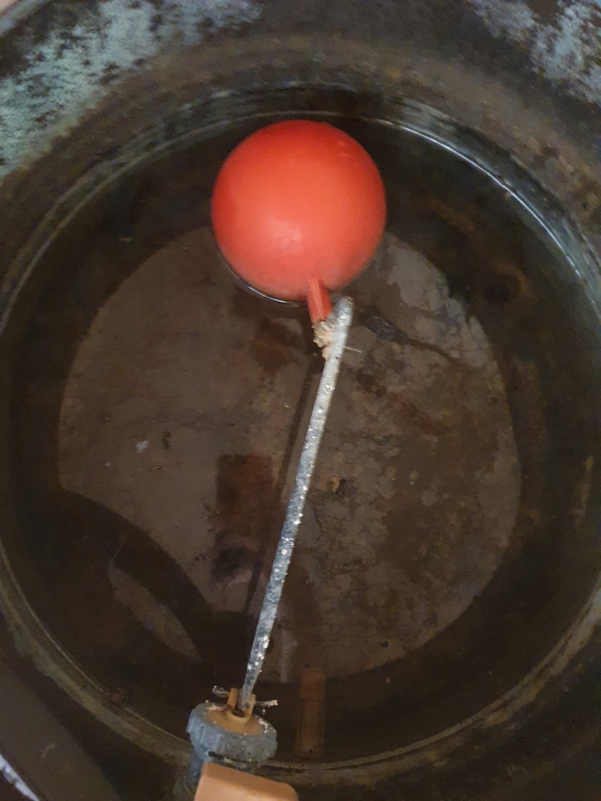

I have a flowmax 180 manual fill water heater in a rental property and was wondering how often i should fill the water tank on top of the heater. It has a water tap and a ball cock on it , should i leave the tap open or just top it up and how often. Not seen one of these before so just wanted to be sure what to do.

It should be self filling with no input from you , the ball cock will drop when the water level drops and turn on the water supply and the ball cock will turn off the water supply once the water level reaches near the top.
Any chance of a couple of pics of the ballcock and water tap to check this is the case as I am unsure what you mean by water tap

Hi sircerebus666
heres a couple of pics, so the valve is left open all the time and it automatically fills when it gets low.
I was just worried that if the ballcock fails there is no overflow for the water.

I can understand why you are worried
When the system was installed it should have been fitted with an overflow pipe unsure as to why it hasnt been (are there no holes in the feed and expansion tank to show one used to be installed?)
There's nothing wrong with you fitting your own overflow it's not particularly difficult , the only issue is you might struggle to get a seal on your curved tank.
Until you get one fitted I would turn off the water when you go out and change the ballcock for a new one as that one looks fairly old
thanks for the advice i will change ballcock after all this craziness ends and get an overflow fitted if it hasnt got one
