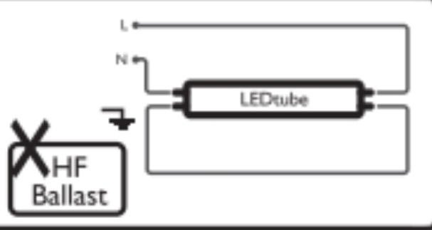

One of our old 58W tubes in the kitchen has died so good time to go to LED
im wanting to remove the ballasts and connect direct to mains, its only a single tube light with a Kengo MB58 Ballast
Ive ordered this tube: https://www.lighting.philips.co.uk/...epro-ledtube-em-mains/929003022502_EU/product
Which I believe is single sided so I have to rewire to one side only? (from the videos and posts ive read anyway)
But on the install diagram it shows when removing the ballast its wired in on both sides
so which one shall I do?
There was another post on here (https://www.diynot.com/diy/threads/how-to-remove-ballast-from-led-tube-fitting.469390/) which has a similar setup as mine, and the person just connected the cables going into the ballast together?
Should I be checkign for shunted and non shunted tomb stones as well?
Having recently replaced one myself, I believe that they are single ended, but the second end has a short between the two pins.
This also allows the lamp to work in an un-modified lamp holder (with only the starter swapped).
In your case, removing starter and ballast, you can connect the wires that are most convenient *

It is best to follow the manufacturers wiring diagram:
This will allow the tube to operate correctly no matter which way around the tube is inserted. It is possible to wire Live and Neutral directly to one end only, but the tube must always be inserted the correct way. Incorrect insertion may cause damage to the tube!

Thanks! sounds good. Awaiting for the tube to arrive now :)

Basic is you short out ballast so it does nothing and fit supplied fuse instead of starter. Basic both ends in series, so does not matter which way around tube goes.

Due to the dead short over the pins on the non-powered side of 'safe' tubes - @2:27:
If the batten has been modified to have L and N on one side, the tube will only work if it is inserted the correct way round (and may be damaged/blow a fuse if inserted incorrectly)
If the wiring follows that recommended by the manufacturer:
The tube will work correctly whichever way it is inserted.
Although, again, as I measured 10 Ohms resistance on the non-powered pins (rather than a dead short), I still guess there may be some protection built in - I will have to get destructive sometime soon! :)

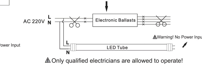

The instructions for my tube say it is ok to connect the power end only (just saying 'Warning! No Power Input' on the other!)
BTW, this is for a '4000lm' tube from TLC, that I find to be more than bright enough! :)
