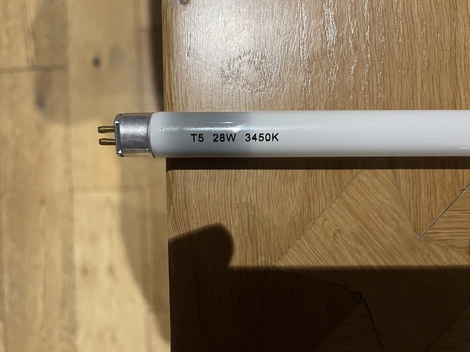

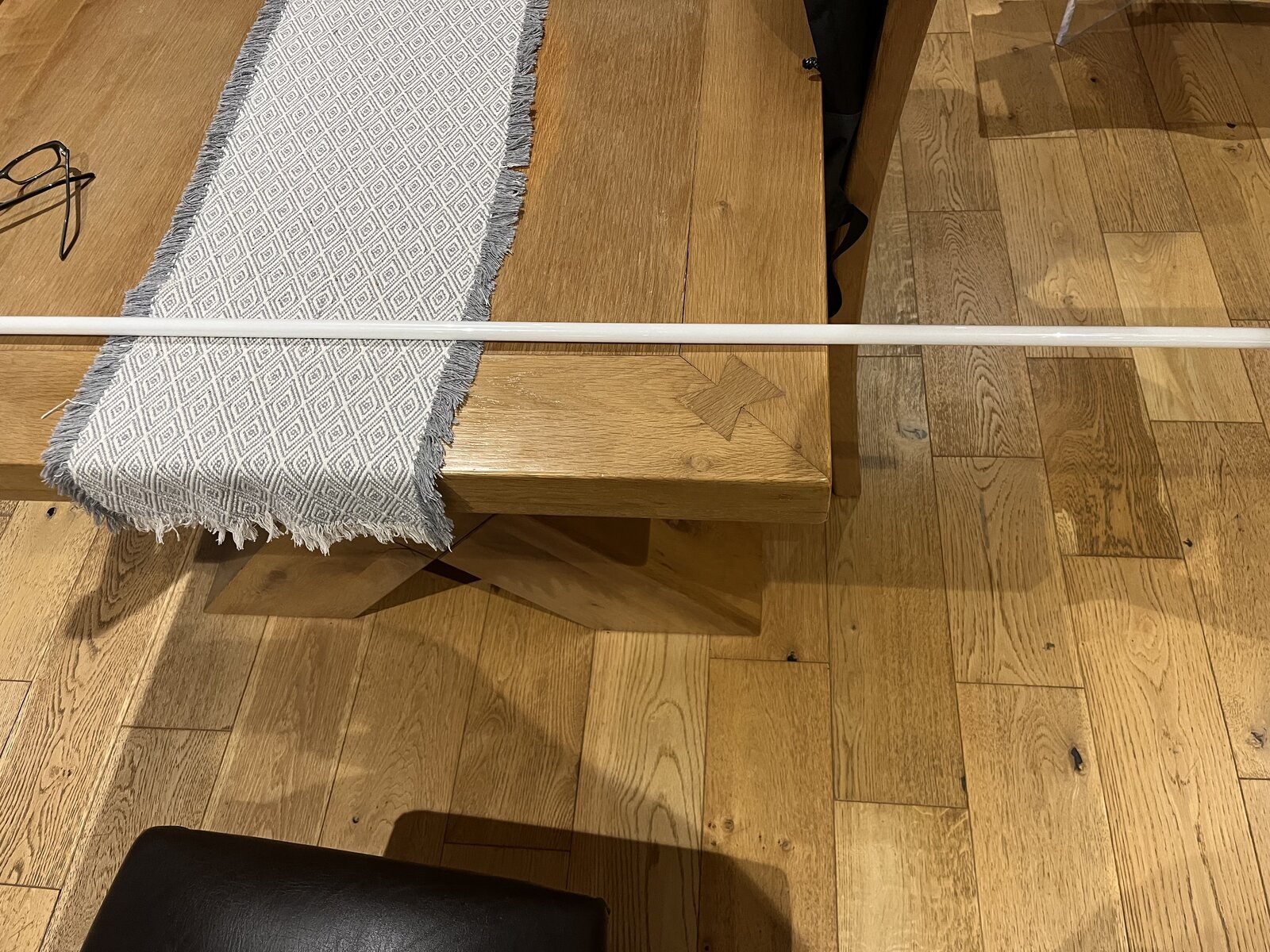

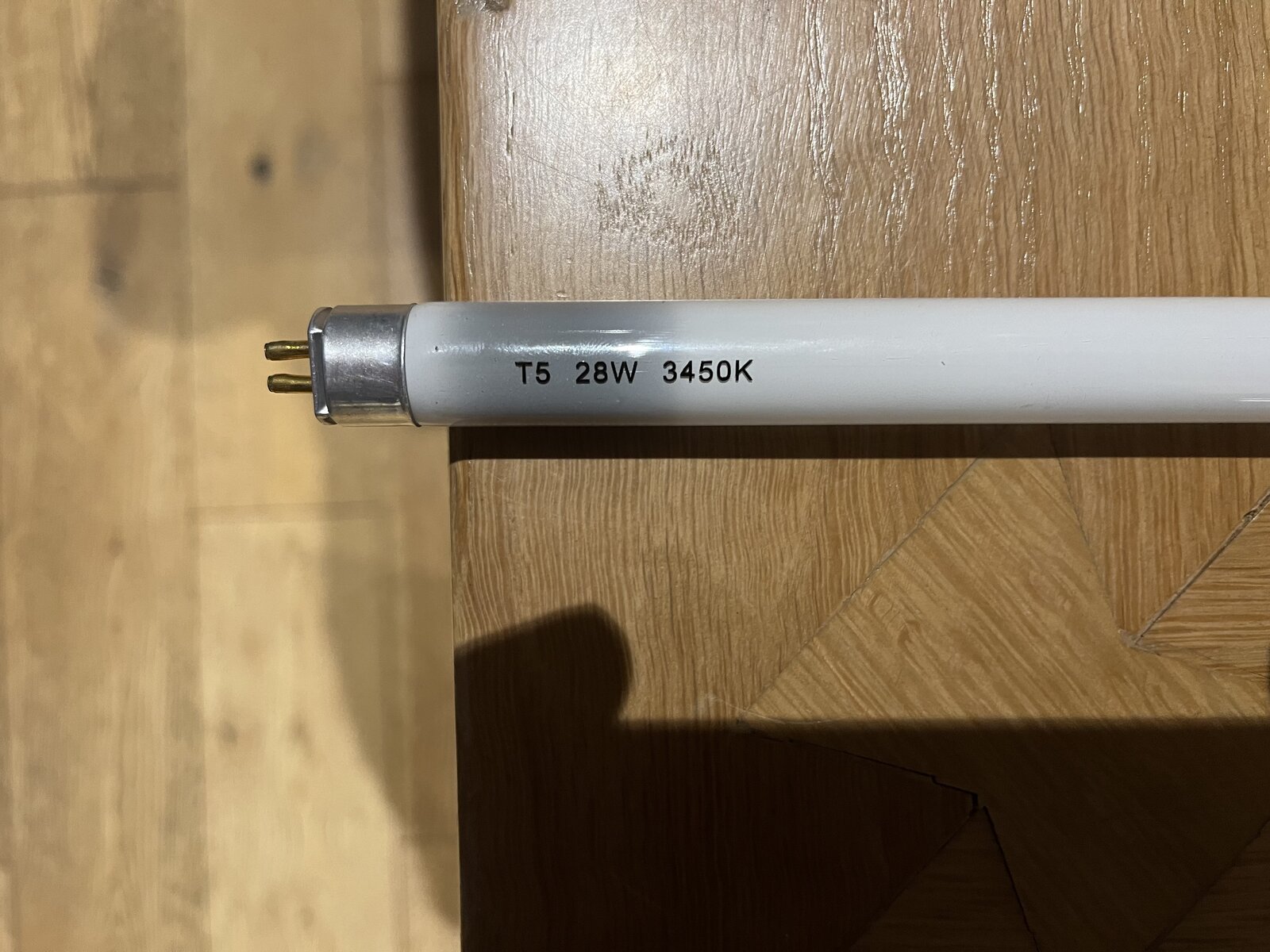

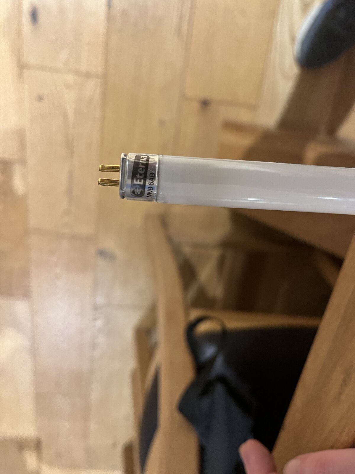

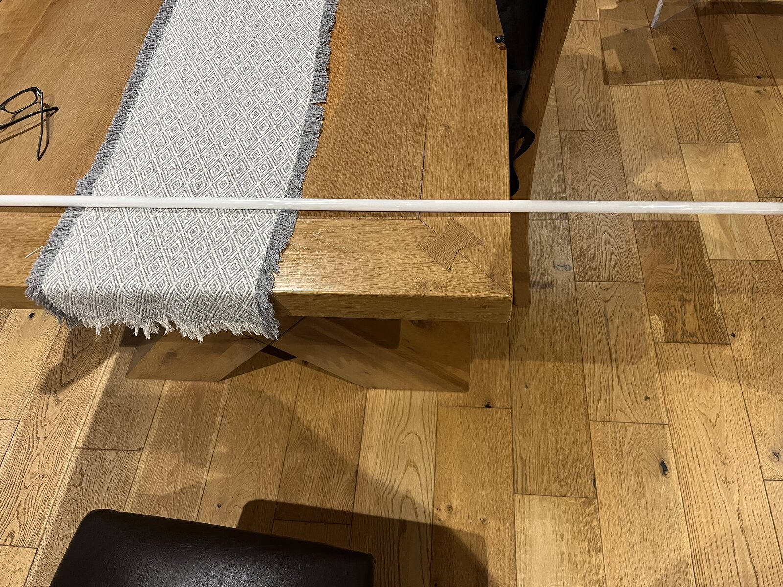

Hello. One of the fluorescent tubes under the kitchen cupboard has given up the ghost so I need to find a replacement. On the tube it says T5 28W 3450K and on the other end it says Eterna NN8 6AB. I’m guessing the Eterna is the manufacturer so I googled it along with what I believe to be the product code (NN8 6AB), but I couldn’t find it. I know absolutely NOTHING about this kind of thing and was wondering if someone could point me in the right direction? Thanks in advance.

It'll be less of a warm white, compared to the existing, but will not be a harsh cold white, you'll probably see the difference if you have a 3000k next to it (would bother some folk, but not others), but if you are changing them all, it'll not make much of a difference
There are two types of fluorescent fitting, either will work with a fluorescent tube, but to work with an LED tube you need to know which type, one type has a starter and a choke which is basic a coil of wire, and the LED tube comes with a replacement for the starter and is a straight replacement, the other type with an electronic ballast and no starter needs a special LED tube, and I will admit I have never tried using one, and don't really know what to look for.
28 watt means 4 foot tube, and they are still offered for sale in Screwfix and the like. Fluorescent tube around 2900 lumen the LED replacement around 2600 lumens so slightly less light, and also lower watts, typically 17 watts.

T5 lamps are a fairly recent thing, were there actually T5 fixtures with wire-wound ballasts and starters? I certainly haven‘t seen any, only T8 and T12.
3450 K is a rather unusual value, warm white is typically 2900 or 3000 K, neutral white is 4000-4500 K and cold white is 6500.
The recent-ish generation of HO and HE long T5 tubes were always intended to be driven with HF ballasts, and I'm guessing theres likely to be reasons why trying to design a fitting that used a magnetic choke t drive them might be difficult ot impracticable.
There were earlier T5 tubes that were usually shorter that could be driven with switch start gear, I'm sure I can remember exit box signs that used an 8w T5 tube, and had switch start gear for maintained mode. And a 28w 2D lamp I beleive is a folded up T5 tube and you could definatly get switch start ones of those
