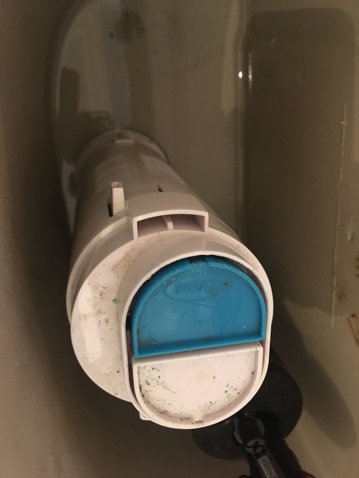

please help me identify this flush!
I think that the fluidmaster pro820uk might be the same but black???
thanks..
Try removing it (bayonet style) and see if any other markings in it.
cant, not at work!!, yes I should have done, but i didn't!, i have seen them around a lot, there is a video on youtube with a million views of someone explaining how to fix the leaking washer on one (these 2 are getting stuck up), i thought my local merchant would know, he usually does!!
weirdly, the fluidmaster one has a strange way it connects, its not a bayonet because you can twist it either way to get it off, it spins 180 deg untill it reaches the point where it pops off, it goes back on with a sort of fudged twisting and pushing action, I had a fiddle at 5;01 in plumbase, much to their annoyance!,.. of course i wish i'd got this one off to see how it connects, but didn't!!
found a few "218" hits with better pics and yes its definately that one, annoyingly it comes in 2 sizes, so will have to do an extra trip. thanks again, trying to invent a push button siphonic flush, one that cant leak into WC, non siphonic modern washer reliant flushes are a massive problem!!
