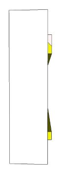

Having only recently suggested this on another thread (...and not being shouted at for it being a terrible idea! ;) ), have you considered a French Cleat?

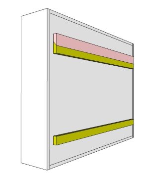

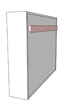

Split battens (French cleat is an American term, surely?) require the back of the wall to be inset by the exact same depth as the thickness of the split batten, or slightly more (1 to 2mm, no more). They also require the wall to be pretty flat, thus:
For clarity I've coloured the component which is fixed to the back of the box pink, and the components which fix to the wall green.

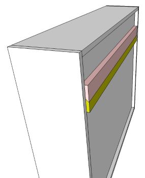

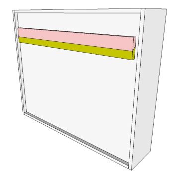

They aren't a terrible idea, but to get a flush fit you do need to inset the back of the item you are installing them onto (which was the issue last time...) not flat on the back of the box as shown above. For larger boxes you may need two split battens (one near the top, one near the bottom) of the same thickness. If using multiple split battens it is essential that the all the battens on the wall are coplanar to get a tight fit:

That will work, albeit not quite as well. Joiners have been using split battens for a very long time because they work, you can make-up your own on site and they are cheap. A big plus of using split battens is that they often don't require any fixings to secure them - the weight of the object causes them to slide down and pull in to the wall.
I detest the metal fixings on PB having had endless problems with them on a couple of builds where the dryliners hadn't installed any timber pattress behind the plasterboard (modular wall system in student accommodation). That made getting them into the right place was difficult as we were forced into using theose drillable PB fixing which never end up quite where you want them, especially as the PB was slightly bowed as well. Eventually we got the designer to do the job properly in a way that could be installed as required. As I stated - they are designed for use on a flat timber or other solid materials not PB. In addition if you want a true flush back with those you still need to inset the back something like 2 to 3mm
