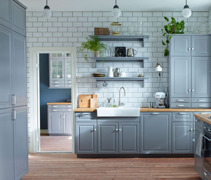

Yes, because water cannot flow uphill. You'll also need to accommodate about half the height of a bottle trap or S-trap (say 50 to 60mm). Bear in mind that it is possible to obtain shallow inset stainless steel sinks, such as these ones but that such sinks are generally regarded as unsuitable for use in solid wood worktops (mainly because of sealing issues, I'd say) whereas undermount sinks are much more common. Another type of sink to consider in your situation would be an "overset" sink such as the IKEA Domsjo. These are mounted on top of a cabinet and actually project slightly above the level of the surrounding worktop:
This means having to consider something like a separate drainer board or a draining cupboard with inbuilt rack over the sink, but it does at least answer your height dilemma
