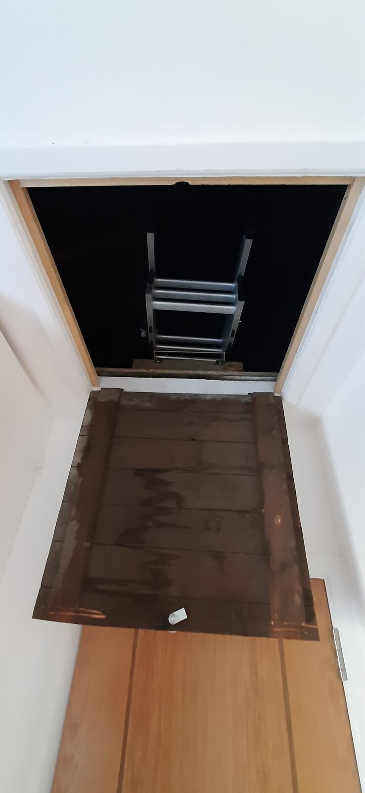

This is the loft hatch in question...

Recently lined my slightly wonky, hinged hatch with Kingspan. I think 50mm. Glued with non-solvent grab
Very similar loft ladder setup

Your loft hatch looks like it could be damp... hopefully it's not?
I didn't notice it being so, but now I'm worried - will check it out, we have insulation between the joists which is the minimum recommended and we recently had the loft boarded but the boards were laid directly onto the joists instead of on risers...
