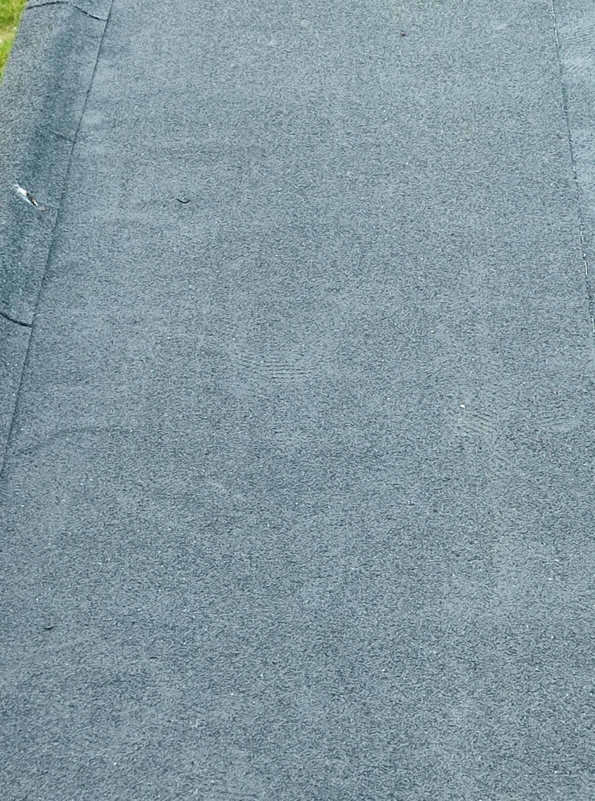

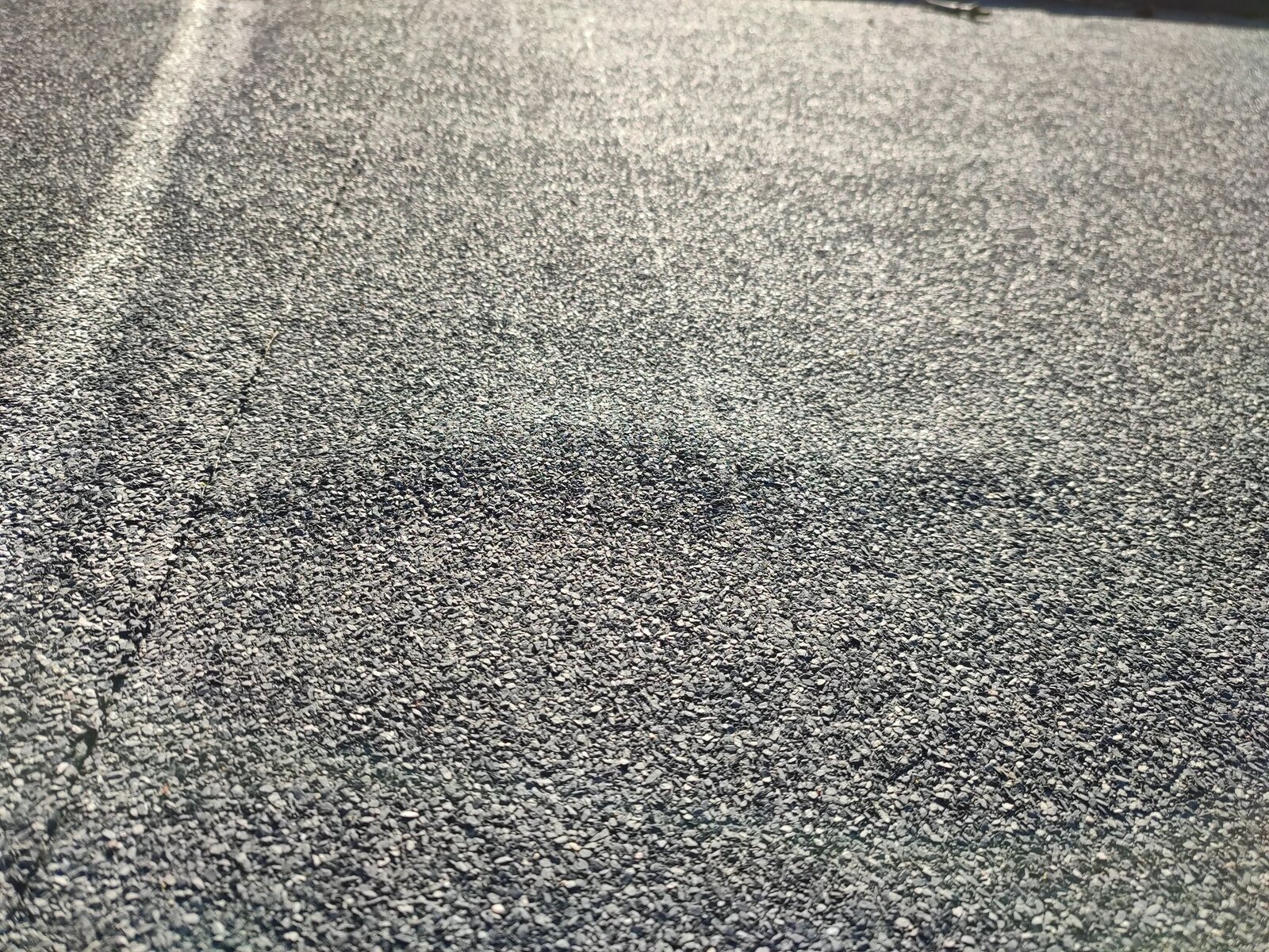

Hello all,
This morning I noticed a few 'folds,' in the felt of my flat roof. Roof was installed last winter. It seems to be full of air, and goes down slightly when pressed.
Anything to be concerned about?
Cheers.

Nothing to be concerned about.
It's actually a bit of de-bonded bitumen, not moisture. Heat has just expanded the air a little, stretched the felt a little, and now its like that for life.
That bitumen felt is quite flexible and resilient.

Why not post a pic or pics of the whole roof - annotate if possible where the "folds" are?
Either not enough heat when when applied ( favourite ) considering the time of year it was installed! or moisture is getting in! only a problem if its the latter.
Thanks for the replies, sorry for the lateness of mine. Had a bit of a health issue.
I've attached a picture of the front part of the roof, this is the part where there are the most number of the small folds. The rest of the roof seems ok
This was the last part of the roof done, at the end of the day.
Everything about both the front and rear flatroofs seems ok, just these 'folds.'
