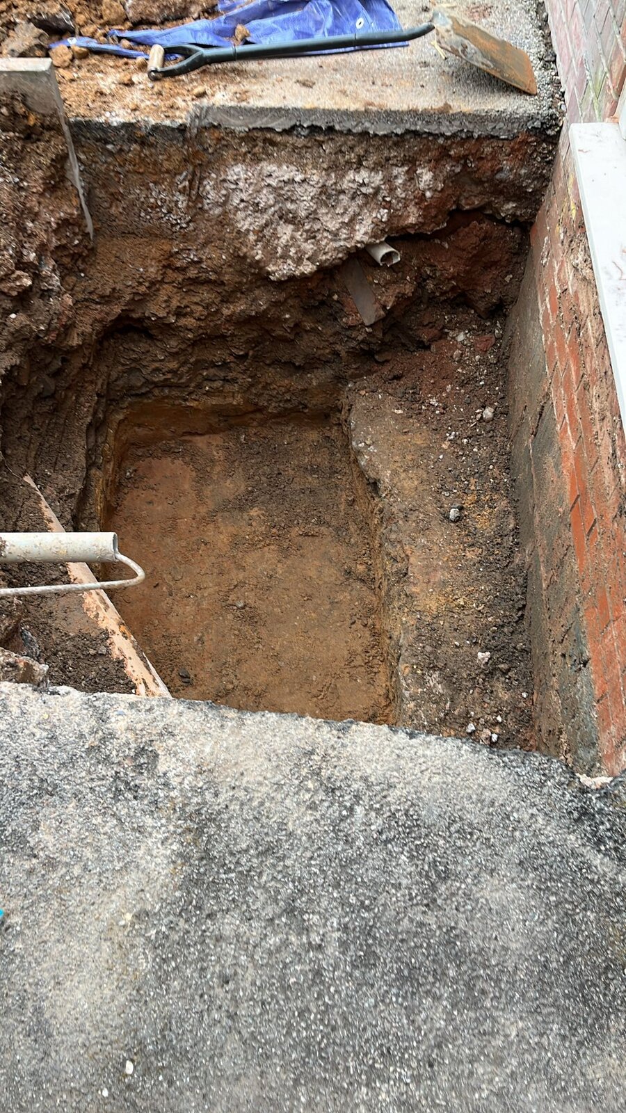

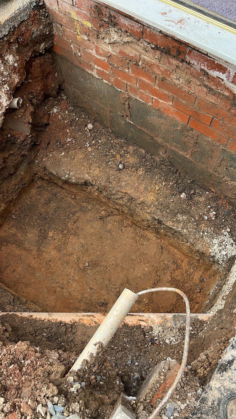

Hello,
Looking for any advice. Building a small
Porch brick extension…there is a drain water pipe. It’s at a right angle and the porch is due to come out in the area above the pipe.
Has anyone got any advice for how to concrete etc around and over this please/any pics. The neighbours drive is next to it, so it limits how much of the pipe we can expose.
Cate
Foundations -
Approved Document A
Page 36, section 2E, diagram 21. Step the foundation under the pipe and then back up.
Spanning pipe
Approved document H
Page 15, diagram 7. Shows you the two methods when an underground pipe goes through a wall underground.
You may have to dig a little lower to achieve this, I'm not there, so I don't know!!
