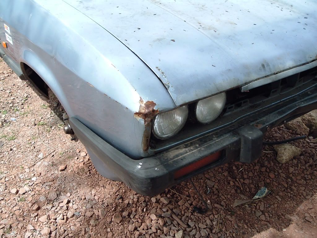

Everyso slightly better nick than mine was when I gave up on it (needed too much bodywork)
Wow :eek:
Been in the wars a bit that one.
Still, nothing wrong with being a bit rough around the edges.
