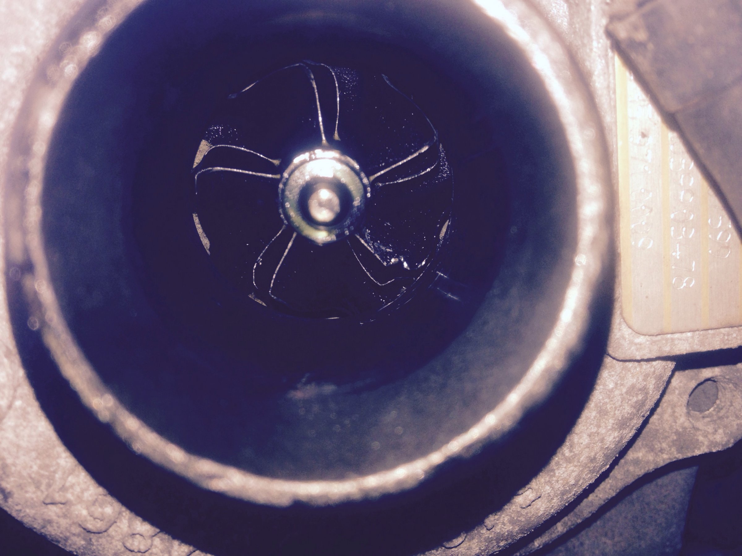

Ford Fiesta 1.4tdci 2007 140k miles. low power, speed decreases to approx 20mph uphill in any gear. revs dip at about 1800rpm like kangaroo gas. Injector seals & service done but the problem still exists. Any idea? Ta
Codes on scan P0238 (turbo) P0101,P0092,P0118 (egr/maf)

Back to the turbo.....can you pop the pipe off and spin the vanes? They should spin fine. Also look for any pipes missing from the turbo actuator, on the side.
After this, I think you need to get the fuel pump pressure checked at the common rail, and then the turbo boost pressure. Has the car had new fuel and air filters recently?

I've spun the vanes but needed a screwdriver as they were quite stiff. A little oil in the pipe that came off that.
They should spin freely with a finger mate......not like a kids windmill, but with minimal resistance. Look carefully for any scratching where the vanes may have been touching the turbo body.
John :)
Needed a screw driver to free them up, once I did there were still some very hard spots. The photo seems pretty conclusive too.
I guess it's a new turbo then.
