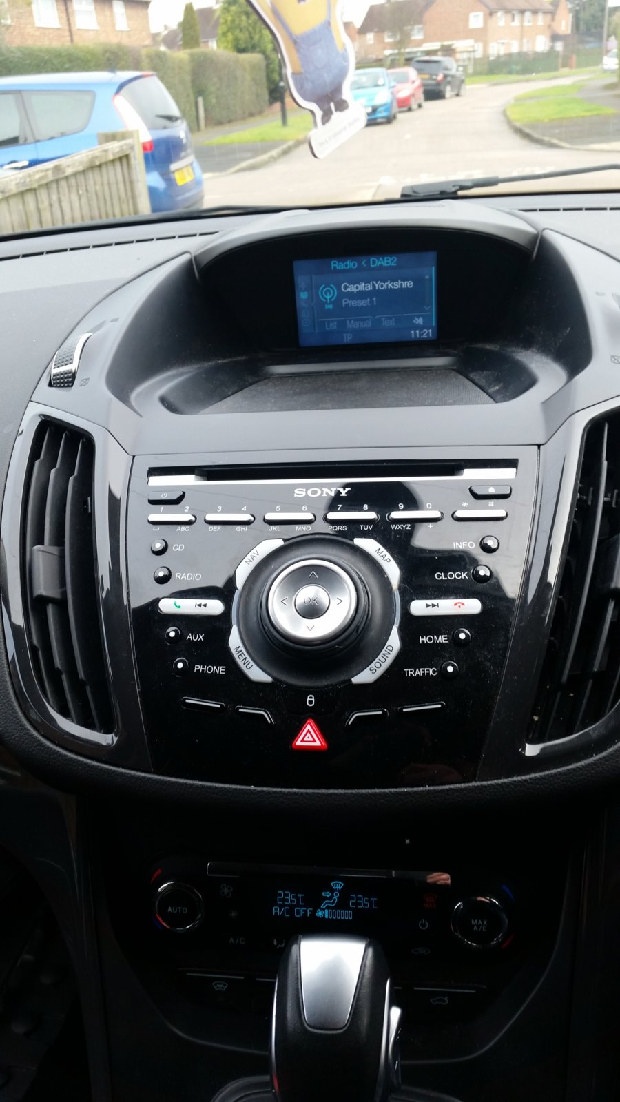

Gone for one of these, Android based (free apps and satnav updates!).
Replaces the old unit and fascia, plug and play apparently!.

That looks interesting. What's it called, and how much was it please.
It's from a comany called Electro-Navi in France.
Plug and play, Canbus compatible (operates Aircon etc), Ford reversing camera compatible. All steering wheel controls work.
Cost £560 which to be fair isn't that bad considering I could have had my original "repaired" for £450 and wouldn't really trust it.
This is what it's replacing.
