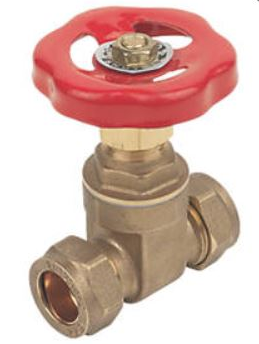

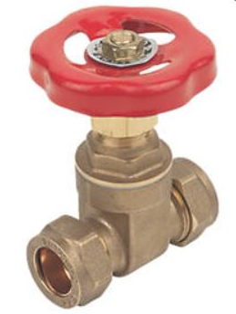

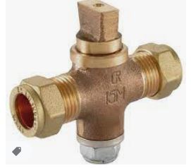

Are you sure it's the "overflow" that's running and not the drain down?, both pipes will go outside,
It's likely you are constantly emptying the tank, have you opened a sludge cock or gate valve at the bottom of the tank and not closed it again before filling the tank back up?.
sludge cock gatevalve
Hi mate the gate valve l have turned this off when it's open full the amount of water went all the way up and it was around an inch from coming over the top of the tank,
I started with changing the taps in the bathroom so l turned the water off at the mains l the turned the gate valve to close and the tap just above it which feeds the top part of the tank l changed the 2 basin taps with 2 single taps, l the put a vent valve think that's what it's called on the hot tap pipe work as the new tap is a mixer so the cold water doesn't go down the hot tap, l then turned on the mains water, l then turned the tap above the gate valve on this is where the ball valve leads to, l then turned the gate valve on to open the tank made a bit of nose like air was bubbling out of the top the water kept rising and wouldn't stop so l turned the gate valve off l though it maybe air blockage in the hot water pipe so l connected a bit of hose pipe from the cold tap to the hot and ran it for a couple of seconds which cleared any air out as the cold water was the coming out of the hot tap l hope this is making some sense? So l am a bit stuck the tank is a fortic cylinder tank with the water tank just on top it's a all in one tank though it mite be crossflow but lve checked and all okay l did read that the coil may have a leak in it and that's why when l open the gate valve it will not stop filling up but lm not sure any ideas?
