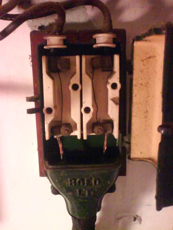

Found this open in a cupboard. Ouch !!

I know we all love pictures so heres one from today's job.
Could have been nasty while putting the hoover away !! No nut and bolt holding it closed, just flapping about open.
Just done PIR and found this. Am I right that this fusing of the neautral is no longer safe practice ? Must be about 1950's or older ? Earthed to water main and no MEB either. Will be applying for a pme on this amongst lots of other upgrading.

I suggest you get on to DNO asap on their emergency number as it's an unsafe supply
I second that.
A fused neutral is very unsafe, and I beleive was outlawed in the mid-fifties
Oh and the whole direct contact thing too :eek: :eek:
I've secured the the service head closed and will be on the phone in the morning. Thanks guys .
One reason being if the fuse goes open circuit the neutral throughout the installation becomes live which is not good.
The other being if the fuse goes open circuit, the power will fail, but leave the installation "live".
