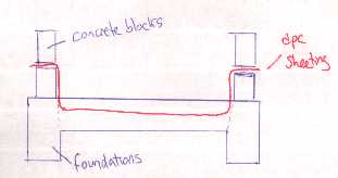

Hello all,
I need some advice. I am about to build a concrete block shed in the garden. (Don't need planning permission in my area thank goodness!). It will most probably have some kind of felt roofing. I'll be using normal concrete blocks (440x215x100mm) the query I have is how deep should the foundations be. The ground type is muddy clay (!) as you start to go down. I've read somewhere the width of the foundation strip should be double the width of the block (i.e 200 mm), but the depth eludes me :rolleyes:.
Another quick question. I'll be putting down the damp proofing sheeting under the concrete floor in the shed, is it normal to fold this sheeting up at the edges and use as the dam proofing course for the blocks or should a separate dpc be used for the blocks?
Any thoughts / answers ( :LOL: ) gratefully received.
This is a difficult one,all depends what you want the shed for.Most people just build a 6" concrete base with membrane underneath + approx 12" footing round the edge to take the weight of the walls then use engineer bricks on top of the base to DPC level (150mm at base level) then your celcon blocks on top of dpc + the walls will have to be rendered.Do not use celcon blocks straight on top of footing -you will have damp problems.
OR you can have a footing with common or engineer bricks on top to dpc level,oversite fill in with reject or hardcore then pit sand + membrane 150mm below dpc level and slide it under the dpc with 100mm concrete + 50mm floor screed.This is really for extension building etc.Like I say depend what you want the shed for and how fussy you are.

In the picture above, if I am using a dpm sheeting (such as this) and it it tucked into the first layer, does this act as the damp course or should a dpc be used as well?
(In the diagram I wrote DPC sheeting but is of course DPM sheeting)
Also in this situation can concrete blocks be used as the first layer as it will be outside the DPC and DPM , so in thoery any damp should be stopped.

No it won't,so use a dpc (see this ) on top of your dpm sheet as well.The dpm sheet won't be flat & you will get ripple effect on top of the wall all the way round,so dpc will be flatter,stronger and easier to bricklay as with dpm sheet, the cement + cement blocks will keep sliding off the sheet.I would use 3 courses of engineer brick (not much dearer than common brick) which will give you approx 150mm high to dpc level which is waterproof and frostproof.Then a layer of cement under the dpm sheet on top of the wall with dpc on top then cement again with blocks etc.Also make sure the return wall on the externel corner is minimum 450mm when fixing door/window frame.

This might make it easier, slightly more detailed because I know how you can scratch your head when it comes to building it! I've been there!
Ignore the foundation sizes, this was for a garage that I drew up for someone, so they may not apply to you.
