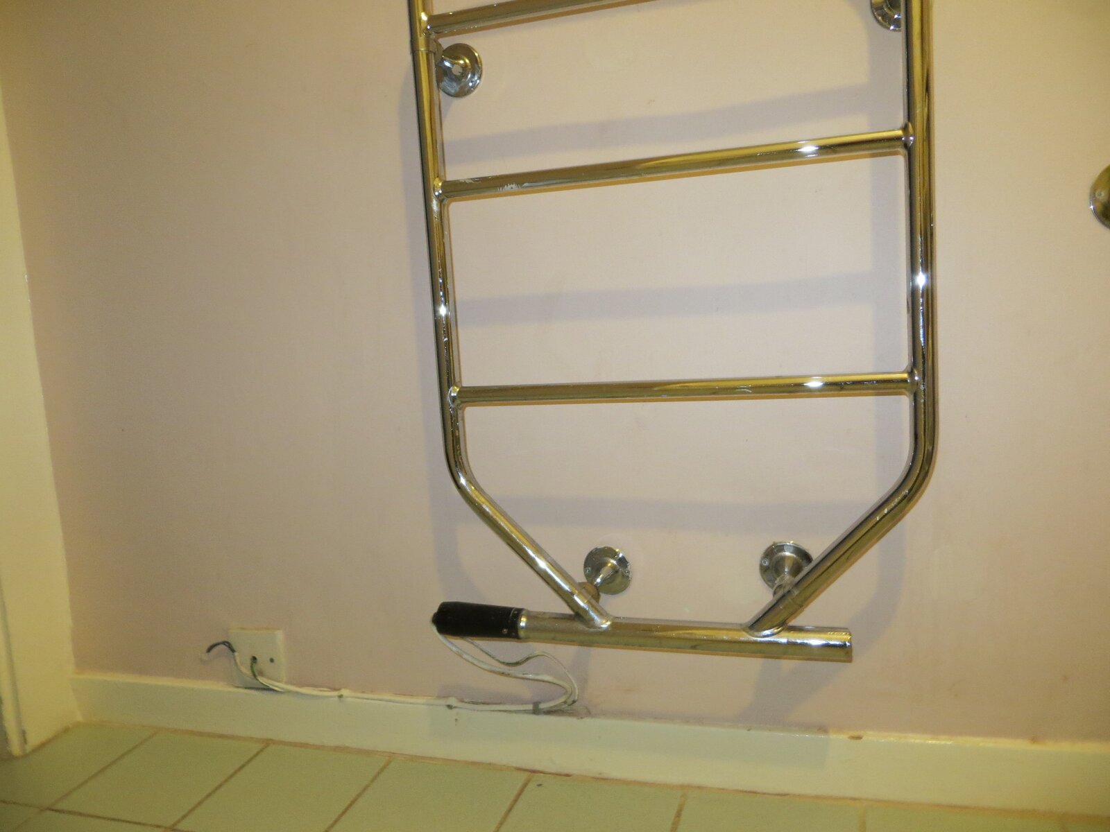

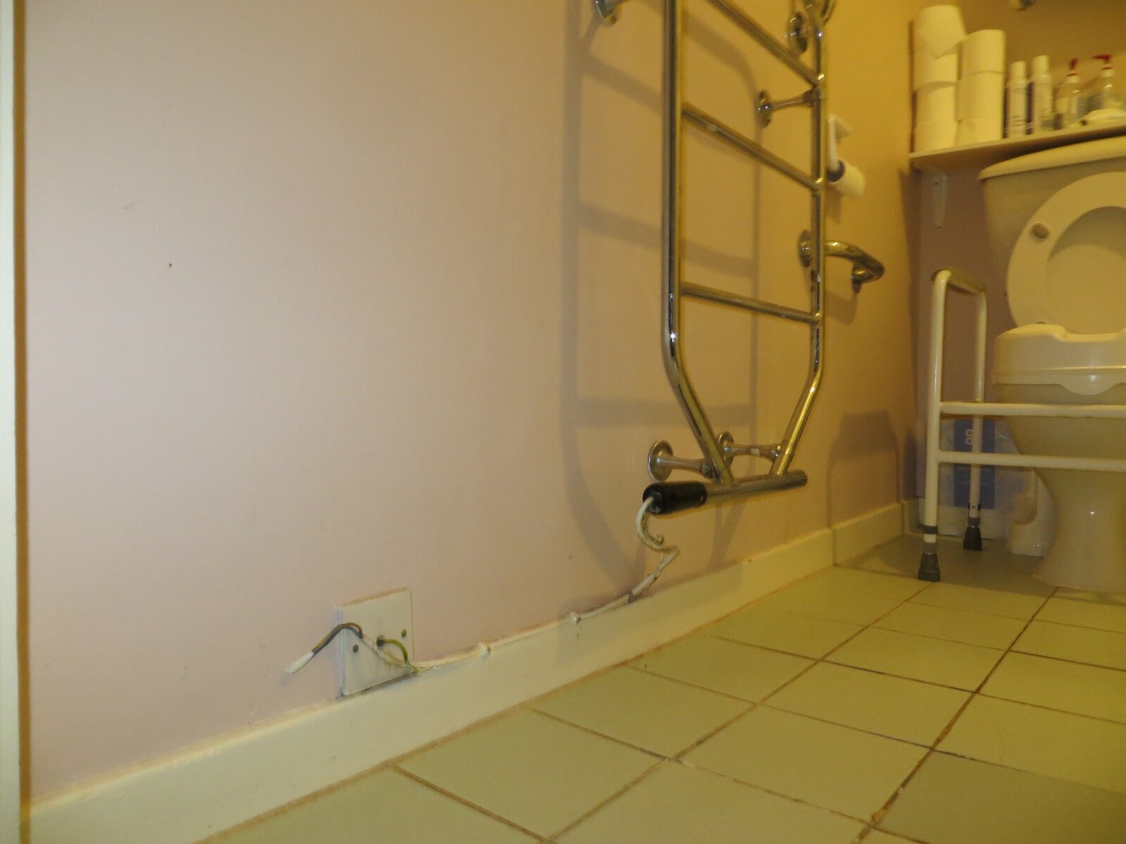

I hope to remove an old electric towel rail from the bathroom. But it has a fourth wire, which is beyond my simple understanding.
It would be simple to isolate and unscrew the live, neutral and earth from the unswitched socket, but the fourth wire continues (through the socket) somewhere into the wall.
I don't understand earth bonding, but perhaps the fourth wire is some type of extra earth bond and perhaps it would be safe to simply cut this wire and tidy it into the redundant unswitched socket? Or should I call in an electrician?
Thanks for any guidance.
A photo or make model of the towel rail might help. Is the extra wire green & yellow? If green & yellow then the earth has to be continuous and link back to the main earthing arrangement.
Two photos showing the towel rail and wires. The three 'normal' wires have been removed from the socket.

Hard to tell from photo, looks like it is an earth wire. It’s also separate from the main flex cable, so likely an earth.

From your photos, there is no "socket".
However, there appears to be some "rough" wiring.

They have taken supplimentry bonding to the heater itself (not strictly necesarry, connecting at the local connection point or isolator is acceptable)
Presuming it does not loop onto anything else from the heater (you only have the one extra earth to the box, theres no more from the heater that go in another direction) Then just cut in the box and connect it in with the other earth thats in there (make sure you leave a reasonable length in there to work with)
Fourth wire is now cut. In doing this, it was obvious to see that the wire was an earth. Earth bonds used to be provided to exposed metal in wet areas to provide a extra strong pathway to earth in the event of a fault developing (I think). I've connected the cut wire to the earth in the box as advised by Adam. Thank you all. I needed to reassure myself.
