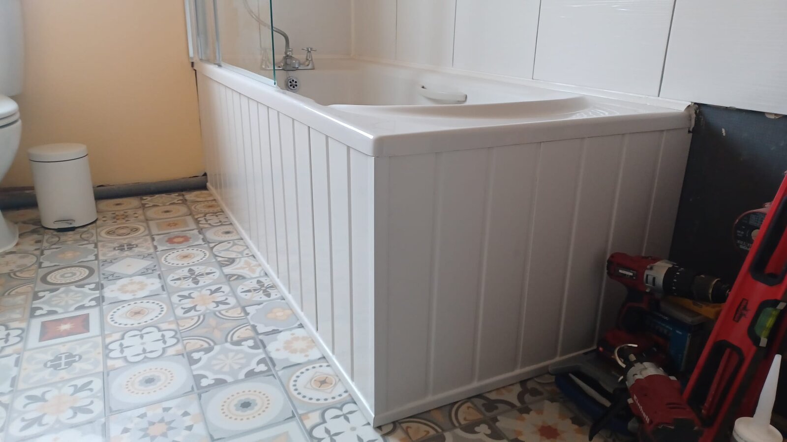

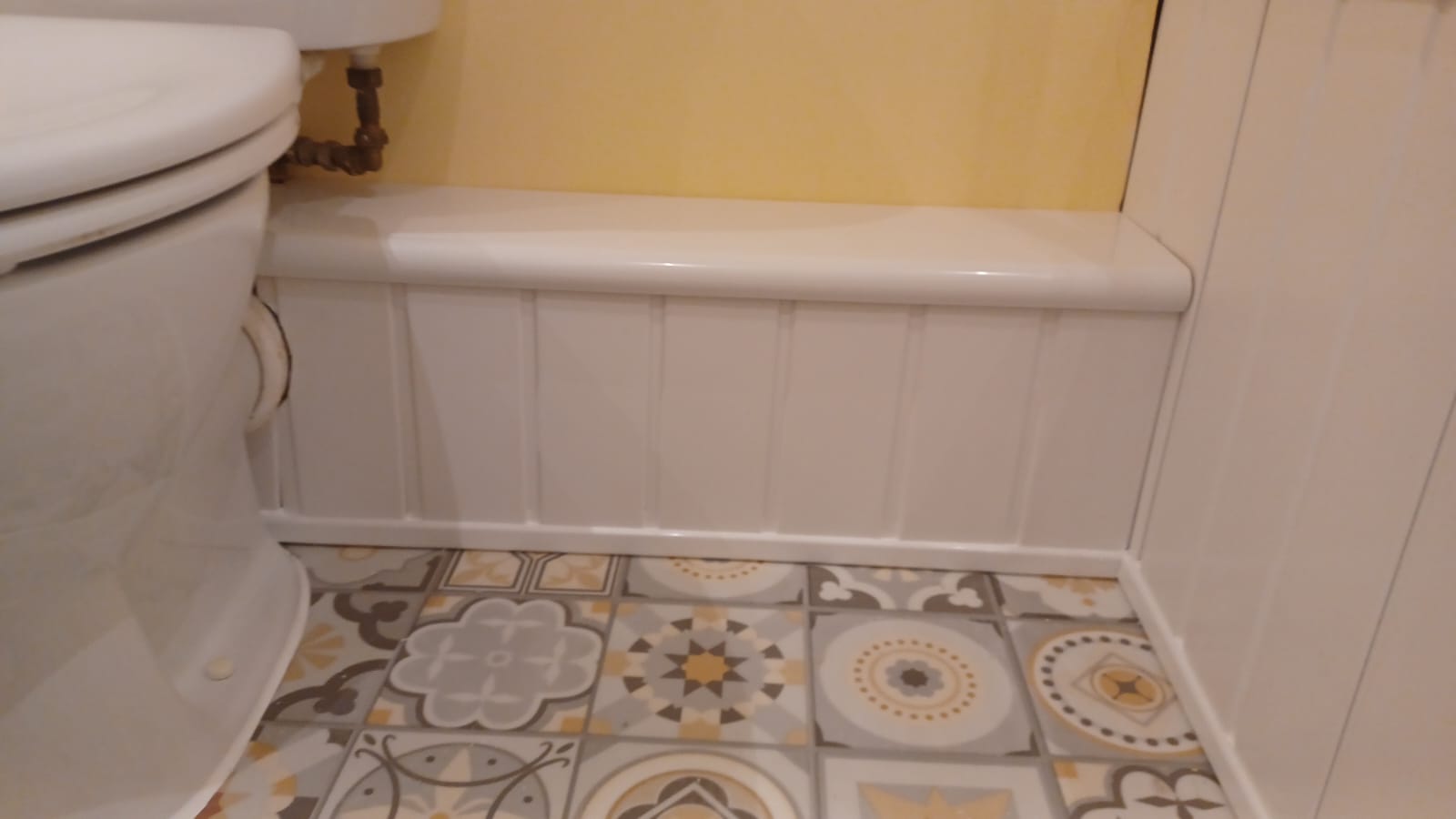

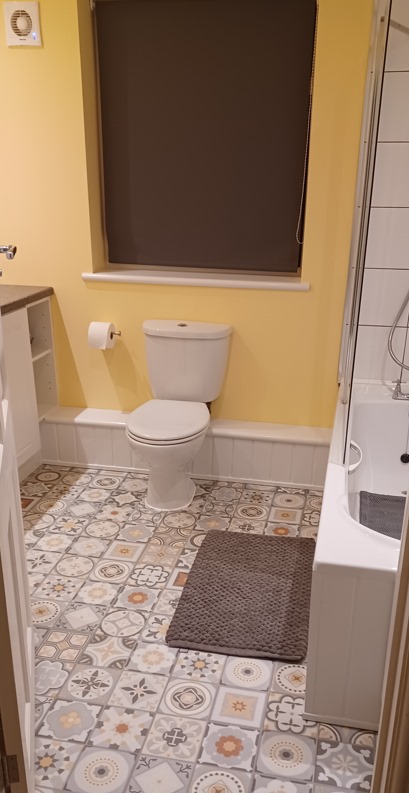

I was in need of a new bath panel.
Old one, I made from cheap pine t&g with boxing in made from mdf window board and contiboard.
All of it got a bit water damaged over the years.
Was very impressed with Foxhole's solution.
Economical, looks good (to my eyes) and won't rot.
Soffit board 300mm wide x 5M long
Right angled corner trim
Trim for the bottom edge
PVC window board capping
Timber to make the frame for the boxing in
