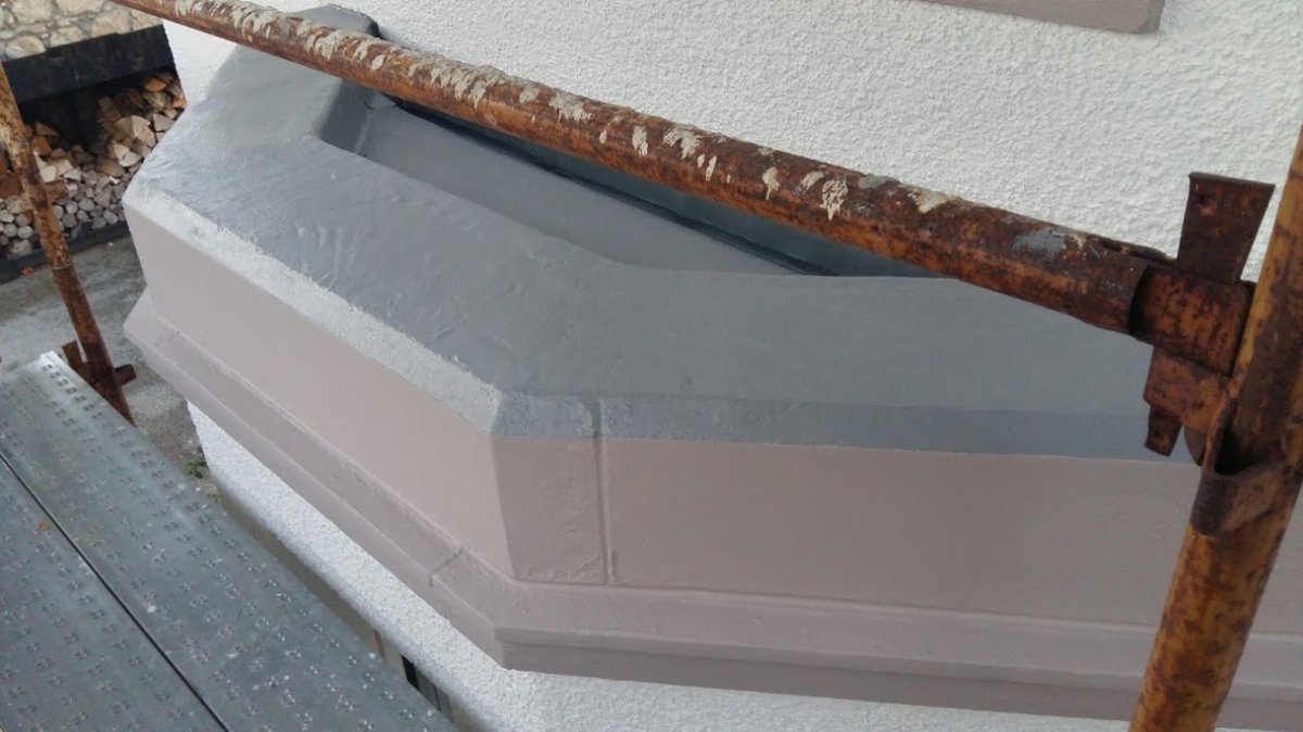

Hello,

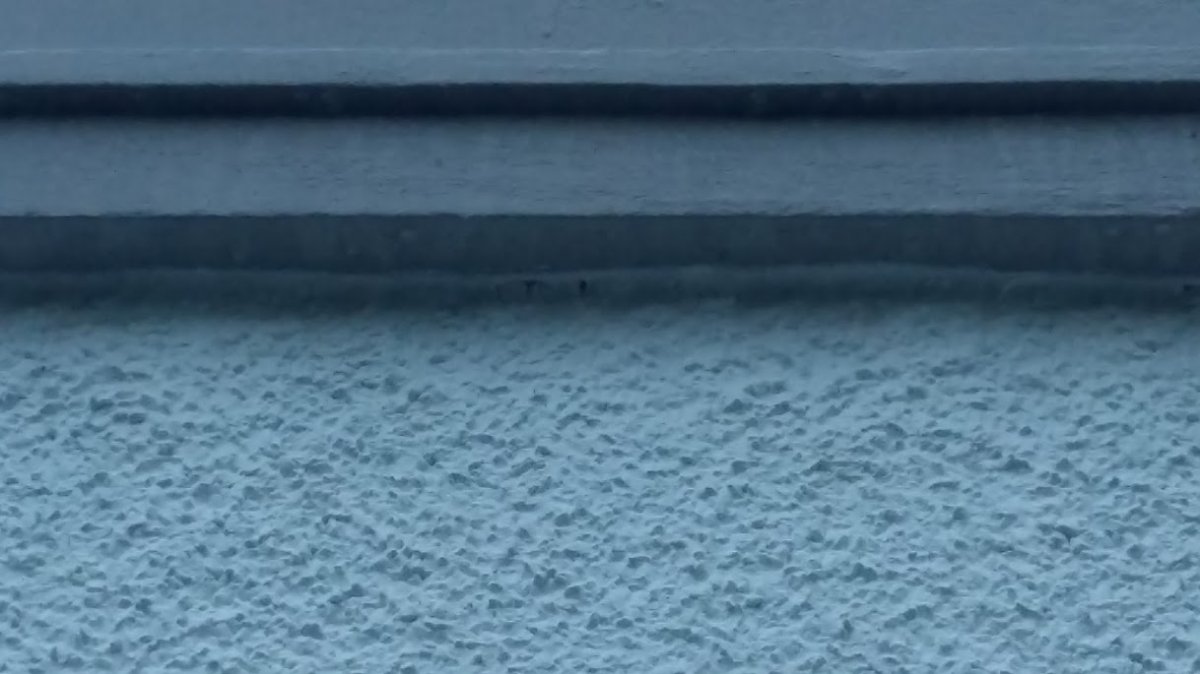

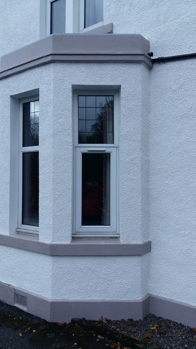

I've been working my way round the house over the past few months painting and doing various repointing etc. I'm using Dulux Trade masonry for the white and Sandtex for the stone colour for cills etc. I've resealed round windows (cant remember brand) and doors etc as previous job wasn't great using a premium white exterior builders frame sealant. So far everything is as expected and worked well.
But I've had a problem at the bay window. The house is about 90 years old and has been reharled in the past and where the harl goes up to skew stones etc and the head stone on the bay window there is a 1-2mm gap, possibly shrinkage. I have painted everything white stuffing the paint into this gap. Then completed the detail coats of the pinky colour. Then finally used the frame sealant under the pink bay window head stone to stop water going down the back of the harling.
I've done this process everywhere so far no probs. But the sealant under the head stone on the bay window keeps running out. Today when I touched parts it was skinned but when pressed the skin broke and white water ran out. I had redone some parts as this happened the other week but its happened again to a slightly lesser extent.
Every time I've painted weather has been dry , ive always done recoats next day at the earliest etc so I'm not ever putting sealant over paint that isn't too dry etc. The masonry paint is dry in 30 mins anyway and sometimes I've left it days before I've done the next task.
The only variable on the bay window that differs from elsewhere is that Ive painted the top with Cromopol. An oil based roof paint. I did this to tidy it up and to seal the top of the head stone which was porous with age as its coloured concrete. Cromopol is solvent based everything else I'm using is water based.
Even though I've applied everything on good days and its dried well is it possible that there is some sort of solvent present and being washed down the wall after rain that is attacking the frame sealant? Are there solvent based frame sealants available or should I try silicone sealant.
See pics if I've attached right.
Thanks for reading.
