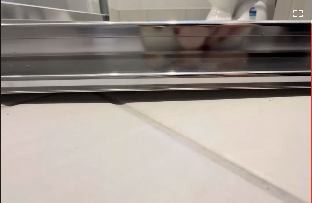

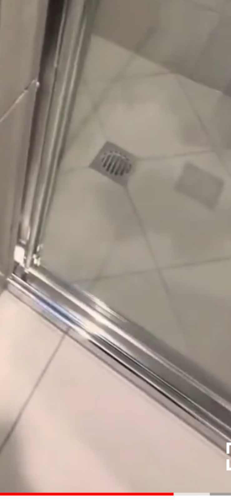

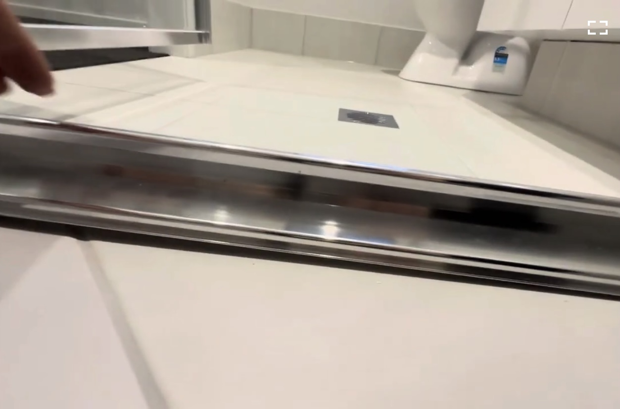

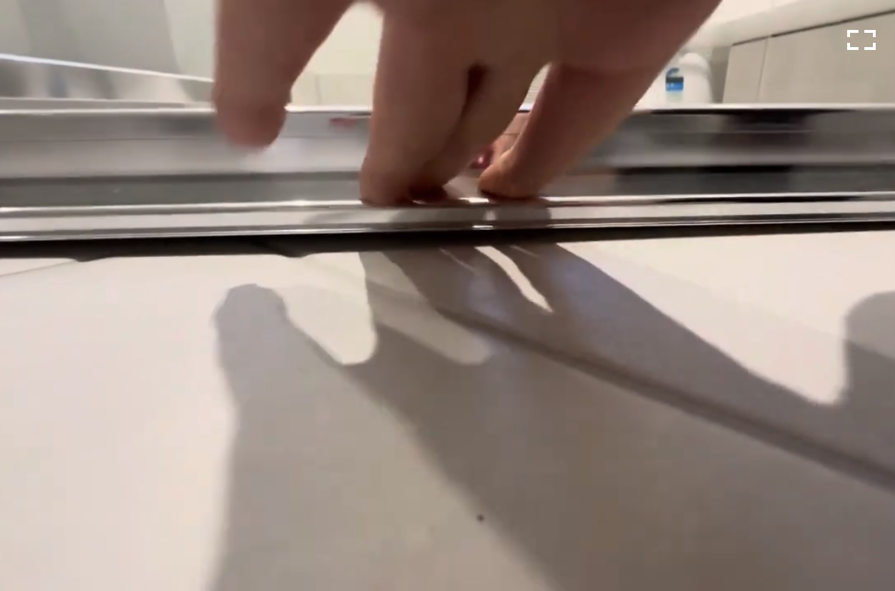

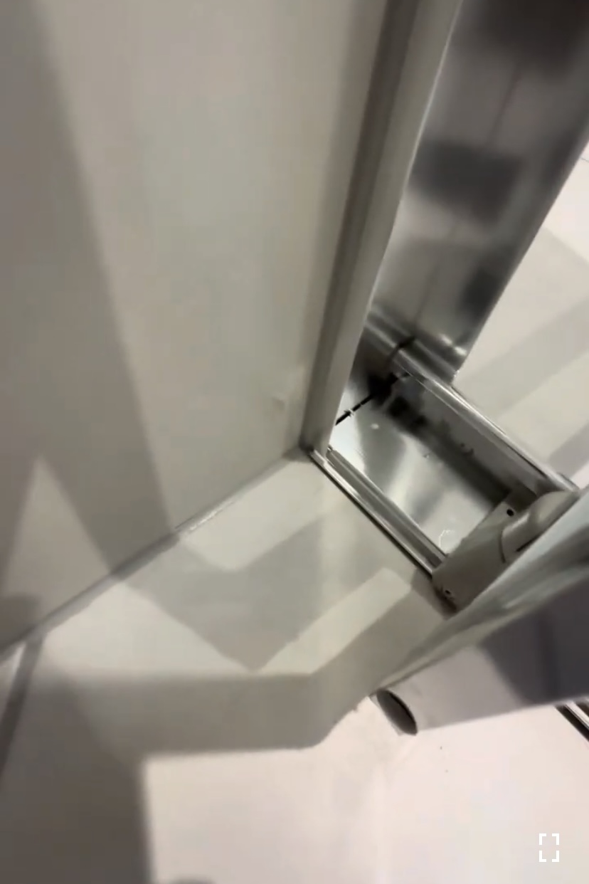

May I please seek your advice on the framed shower screen that is installed by the builder in new built house (yes not a diy job hence not suitable oreganos for this forum but I will value your input).
Framed shower screen installed in two bathroom that shows same problem. The inside of the shower frame that has a door in built is not sitting flushed to the tiled floor. Please refer the pictures. Do you think this is standard? I could not find reasonable material on Australian standard for framed shower screen. The view of the picture showing gap is from the inside of the shower.

That's what proprietary seals or silicone was invented for. The odd tile may sit a fraction lower than its neighbour, meaning something straight will not touch.
Is the whole of the bathroom floor tiled? Basically a wet room setup? The gap may be where the fall/channelling of the (edit)tile has been formed to allow the water to run towards the drain. If that's the case then water shouldn't run up through that gap.
If it's not part of the formed floor for drainage and they should be level then the tiles have been poorly installed and shouldn't be that far out. If it's a new build then I'd put that down as part of the snagging list.

Yes whole floor is tiled and you echo all the points that I had thought of too
1. There is tile slope to manage the water flow, but water still splatters everywhere and I see this gap as a place where no brush can get and gunk will start to collect in there (I do not like the idea of such a broad plate for shower recess.
Like you said , yes it is in my snagging list for builder to fix. But I wonder how they will fix it. It is a big gap for silicone to fill in
Thanks for assuring that I wasn't the one thinking oddly.

That gap is a lot for a silicone to fill in unfortunately.

If it's there as part of the floor design and the fall formed into the tiling to allow it to run towards the drain then it isn't really a snagging issue, as it's supposed to be there but that would indicate that there shouldn't have been an enclosure or door etc installed as part of the design then. If the shower enclosure/glass/door is there as part of the design then the fall should be contained within the footprint of the enclosure and the tile around the edge should be level to the screen, if so then it would be a snagging issue
The only way that could be fixed properly though is destructively - lift the tile, clear out the space and re-lay. A fudge would be to fit a formed seal along the whole bottom edge, certainly not what I would want on a new build.

"Correct"- This is right- If the shower enclosure/glass/door is there as part of the design then the fall should be contained within the footprint of the enclosure and the tile around the edge should be level to the screen, if so then it would be a snagging issue.
And yes I would not like building a little platform around the shower but I guess that is the only solution.
