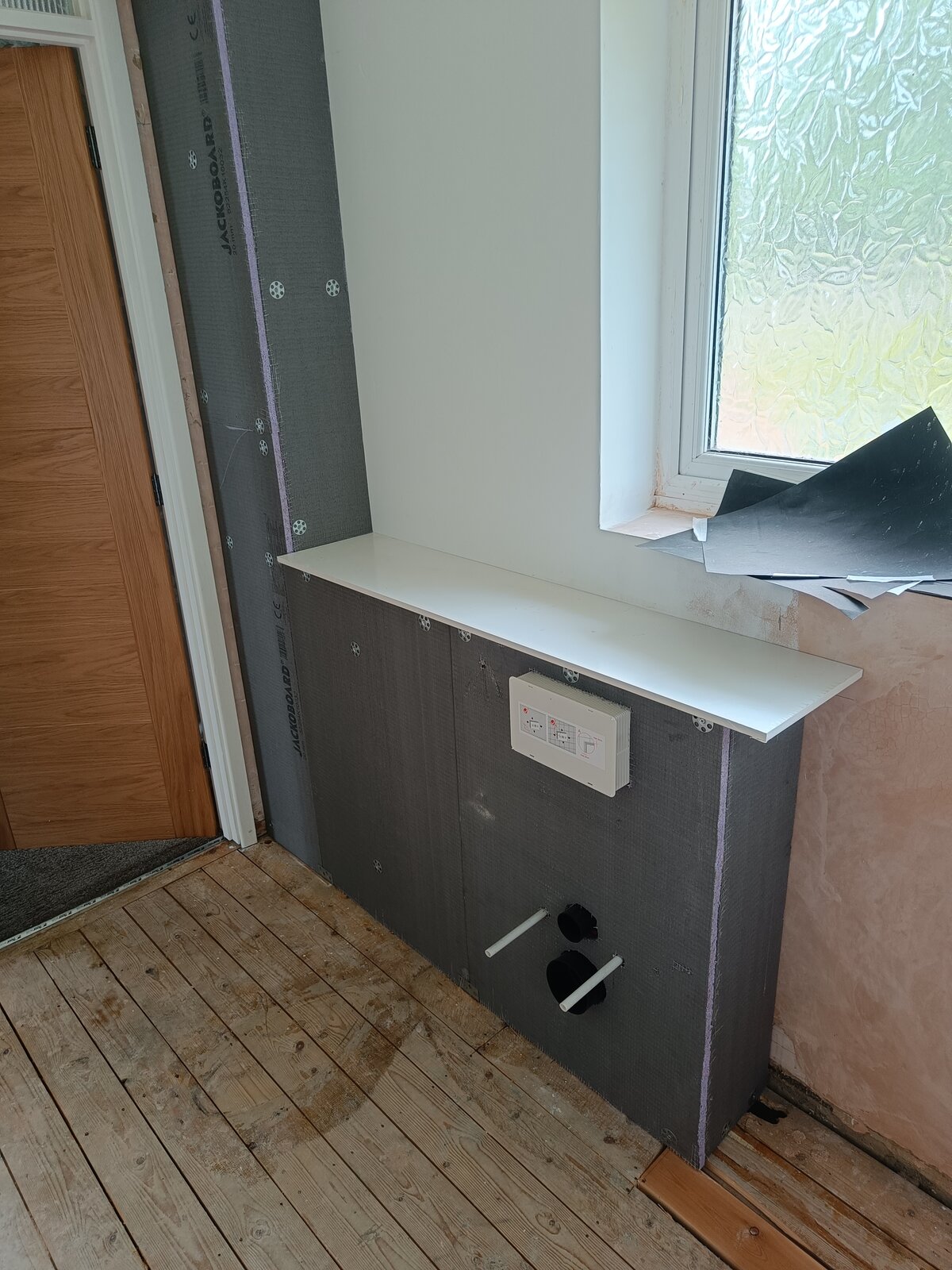

Hi,
this week I need to frame in a concealed cistern toilet, before the tiler arrives
(perhaps not the right forum).
I have one of thse rak ecofix
(although it is a back to wall toilet, not wall hung.
I have bought some 20mm jackoboard to board in,
the frame is metal, so I screw into the metal frame? or do I stud frame all around it, without screwing into it?
any guidance welcomed.
thanks.
thanks @Madrab the metal frame was secured to wall, but didnt attach the frame to it, built one around, and used jackoboard,
seemed to come out okay.
