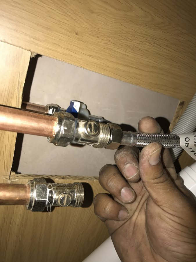

I purchased a Franke Dixi mixer tap for the kitchen and fitted to the sink, bit upon making connection to the 1/2" isolation valve, I have noticed it is smaller than 1/2". Picture attached
What do I need to get this to fit?
Thanks in advance
the thread is 3/8 bsp female on your flexi. so you need 15 mm to 3/8 bsp adaptor. tool station do them
tool station item code 63663 "tap tail adaptors " £2.40 for 2.
you will also need ,if you don't already have , two 15mm olives and 2 compression nuts , to enable connection to your isolation valves.
