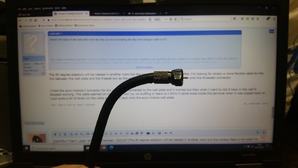

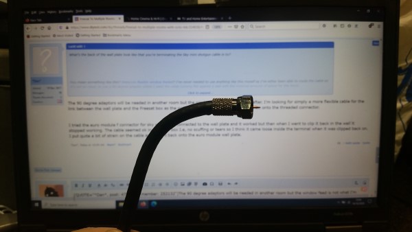

The 90 degree adaptors will be needed in another room but the window feed is not what I’m after. I’m looking for simply a more flexible cable for the link between the wall plate and the Freesat box as the webro cable is very stiff and hard to screw onto the threaded connector.
I tried the euro module f connector for sky with it not connected to the wall plate and it worked but then when I went to clip it back in the wall it stopped working. The cable seemed ok in the back box I.e, no scuffing or tears so I think it came loose inside the terminal when it was clipped back on. I put quite a bit of strain on the cable as I bent it back onto the euro module wall plate.
I'm a little surprised you seem to be having so much of an issue with this cable. I use WF100 for all my own work. Here's a bit of it I have lying around the office. This piece has one of my screw-on connectors attached, but I use the same compression plugs as you for my outdoor and loft work and it doesn't change the behaviour of the cable. It'll take a bend quite easily.

I know that the weight and leverage of some cables can be an issue for weaker grid modules. I've come across situations where Cat5e network cable has pulled out weaker modules in a Euro face plate, so I can imagine that the same might be true with RG6-sized coax, especially if equipment is pushed up against a wall which then leads to a bit of leverage pressure on the cable.

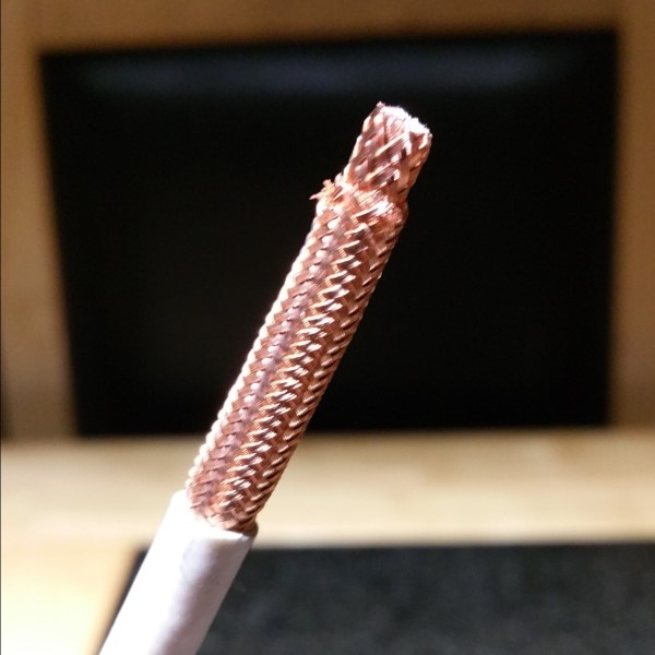

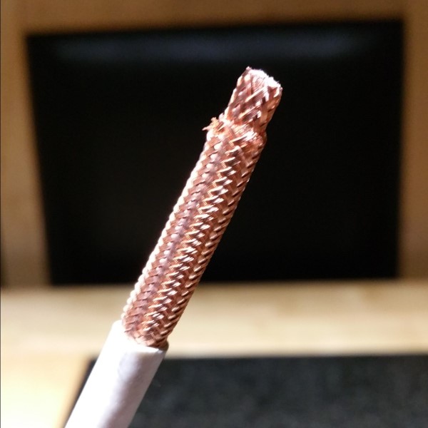

The other alternative is some mad double braid shielded BBC coax I have, but it's a hell of a lot heavier for only a marginal increase in flexibility. The density of the double braid shielding won't completely compensate for the loss of the foil shield, but it's never come up as a problem in the OB rigs where this type of cable was used.
