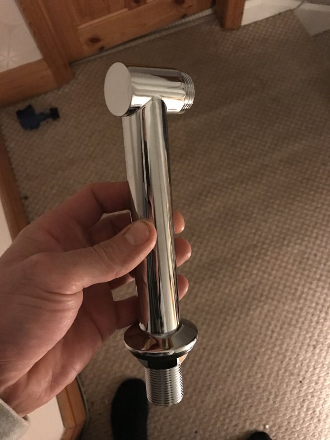

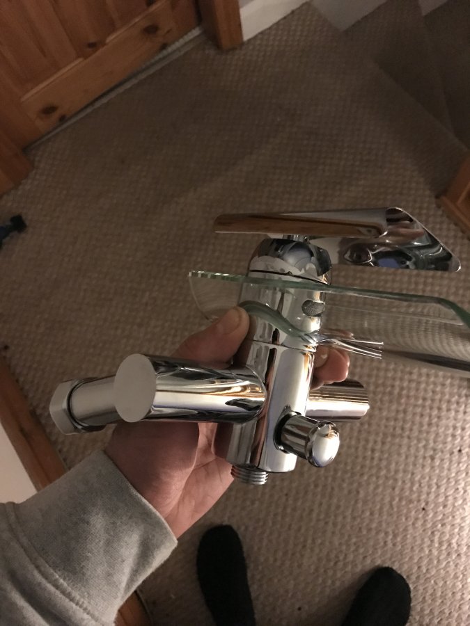

Here we are. This is the tap:
And these are the legs I found which do match and are long enough so we won't see the bottom joint once behind the bath:
If only they were 400mm longer!! I did wonder if I could put a 3/4 x 1 1/2 bush onto the legs and get some female threaded 1 1/2 chrome tube to go over my flexis.
