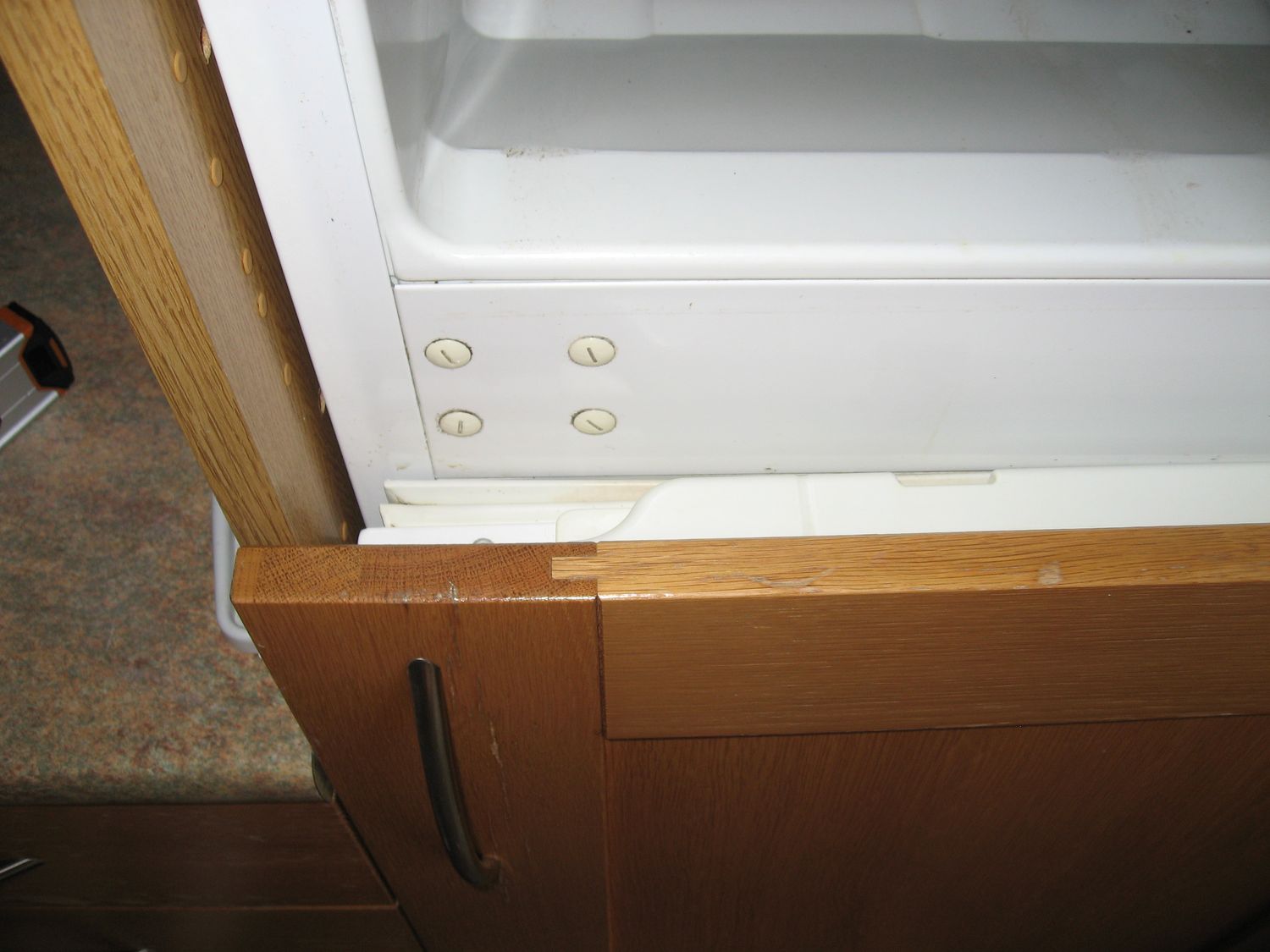

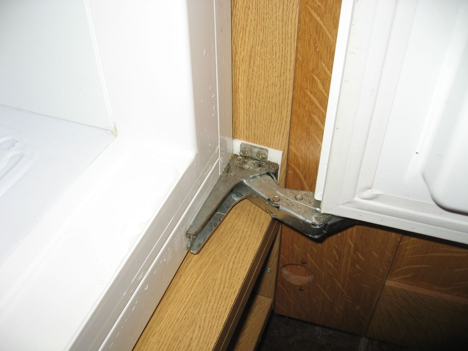

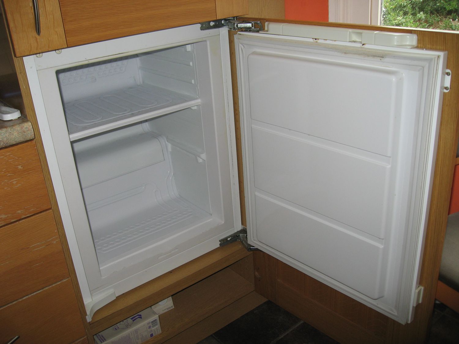

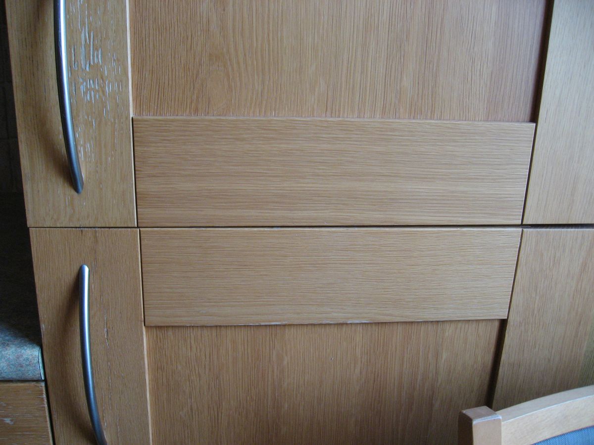

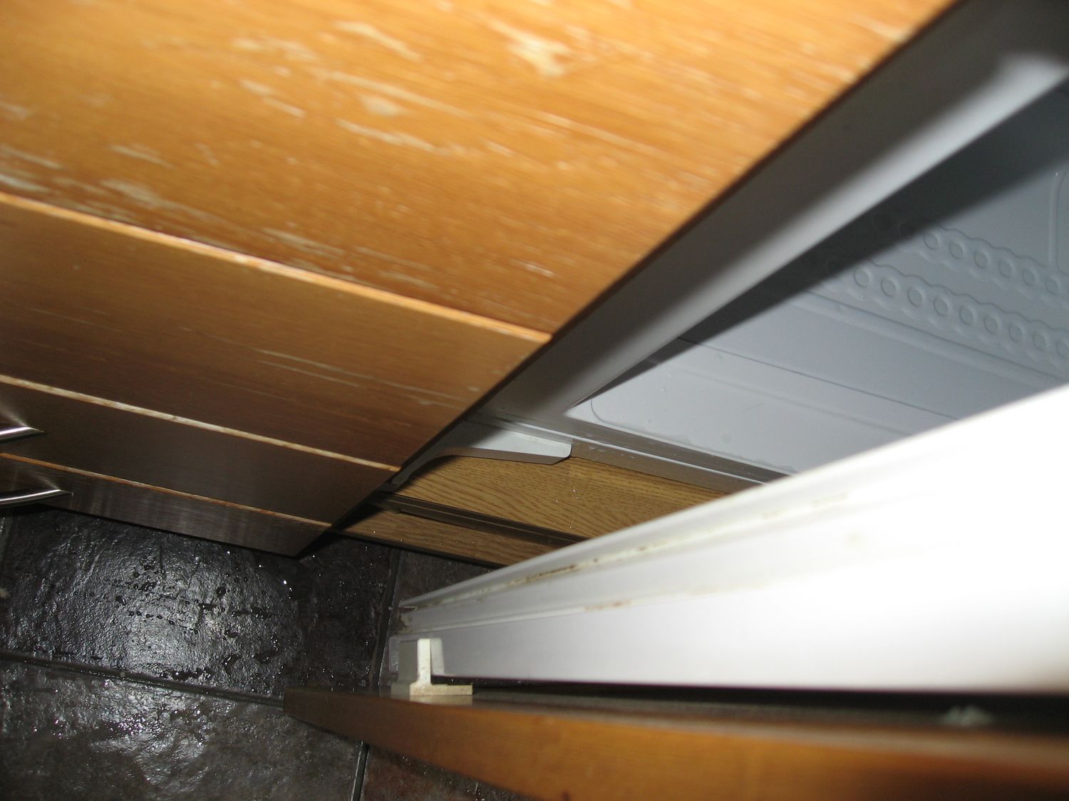

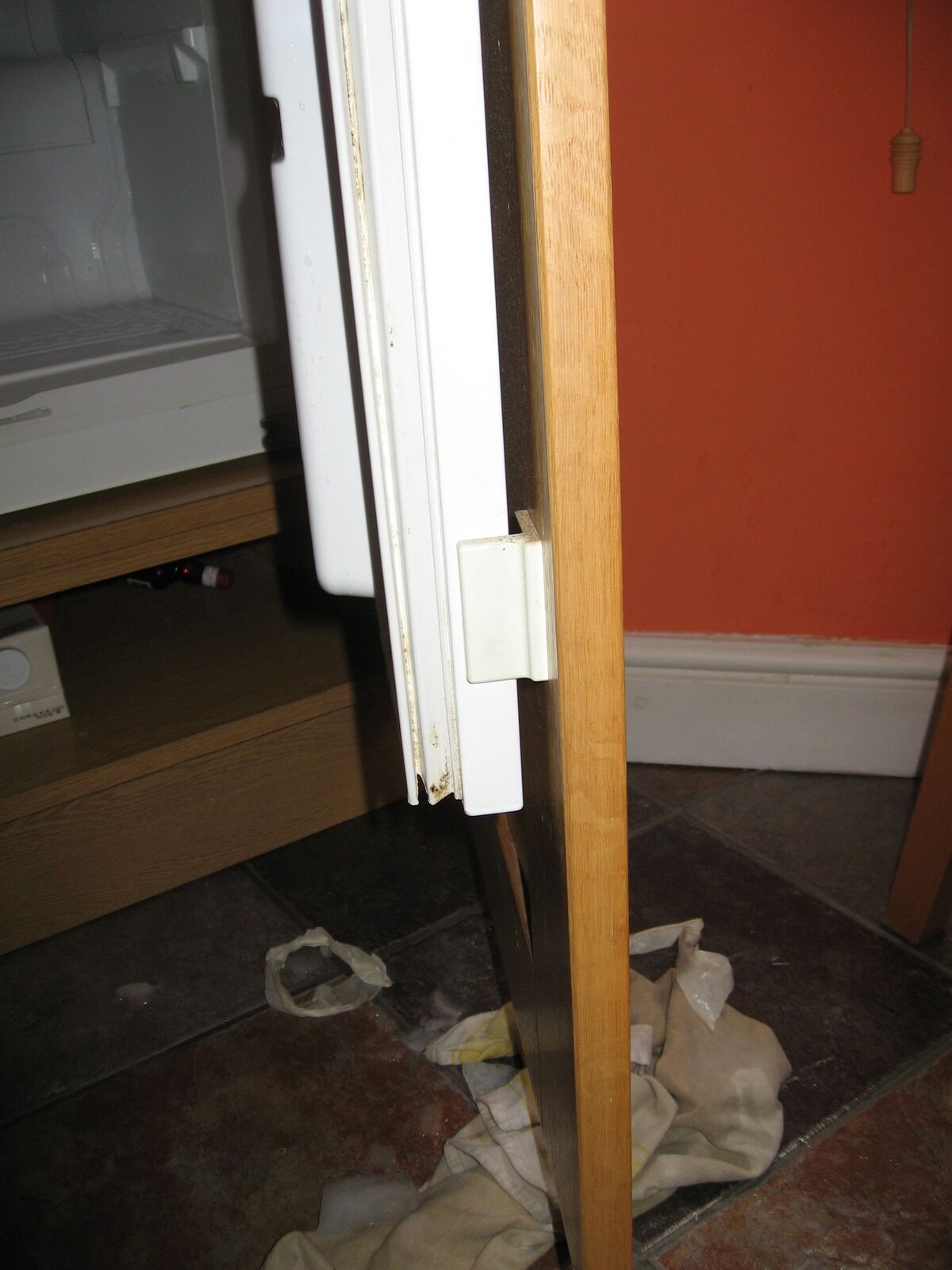

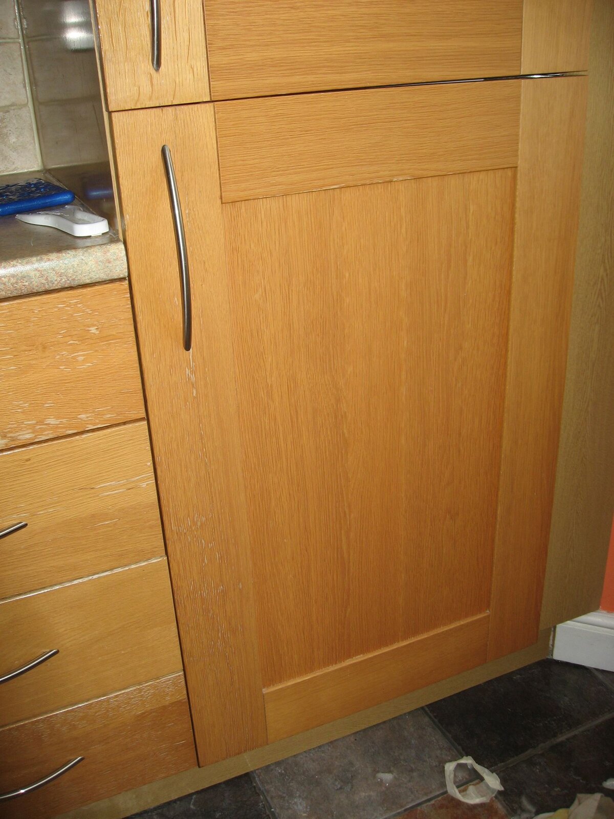

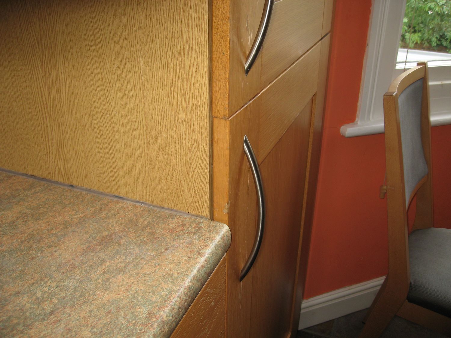

Hi. As described. Even if I push it closed doesn't budge is about 3mm gap in the seals. Wooden cover seems slightly shifted to the right. Not sure if the white wedge thing at the bottom of the inside of frame is blocking it. Seems that the wood against the wooden carcass has play room so its not that.
Any advice? Perhaps need to take wooden cover offf.
? Not sure if the door has warped slightly where the handle is over years of use ??
Thanks for any help

It is possible that the freezer itself has moved backwards so once the door hits the carcass it isn't in contact with the freezer. Pull it forward slightly and see if it has loose fixings that need tightening to stop it travelling again.
