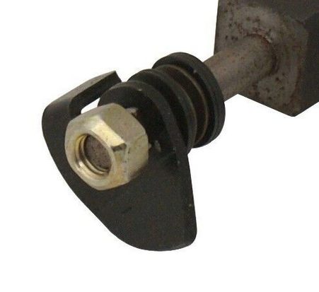

@SFK - which plate are you referring to? Don't suppose you can mark it for me?

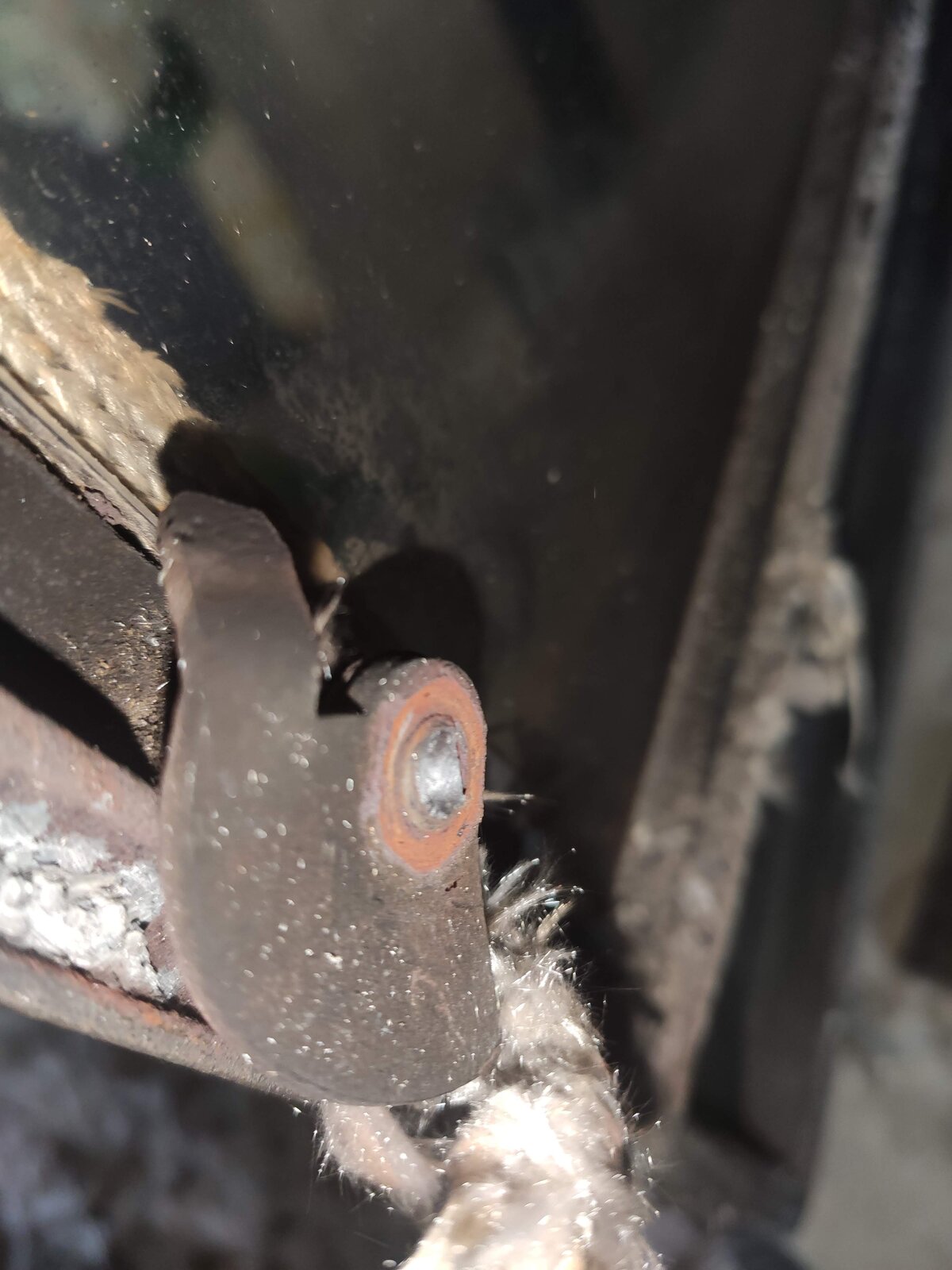

I meant that the locking plate (behind the bolt) looks in you image a lot more bent than the the item I found on ebay.

I do feel that the plate is bent - but not sure.

Agreed, it should be flat.

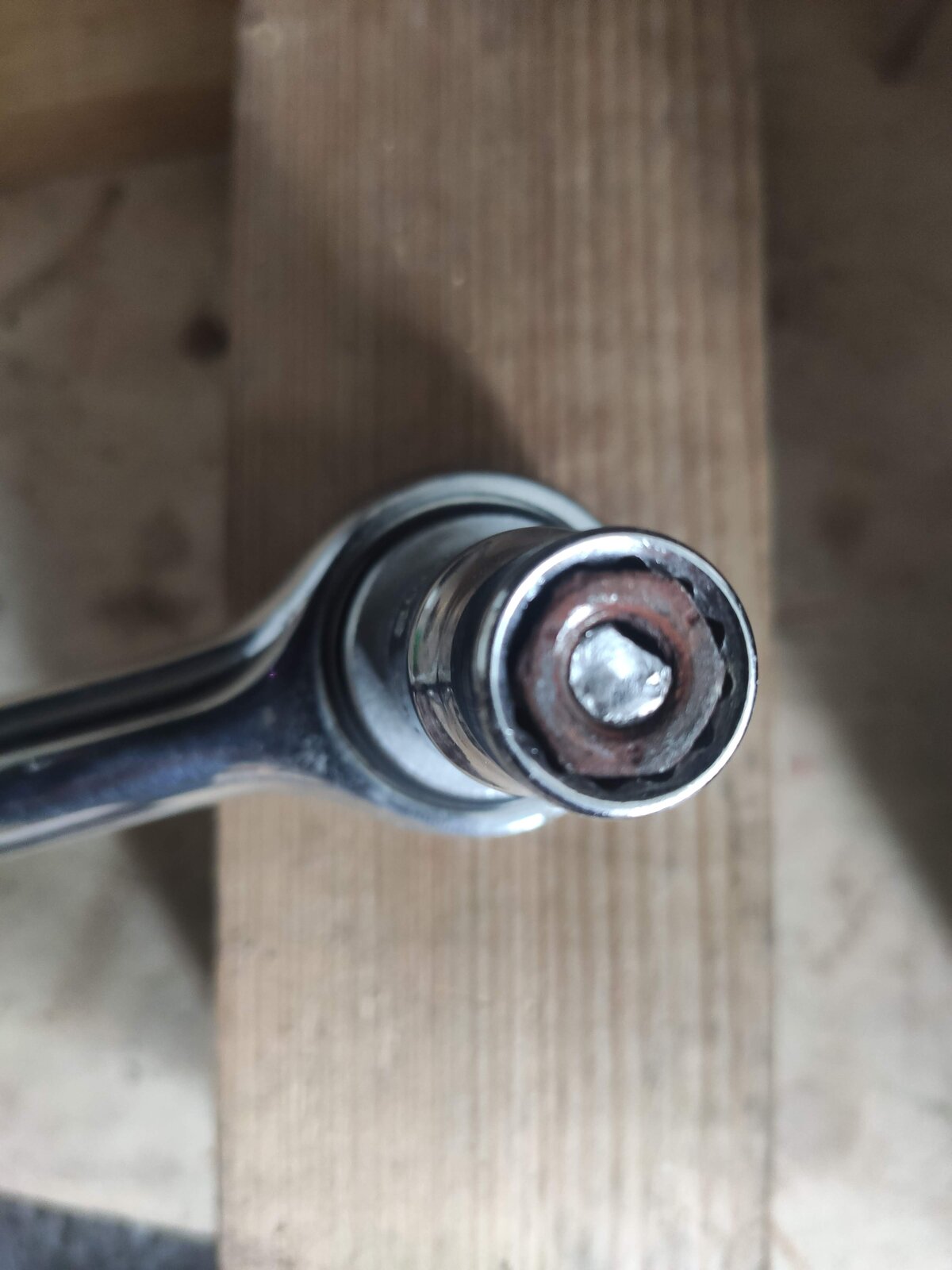

I never said that I've not got a spanner or a ratchet set, haha. What I said was that I was a bit apprehensive in trying to open it and it looks like my fears have turned out to be true. I've used a ratchet set to prise open the nut and the bolt/nut has now snapped. The nut is stuck in the ratchet socket and the handle is now stuck, missing a nut. Any suggestions on how to resolve this?
As for the plate being flat - I'm not too sure about that because it seems to have a natural curve which I believe helps press the door to close tighter as the handle is turned. But maybe I could be wrong.

To shift the stuck nut in the socket, support the socket on a vice jaw or similar and you'll be able to drift the broken piece out.

Just need a pair of pliers on the plate to wriggle it off, the photos of the new one all show the plate being flat. Sockets often have a hole in the middle, in which case you can stick something in to drift the nut out, otherwise you should be able to gradually lever the nut out of the socket by using a tiny screwdriver or similar.
Zooming in on that photo I'd say your socket is a tad too big for the nut, hence it's now jammed in. But the above posts still stand.

I tried the 12mm socket which was too small and 13mm is the next size which fitted.
