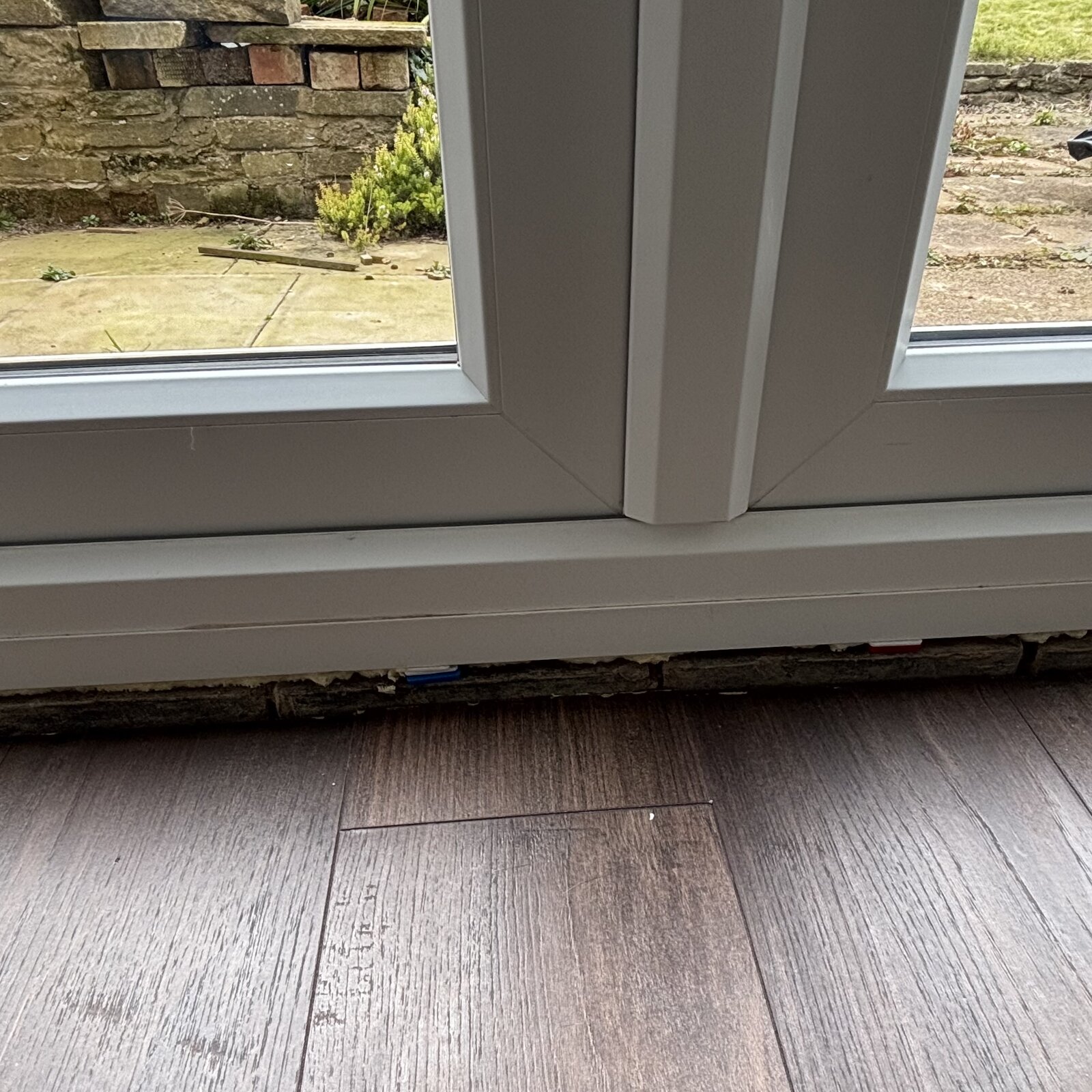

Hi
I’ve had external upvc french doors installed and installed my flooring. I was wondering what I should use to finish covering the exposed brickwork (see photo)? I was thinking of putting a step in or is there some kind of fascia (terminology might not be correct)

That outer course of bricks should have been removed and the French set made bigger (taller) to suit. Surely this was spotted during the measuring process?
Some thin PVCU trim (pencil round architrave, possibly), glued onto brick and overlapping the white frame.
Puraflex adhesive will stick it to brick/plastic.
