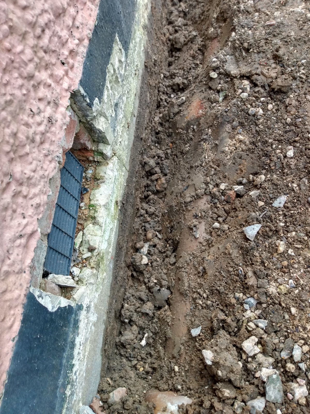

Ok, so today I removed the concrete path that ran alongside my house - it was level with airbricks, and covered some completely.

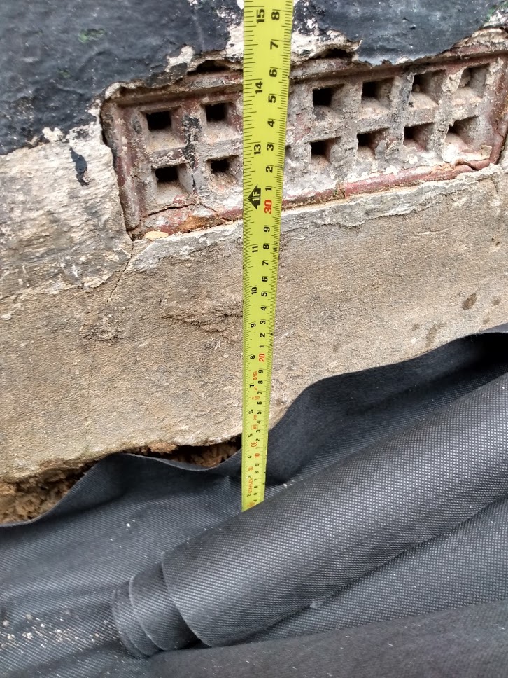

The airbricks have 3 courses below them before the concrete floor. Should I take soil down to this level?

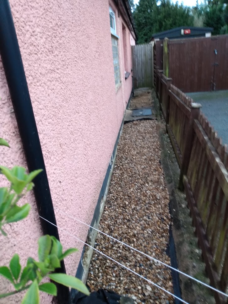

My plan is to put weed barrier membrane down and cover with gravel. If I can get away with just having a trench by the wall and leaving the rest higher, that would be good.
This dried out after the photo - depth of trench I think I'll do ... :

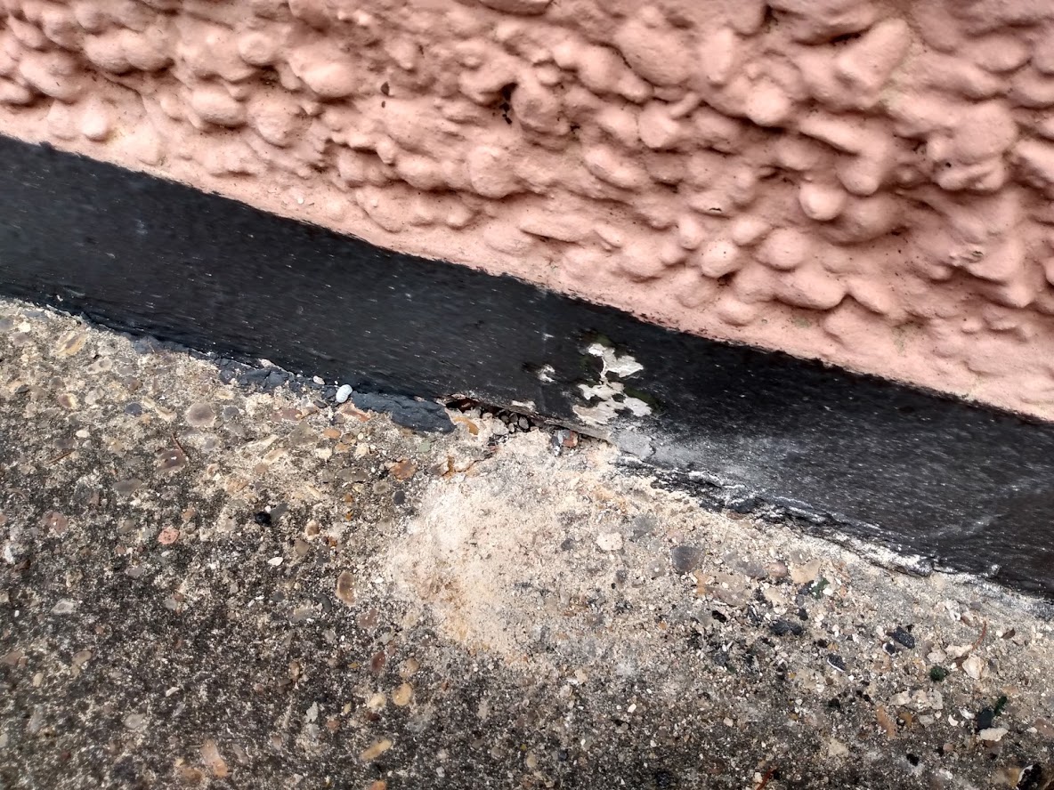

Can see airbrick and floor here - damp line dried out after lowering the soil outside
How it was - top of air brick just visible.

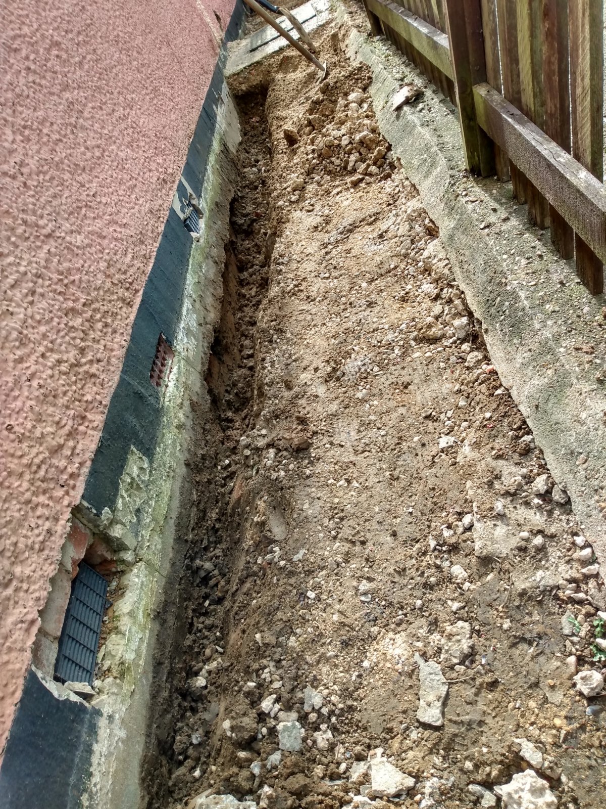

How it is today - concrete removed, some hardcore then soil:
The drainpipe runs along the side of the house, so can only remove so much.
ended up going down about 4 courses. Scraped the wet clay mud off the bricks too.
