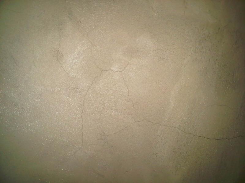

I'm belatedly seeking help with applying lime putty which I've been using for patching on old lime-rendered walls (tenement flat in Scotland) but have not managed to avoid cracking in the finish.
The latest attempt is a fire opening which I'm getting ready to have a stove fitted. A first coat, with hair, went on and dried fine but the finish coat is showing cracks as in the pic. I'm using pre-mixed bagged 'rendering stuff'.
I thought I had it sussed when I realised that you're supposed to keep the putty damp as it dries but some cracks appeared after a couple of days. The wall didn't get it's usual soaking yesterday and lots more cracks are appearing - five days since the finish coat went on.
I did the sides of the opening with hydrolic lime render a couple of days ago (stove was due to be fitted this week - now postponed) and they look fine at the moment but is there any hope for the back wall or will I have to knock it all off?
The stove being fitted is convector sides and back, radiant at the front.

Do you mean you've been spraying it repeatedly AFTER application of the finish coat? This should not be necessary and could be the cause of your problem. You have to prevent it from drying out too rapidly, which is a different thing, by (e.g.) covering with damp hessian if it's really hot. NB The wall has to be dampened before application, not "soaked". You are reducing the suction of the dry wall so that the mortar does not dry too quickly (and it will then fall off).
If it has been dampened regularly, it might still be workable - try tightening the surface with your trowel.
If it has cracked irrepairably and is unworkable, then wait and see if the plaster stays attached. If so, all you have to do is to apply a skim of some lime finish coat over it. OK, if it's loose then it has to come off.

Lime has a tendency to crack after application and needs time to cure. Rapid drying is the problem but this can be caused by many reasons.
Lime that is applied too thick will crack.
Lime that is applied to high suction backgrounds.
Athmospheric conditions.
You can still rub it up weeks after you apply, depending on the mix however.
I would give the wall a real big soaking, you don't want the lime render to be sucking in any water, then give it a good rub up with a plastic float and keep it damp.
If you have more work to do I would suggest you clean (hoover) the area and soak the wall and I mean give it a good soak! If you have a deep patch to do build it up with scratch coats about 8/10mm thick. If it takes 3 scratch coat then it needs three. Lime render is not a quick fix so to speak. It takes time, lots of time.

Possel - the scratch coat was well dampened. Water wasn't running off but it may have been dampened too much. I did spray it with water regularly after the finish (fairly fine mist from a 1ltr plant spray).
I can rub it up a bit so the cracks are filled but it doesn't last long before they open and the grit it creating a few 'gouges' - I'm not too worried about those though or the cracks as long as it's sound (have to take a chance as the stove is being fitted next week). I've used a tub of finishing stuff before but had the same problem with that I'm afraid. Is lime finish stuff different?
peaps I don't know what mix the hydrolic stuff is as it came ready-made (dry) but it looks fine at the moment, it's the putty that's cracking.
...If you have a deep patch to do build it up with scratch coats about 8/10mm thick. If it takes 3 scratch coat then it needs three. Lime render is not a quick fix so to speak. It takes time, lots of time.
The bottom of the wall where the putty is at it's thinnest does not have any cracks so I may have it on too thick further up given what you say. Looking like I should have taken more time and given it an extra coat to build it up properly.[/b]

What are you using as "finishing stuff"? For my house I used 3:2 fine sand: lime putty, purchased ready mixed from a well known supplier in Devon. This would give an acceptable finish but we added another coat of their "Regency plaster" which is (I think) 1:1 lime putty: fine sand and marble flour. This gives a really smooth surface if applied properly.
