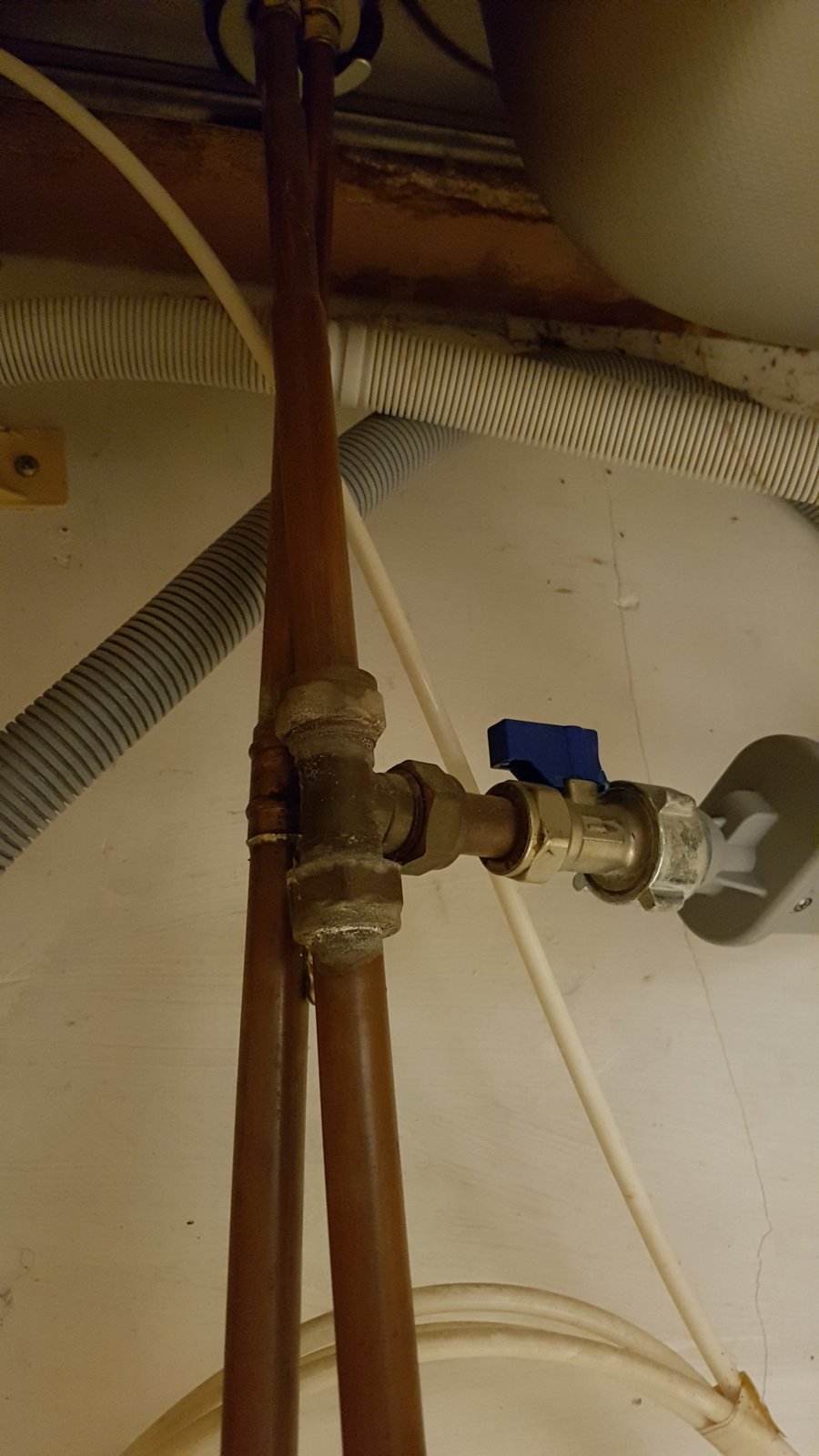

Hi, I'd like to replace my kitchen worktops, sink and tap. I've been watching YouTube videos and all seems simple enough (famous last words!) But I don't know how to turn my hot water off. Neither of my hot or cold pipes have isolation valves. The only thing I can do is turn the water off that's going to the dishwasher. Any ideas?

Hi,
I'm doing something similar in my kitchen. I turned off the boiler, then isolated the incoming water main at the stopcock. Ie I turned off all the water into the house and this valve was in the corner of the kitchen.
I chose to fit 15mm isolating valves on the tap feeds to make it easier should I ever want to replace the tap again. These were cheap ones from screwfix.
Make sure you fit them so they are high enough to take the new tap flexi hose to the tap.

Ah Graeme, well done on your triumph so far. Well there is a large valve near the boiler to turn off the mains water so maybe I'll look around the boiler to see if I can turn the hot water off from there and turn the kitchen tap on to drain the water between the valve and the tap that way. Great south with regards to keeping the valve high for the new taps Flexi hose.

Hi,
If it's a combi boiler like mine, it will turn off with the stopcock. It's not getting any feed water so it will stop. If it's hot water in a tank it might be a bit more involved I guess.
