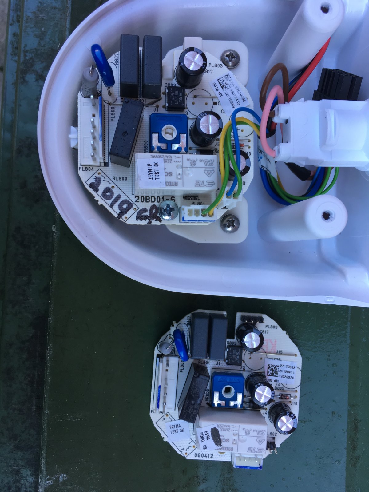

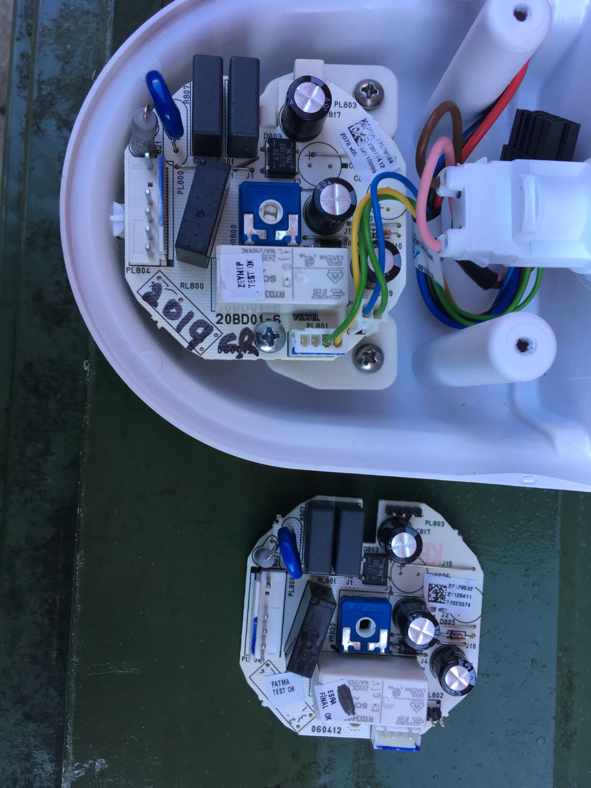

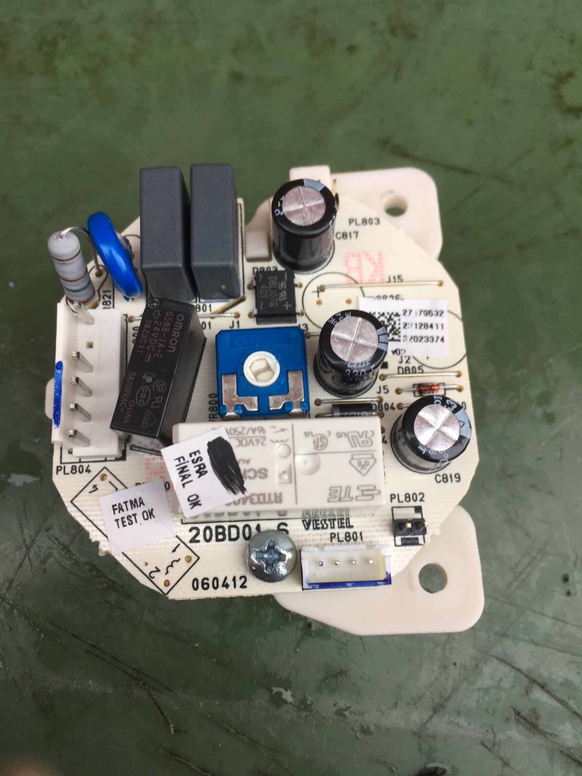

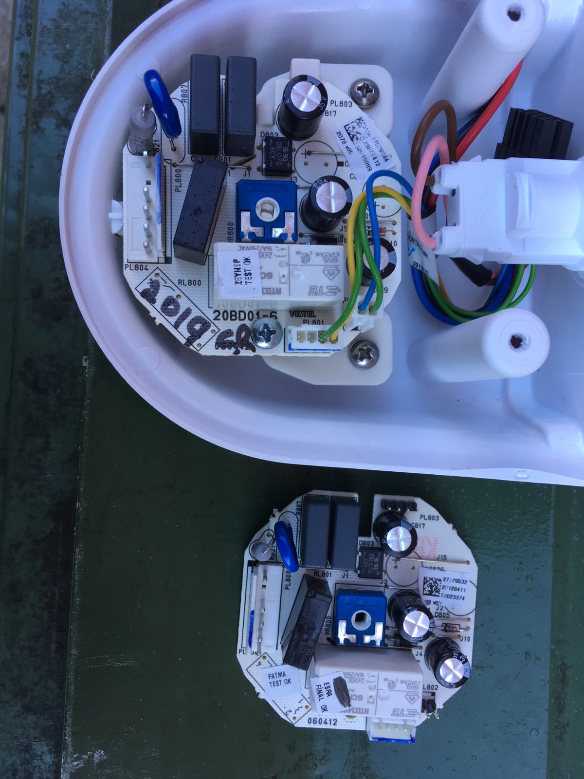

I have replaced the electronic thermostat, cost £40, see photo, and an easy job to do (20 mins) once you find the part (search for "20BD01-6") and no change.

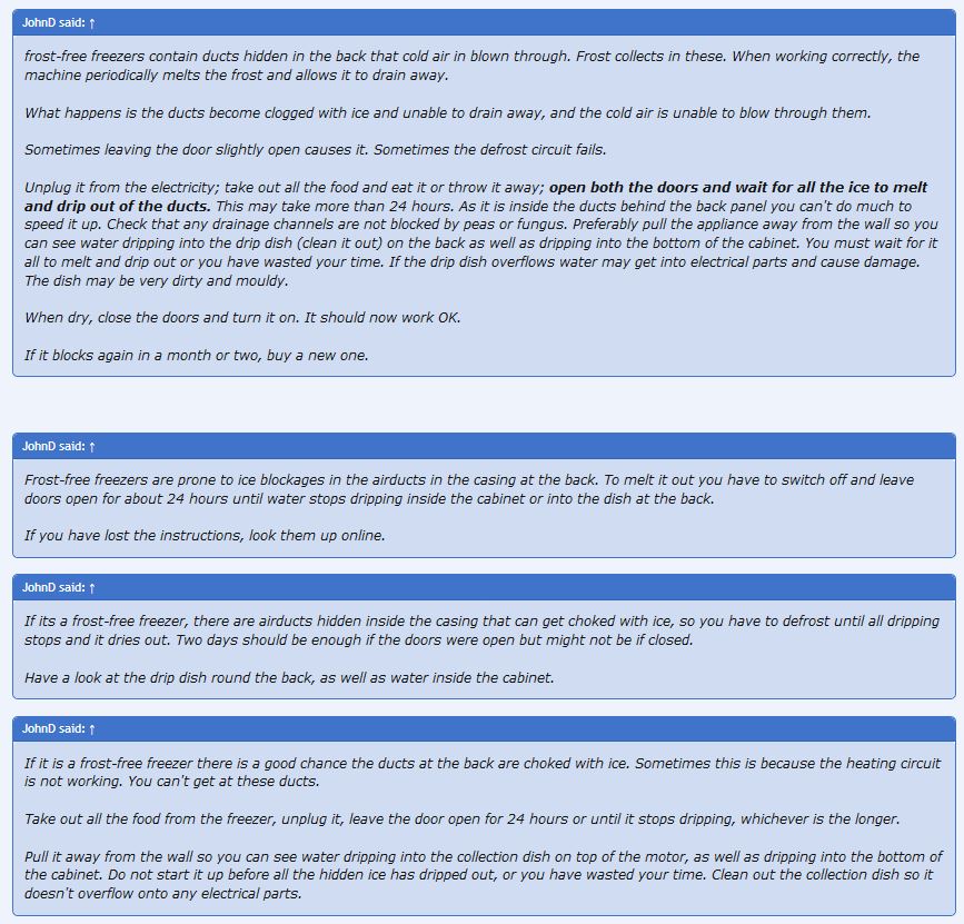

is it a frost-free freezer, and does it have ducts/vents in the back wall for cold air to blow between the two chambers?
have you got a thermometer? What are the temperatures in the fridge and the freezer section?
if the ducts are choked with ice, it takes a lot longer than "a bit" for the blockage to melt and drip out.

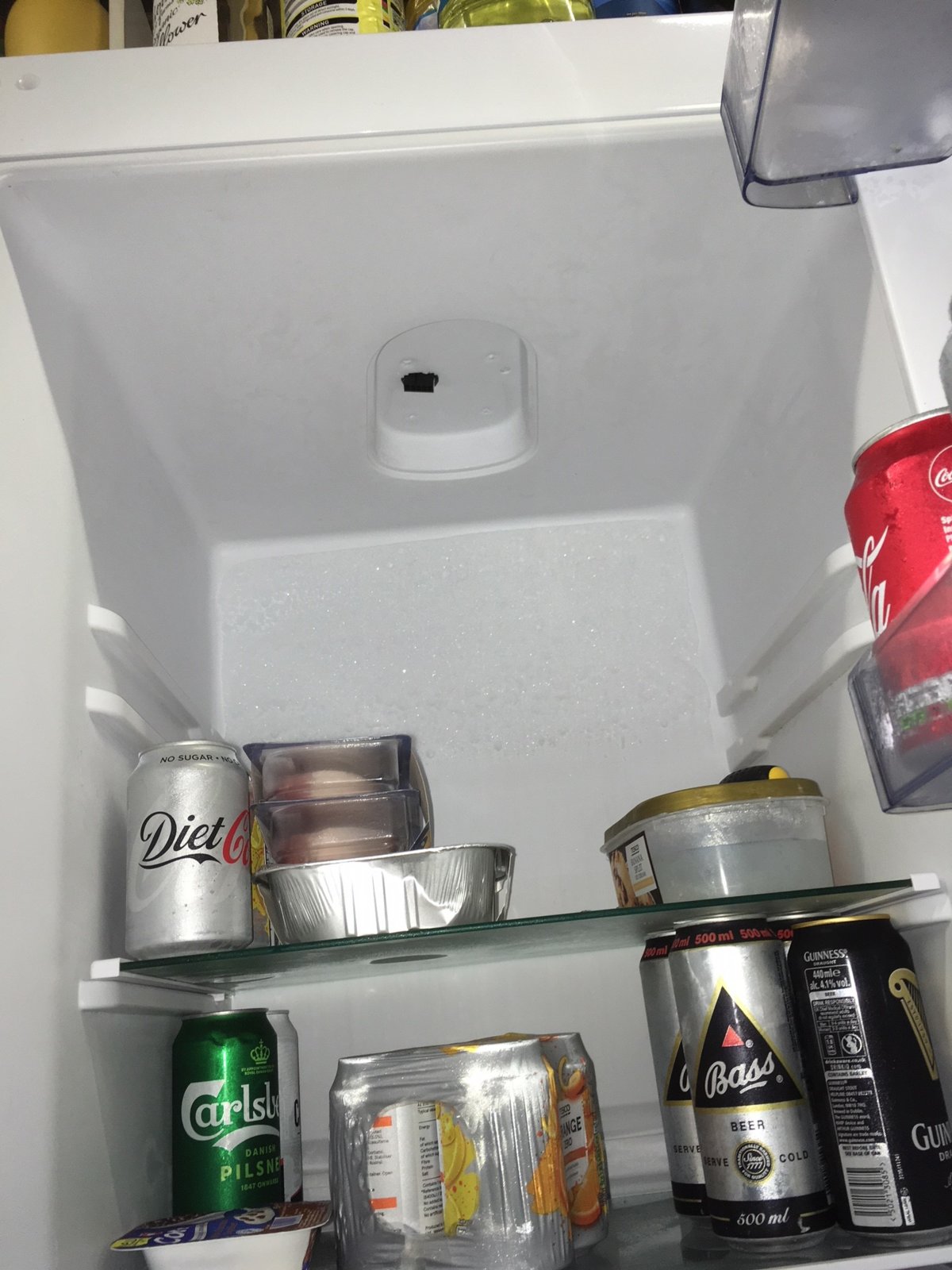

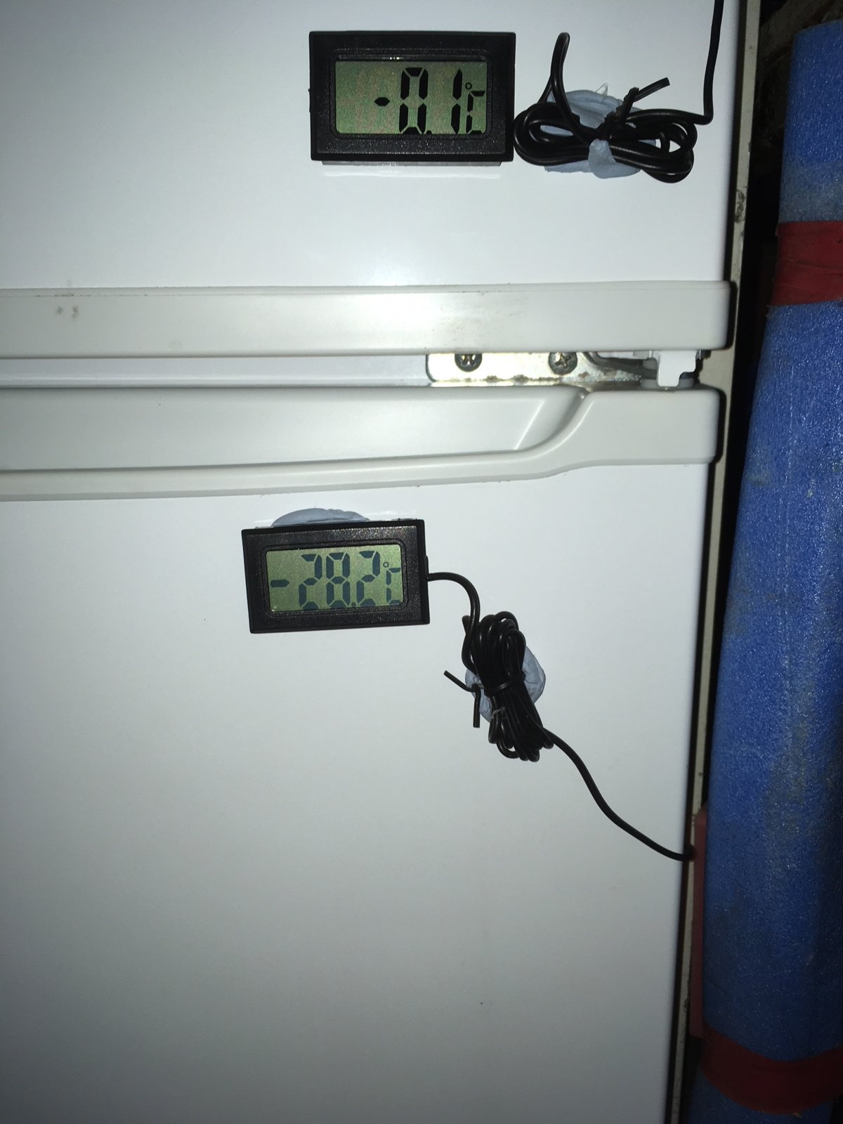

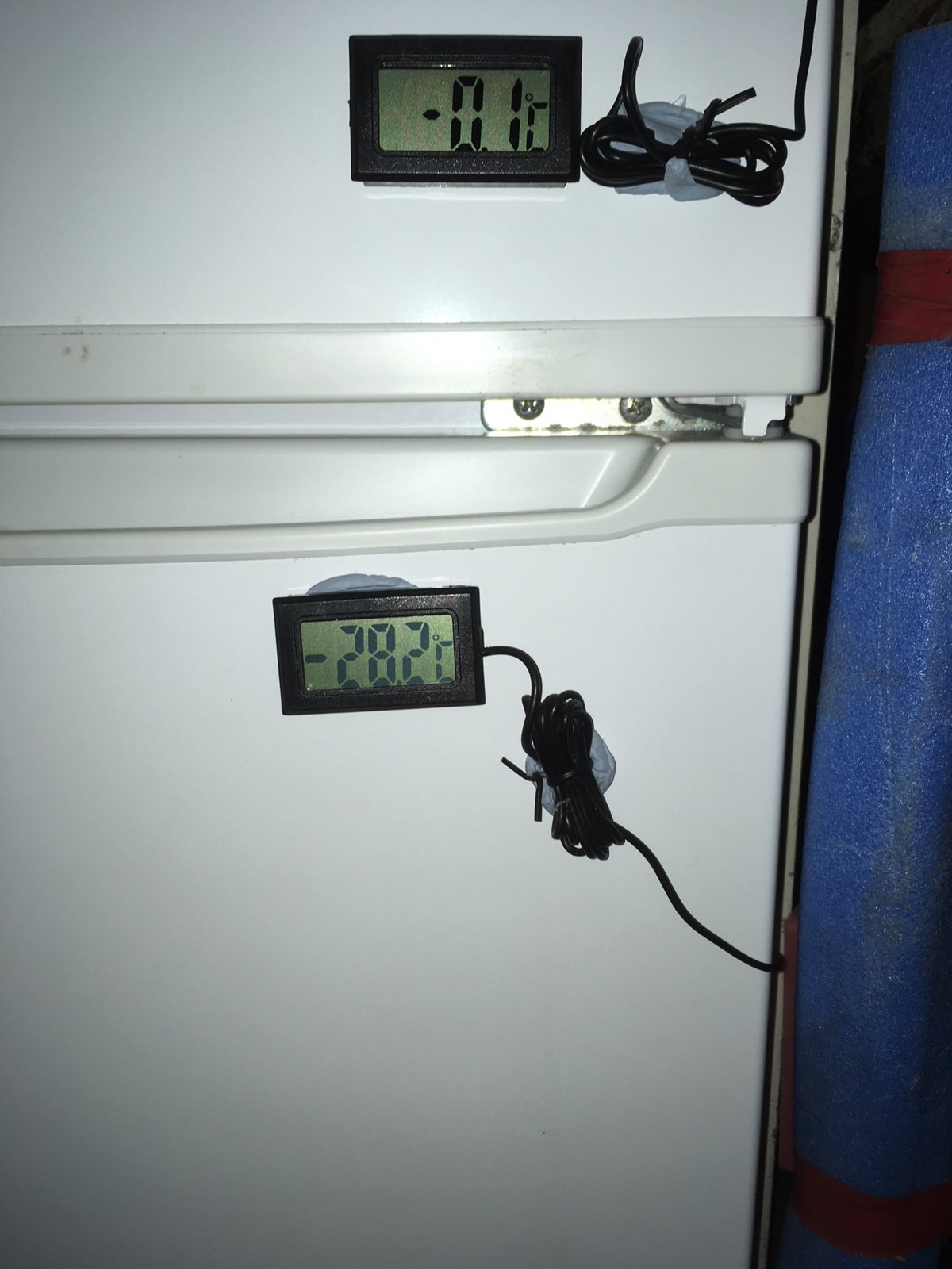

I got some temp meters, and set them up. I also put an ice-cream box of water on middle shelf, near back of fridge.
Next day, the water was solid, and the firdge temp was -0.2C, with the freezer at -28.2C. See images (top meter is fridge).
That is very cold for the freezer too.
The thermostat was set at "1", the warmest, so we tried it at "5" (coldest) for another day, but no difference.

Ive already tried a new thermostat circuit board. No difference.
So, Im wondering, is there possibly a faulty temp sensor which feeds into the circuit board?
PL802 looks like it migth be some sort of sensor input.
Any ideas if that be replaced ?
The fridge/freezer is obviously very good at chilling and freezing, so the issue seems to be with temp regulation.

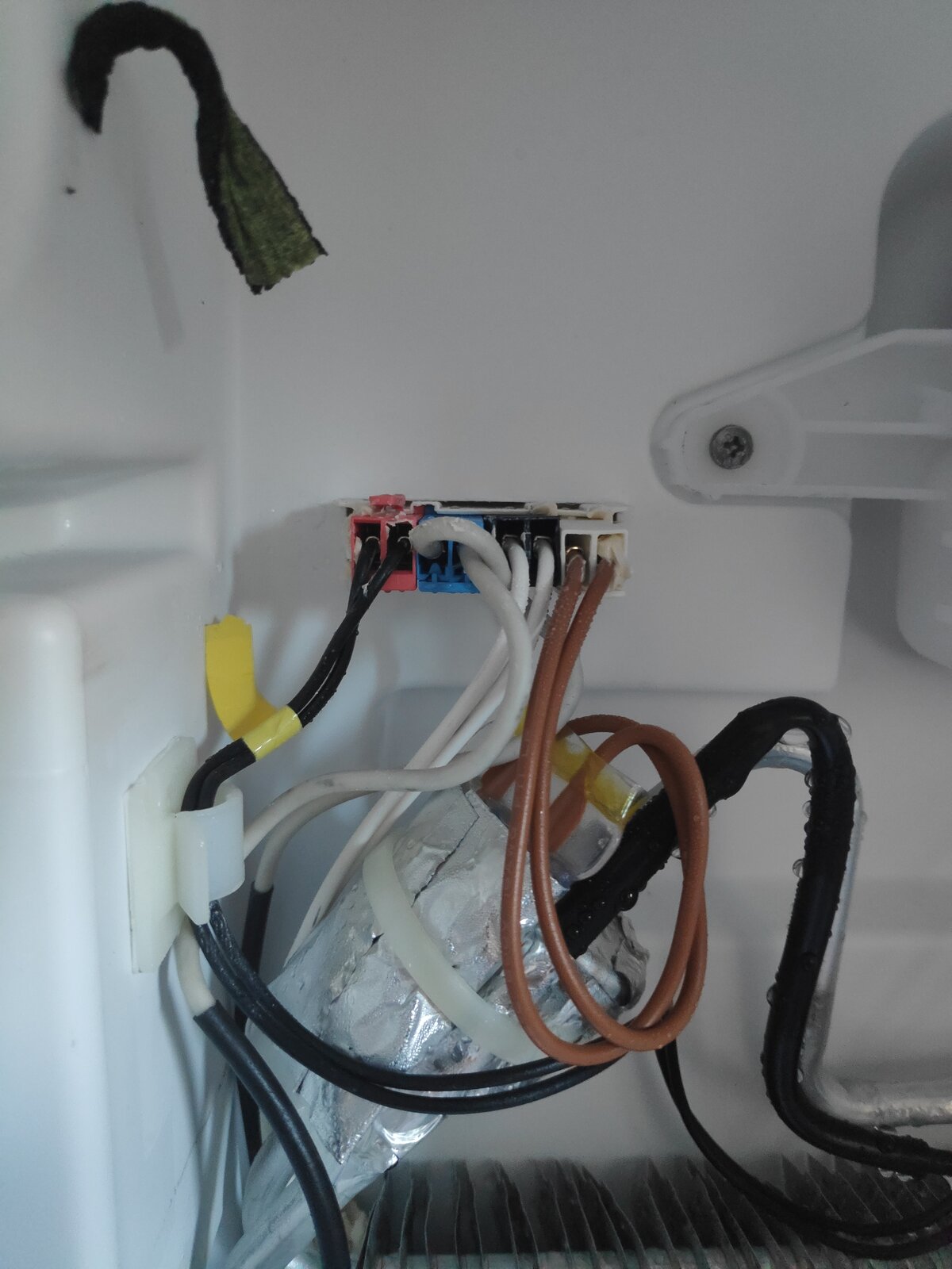

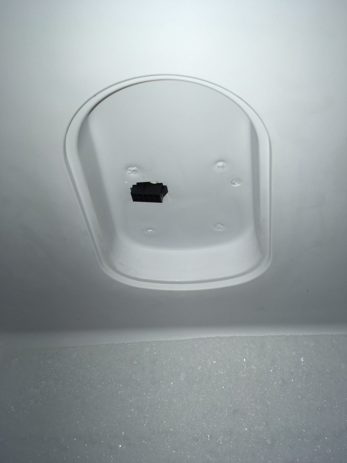

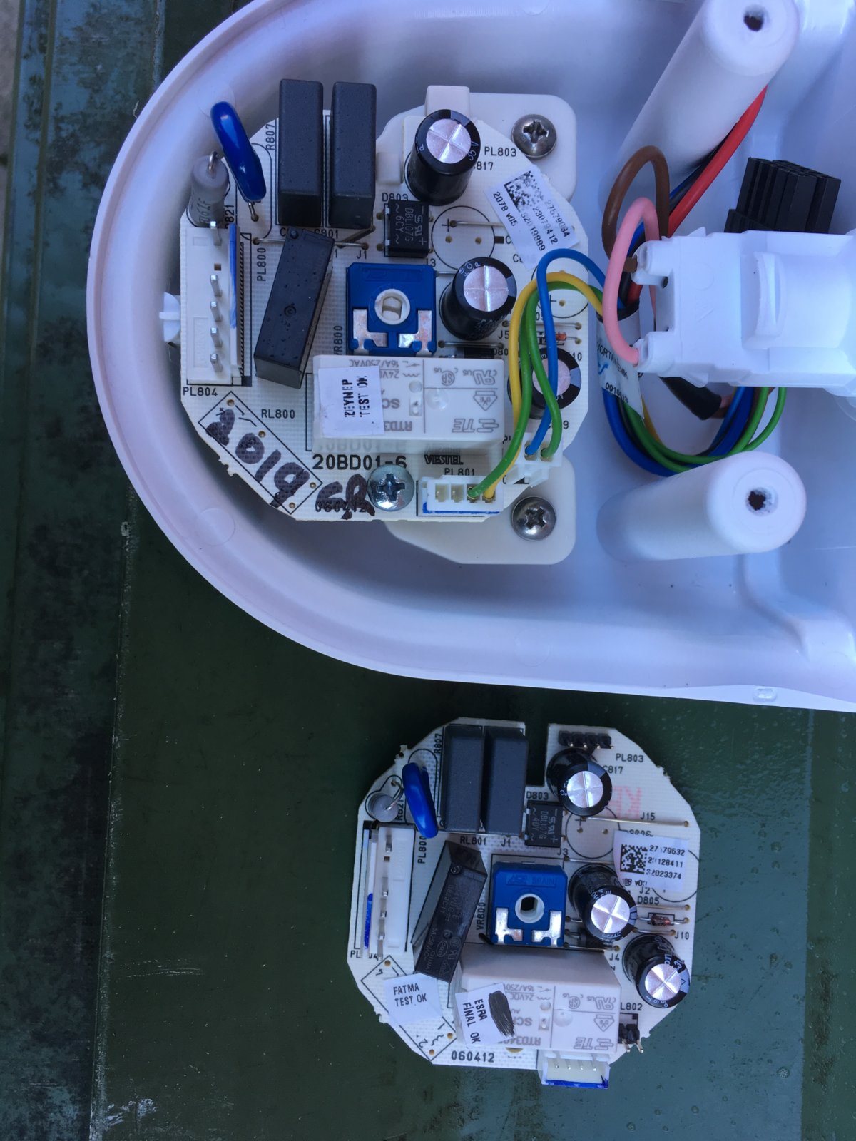

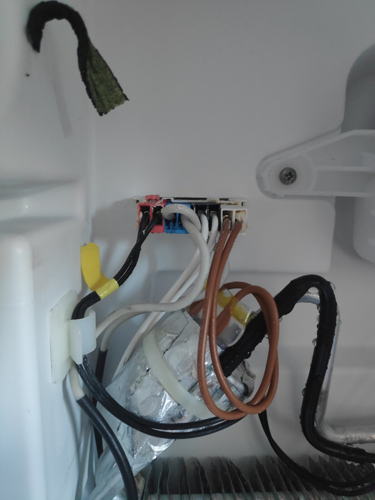

The circuit board is fitted inside the centre top of the fridge, with a multipin connector to cables disappearing into the void above. This connector then fans out to three connections on the ciruit board.
Here is picture of the board fitted to its housing, showing the wires to the multipin connector.
Cheers, Colin.

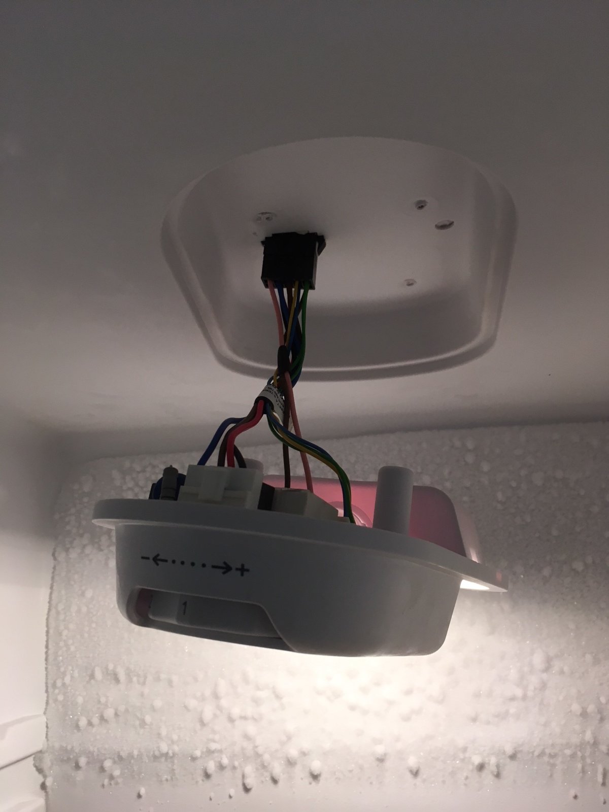

Hi,

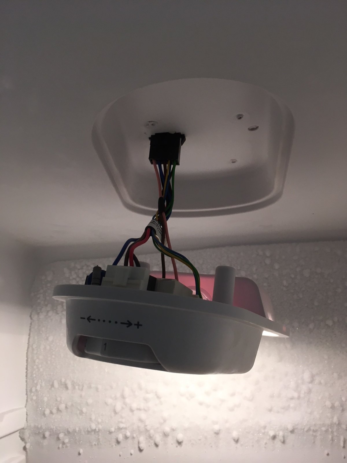

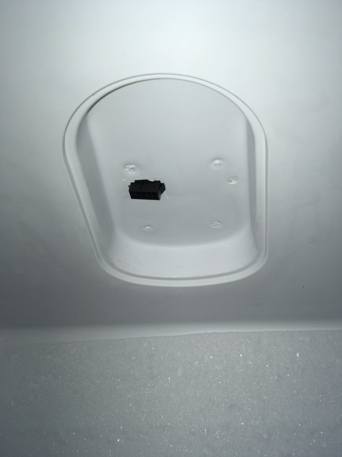

So, anyone know how to open up the top of a fridge to get to behind the wiring ?
There is no sign of any screws.
Here are some pictures of insde.
Fridge Top.jpg Fridge Controller.jpg Fridge Connections.jpg Fridge Top Connections.jpg
There's a YouTube video that shows you how to replace the sensor. Apparently it's buried in the wall of the fridge, halfway down the left hand side. Unfortunately this means cutting it out and then replacing it then sealing it all back up with foam or other insulation material.

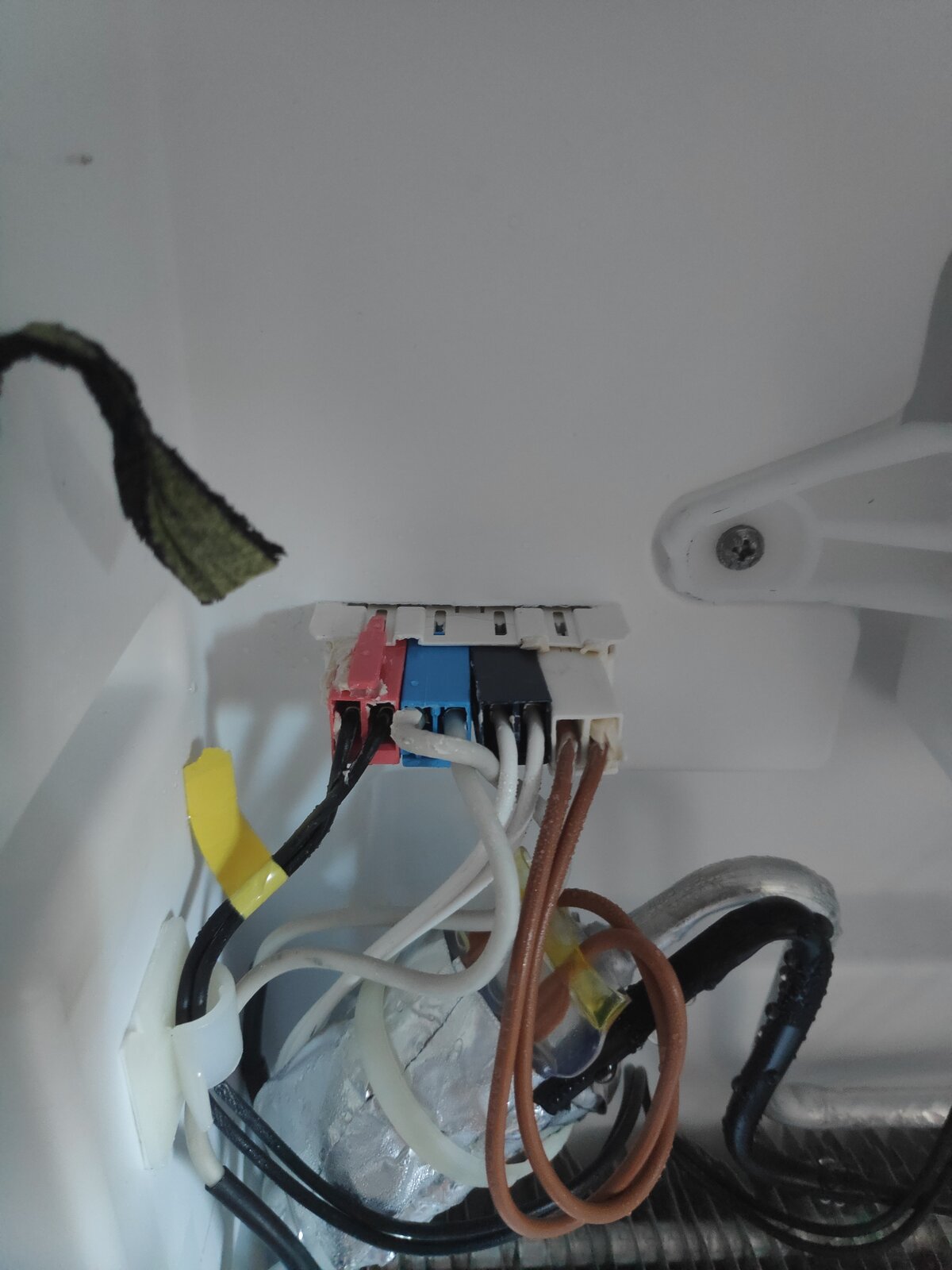

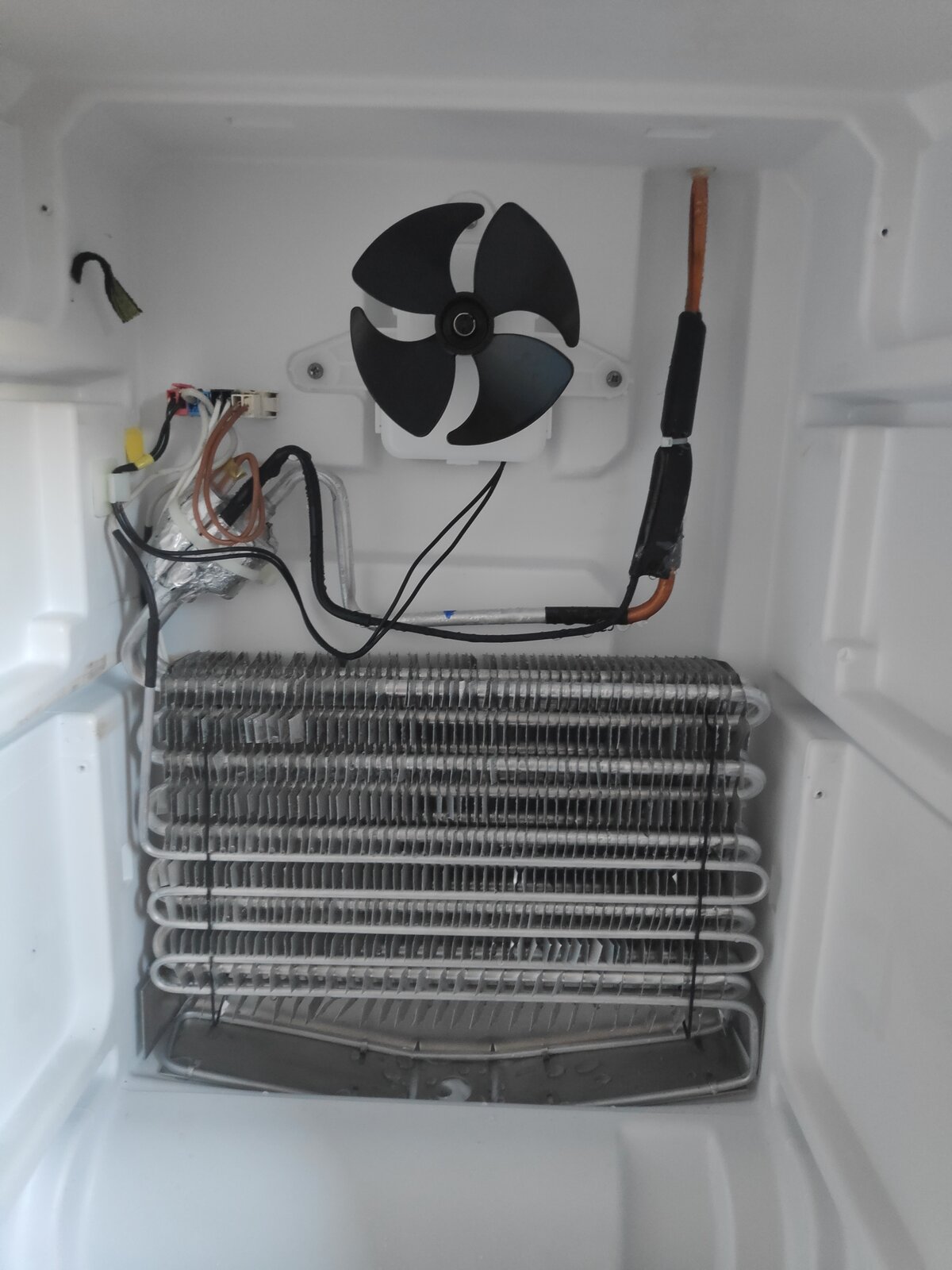

In terms of trying the fix the issue, I did purchase the thermistor mentioned above, but struggled to find its location.
I was advised that it could be in the back of the freezer section. I was able to get in there and find a thermistor.
It had a different connector type. I removed it and it seemed to be faulty, an open circuit, infinite resistance.
In testing with a multi-meter I was able to identify the wiring pins on the control circuit board. This helped identify a second thermistor circuit input on the control board. I suspect the 2nd being from within the fridge. The latter seemed to behave correctly, with a resistance of around 5Kohms, increasing with temperature of the fridge.
So I replaced the freezer thermistor, and checked all connections etc again.
I was being optimistic ! But there was no change in the behaviour of the fridge section.
It would go down to about -27C, with the fridge going to -6C. So maybe it was my control board faulty, but at £40 I wasn't prepared to try another one.
Also, I tried disconnecting both the sensor inputs to the control board, effectively making them infinite resistance.
Under this circumstance, the freezer sits at -18C, with the fridge at -2C.

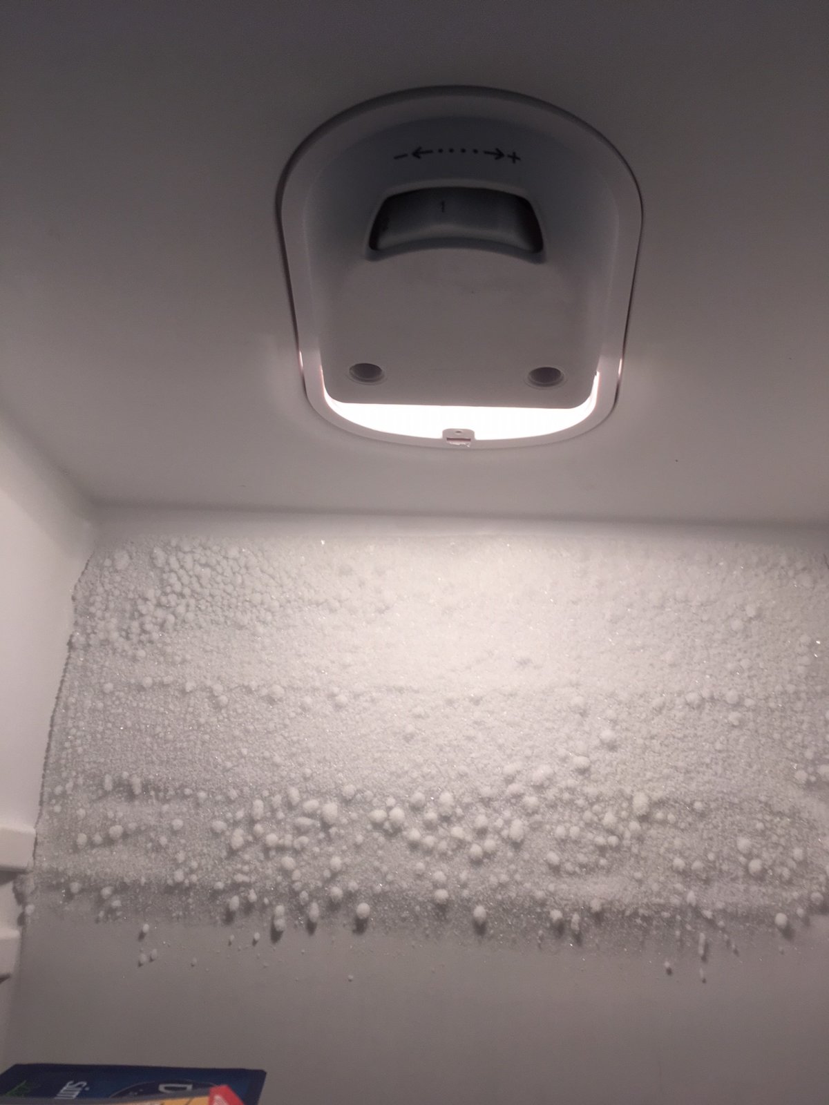

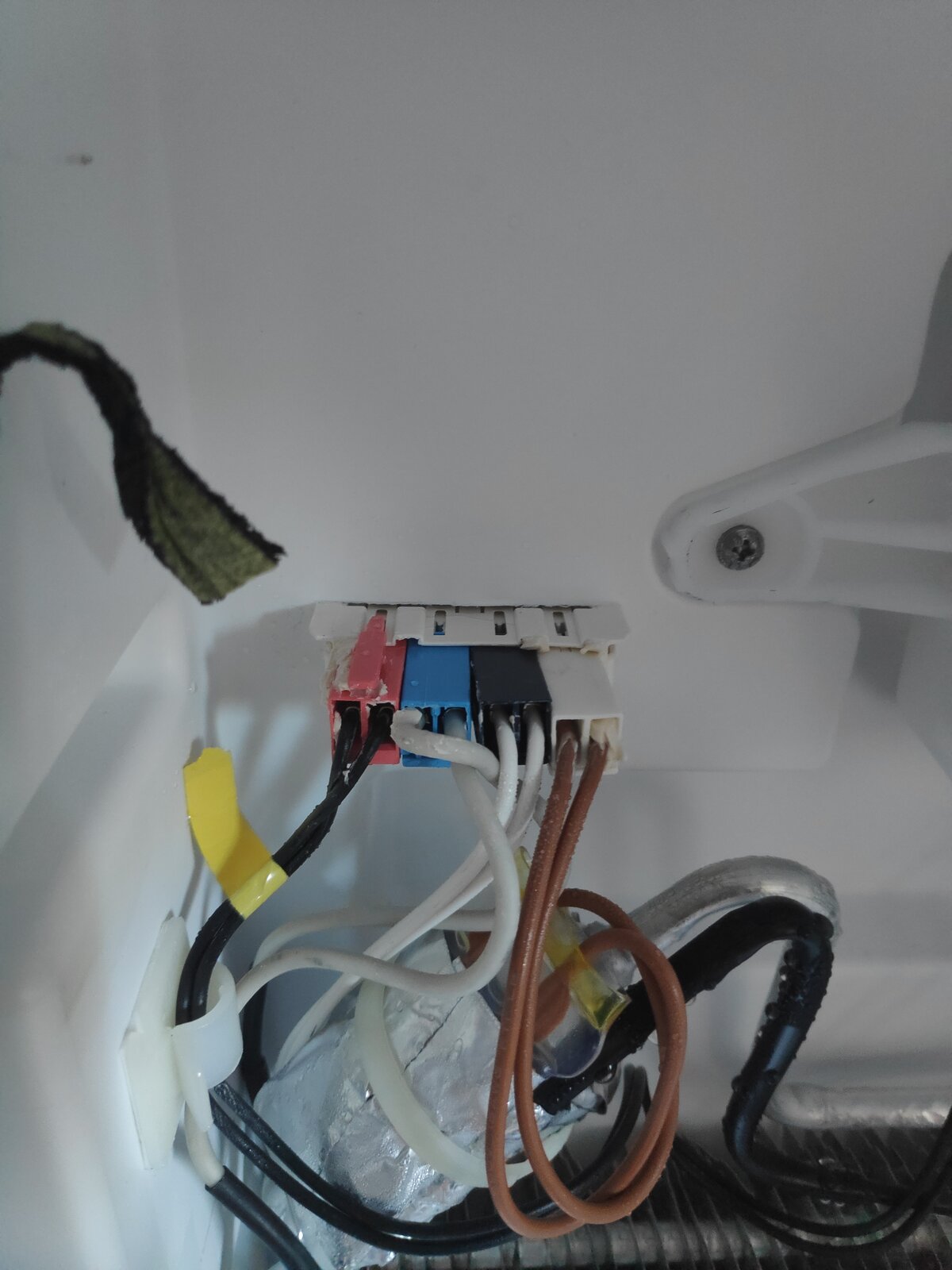

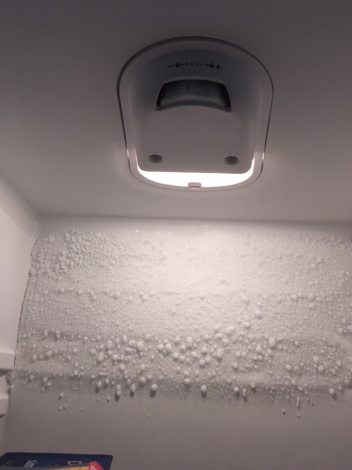

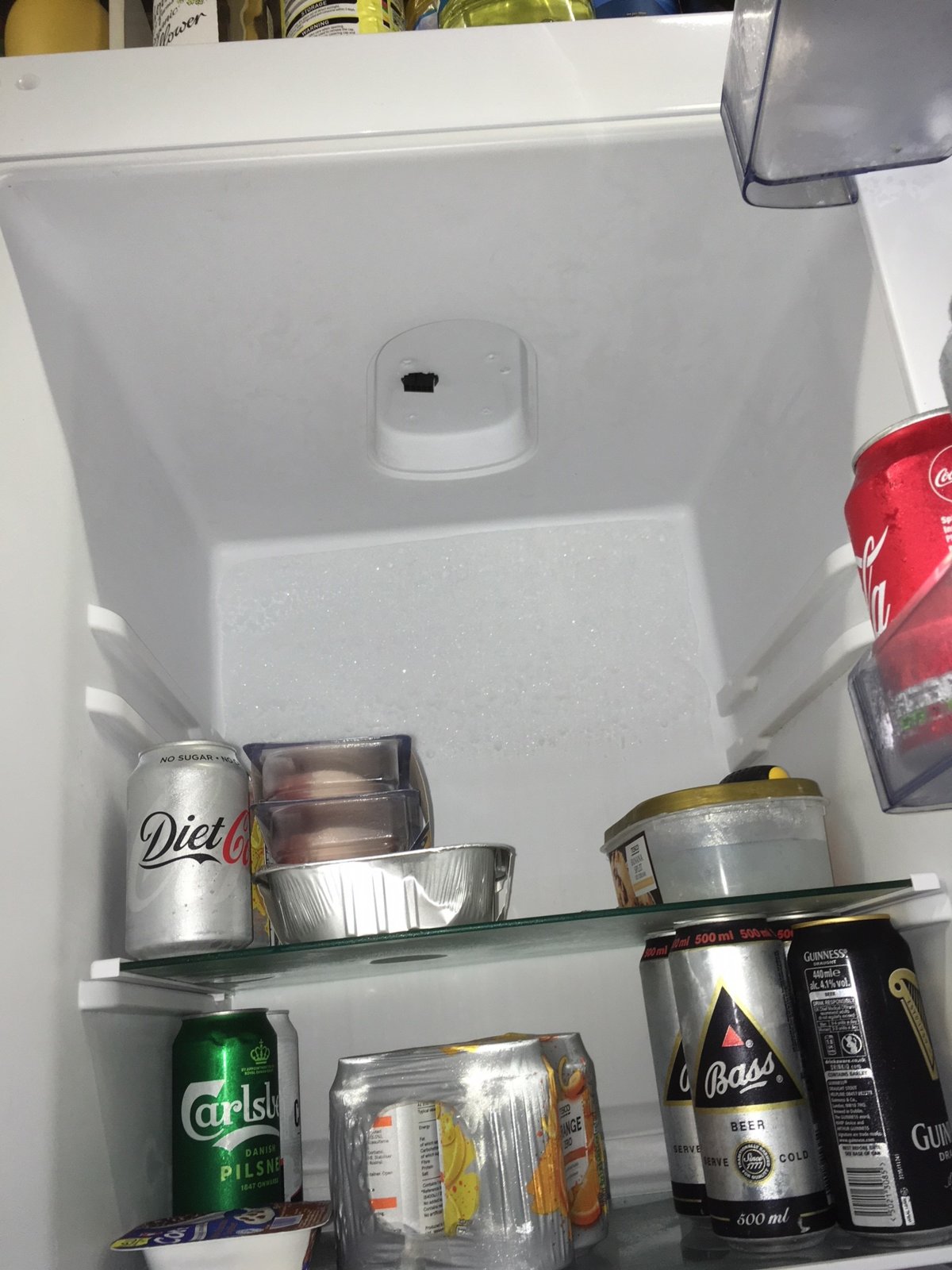

I have an Electra fridge-freezer with the same type of electronic thermostat, and the same symptom - fridge compartment temperature below freezing even with the thermostat dial turned down to 1. I've just tried the solution suggested above - empty it, let it defrost completely, and make sure there's nothing blocking any inlets/outlets. Being an engineer (and therefore convinced that I should be able to fix just about _anything_!) I went a step further and removed the panel at the back of the freezer compartment. In case it's of any interest/use to others, attached are a couple of photos of what lies behind it.
I unplugged and replugged each of the connectors, and poked a wire down the hole at the bottom of the radiator element thingy. Jury still out on whether that's made it work any better...
Rather than scrapping, and if part are not available, inaccessible to replace then one way to fix a fridge freezer with a single shared compressor, would be to cobble together a couple of thermistors, adjustable comparators and relays. Idea being to have one thermistor in each compartment, with each able to switch on the compressor if they detect being above the set temperature.
And... that seems to have fixed it! The connectors were surprisingly easy to unplug, so might have been just some oxidisation of a contact pin.
